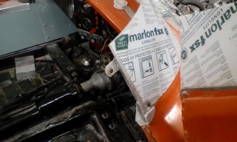

BIT MORE ACHIEVED THIS WEEK .... Radiator finished off and 2 x fans fitted to the front ...
Fans are attached to the steel frame at the top and a steel strip at the bottom ...

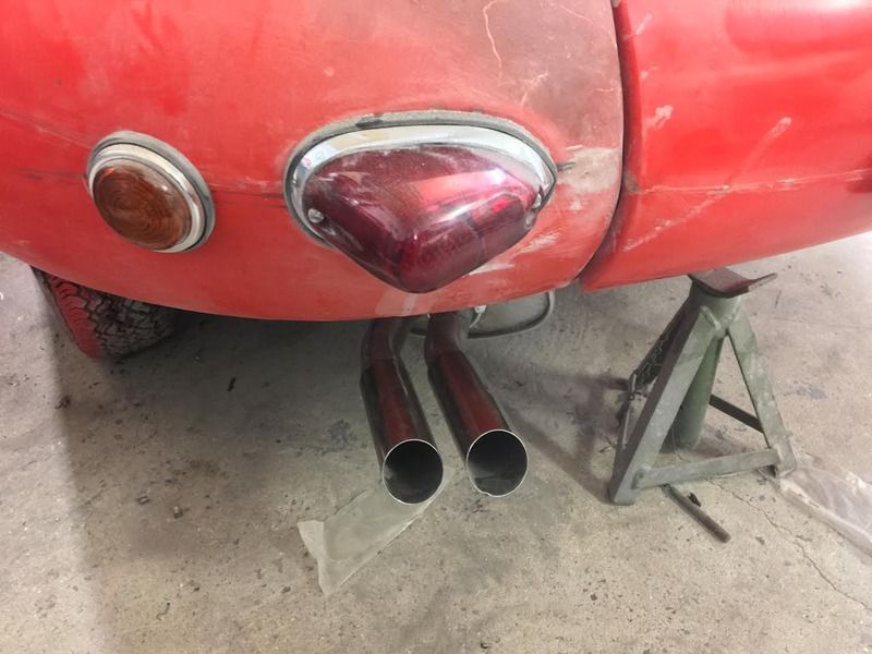

I have also made an exhaust system using new 2'' tube and some pre-formed bends , joiners and a Golf rear silencer with twin tailpipes ...
8th November 2016, 13:28
Managed to convert the heater controls to an electric switch and 2 x choke cables to replace the slide controls and fitted it to a bracket in the centre of a very busy dash !!
Also got the screen fitted , I made some short posts to support the ends and give the side screens something to rest against ...they need a bit of fettling , finger of filler etc.. but are on the car ..
