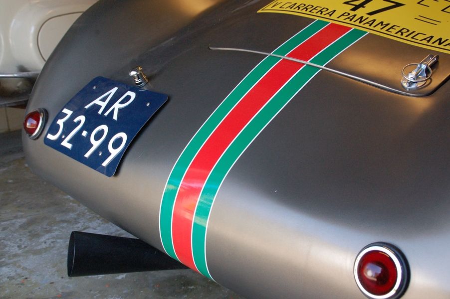

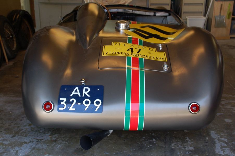

Slowly, very slowly we're getting there. Here are some photo's of the rear that is quite finished now. As you can see, I went another way with the layout.

Very nice Michiel, love the 'Panamerica stickers.

Michiel,
that looks just fantastic - Like the color and centerstripe Great little lights - do they have three functions or will you place more?

That's one COOL looking car Michiel, the attention to detail of the exterior matches the rest of the work you have done, well done you must be proud.
Looking forward to seeing some out door shots, maybe a video.

Posts: 159
Originally Posted by Mars'69 View Post
Michiel,
Maybe you could say that these single rear lights, have even 4 functions in one. This is because I made a reflector in them as well. So it is, rear lightning, brake lights, turn signals and reflector.
Michiel

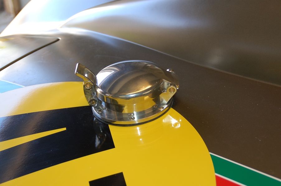

Really, really nice matey!!
Out of interest what is the petrol filler you went with?
  #173
Old 26th May 2014, 00:56
Posts: 159
Hi Dave,
I got it from the US (Speedway motors). Maybe they use them for Cobra's or something. It's a convenient, 1 piece part. The flange and the hose connection (same size as tube of the fuel tank) are an integral part.
Michiel

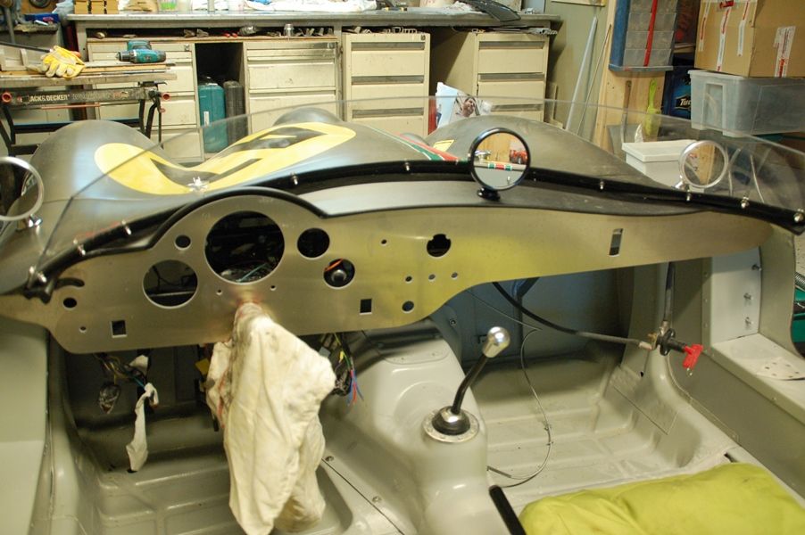

I will add pictures as soon as I have made intresting progress to show for. It was allways my intention to report only the stuff that hasn't been on the forum and not so much a build thread. I'm trying to get the dash panel sorted out at the moment. I made a dummy out of GRP. I draw the outline of it on paper. I had it digitalized with a large scanner. The I had someone import it in autocad and copy the lines rescaling it correctly. Then I draw the right holes and shapes and sent it to a company nearby. I just got it back from watercutting. I need to get it powdercoated now, with a nice wrinkle effect. I think it will look great once finished with the large tacho I'm planning.

  #177
Old 1st June 2014, 19:19
oxford1360 oxford1360 is online now
Posts: 1,111
Fantastic.
  #178
Old 1st June 2014, 19:42
VERY impressive!!
  #179
Old 1st June 2014, 19:45
phil9 phil9 is offline
Posts: 745
Smile
very good would look great with sw gauge i like it very much top job
  #180
Old 1st June 2014, 20:21
Posts: 4,777
That dash looks great.
