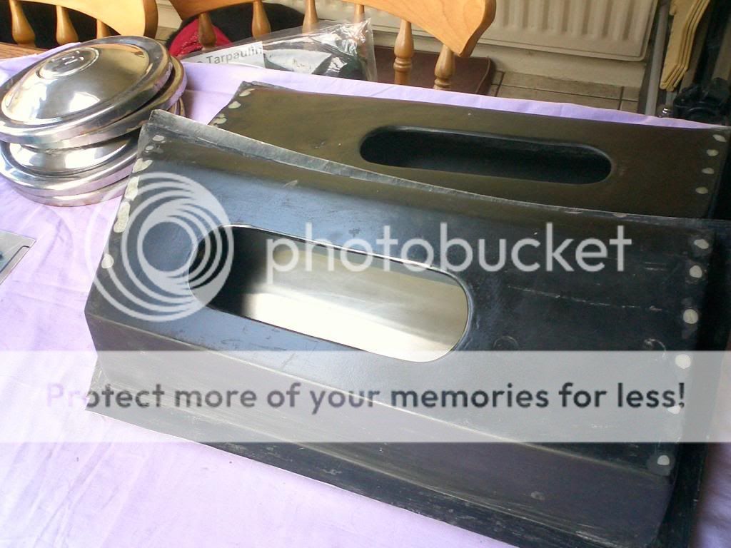

Default Louvres
[IMG][/IMG]
[IMG][/IMG]

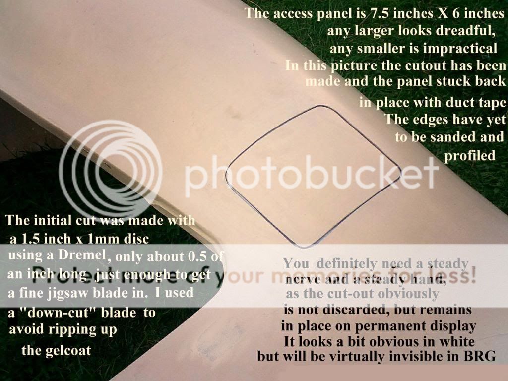

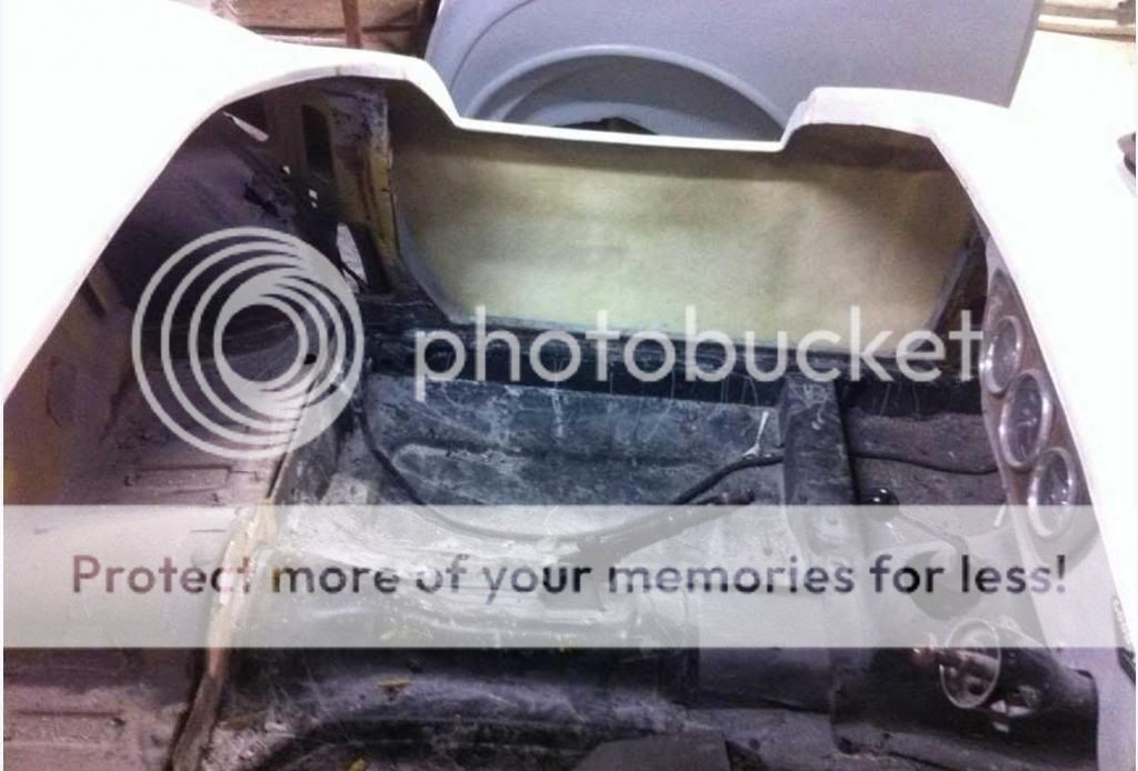

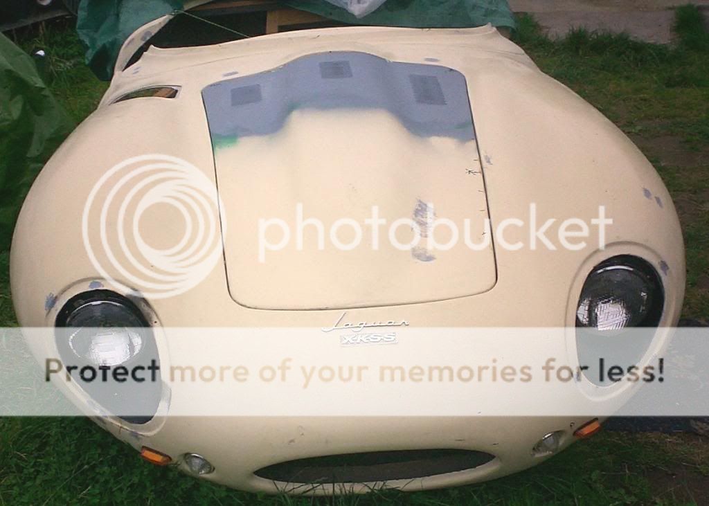

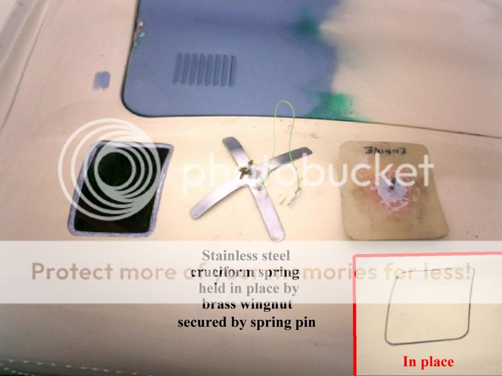

Default Access panel
Because I chose a non flip front, there were certain things under the bonnet that could not be accessed once the body was permanently bonded to the chassis / tub, Or it would be incredibly difficult to carry out repairs to master cylinders windscreen wiper motors etc.
So I decided to make an access panel.
When it came time to actually do the cutting, I was crapping myself as I have always been useless with a jigsaw!
But in the event it turned out not too bad.
[IMG][/IMG]
[IMG][/IMG]

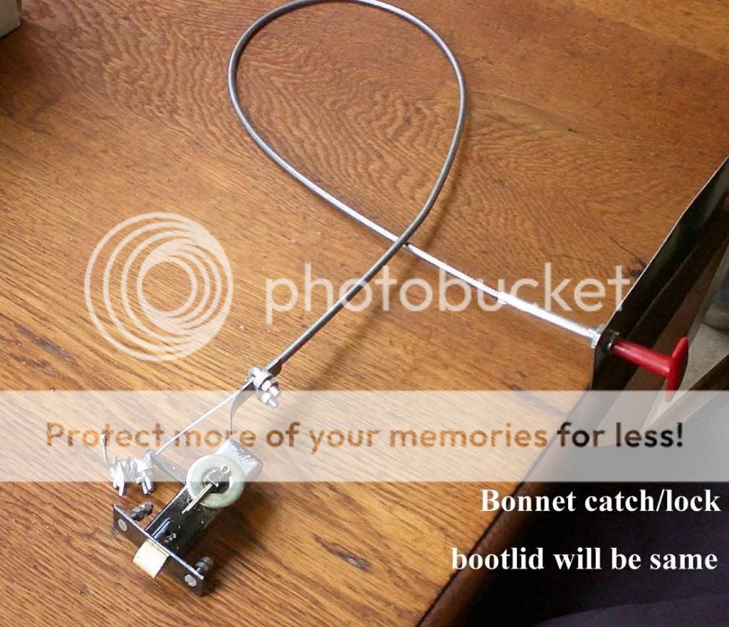

Default bonnet catch / lock
I did not want bonnet straps on my car so went with hidden locks with a T pull handle under the dash.
The bootlid will be done in a similar way, a clean look with no handles straps or other stuff on show.
[IMG][/IMG]

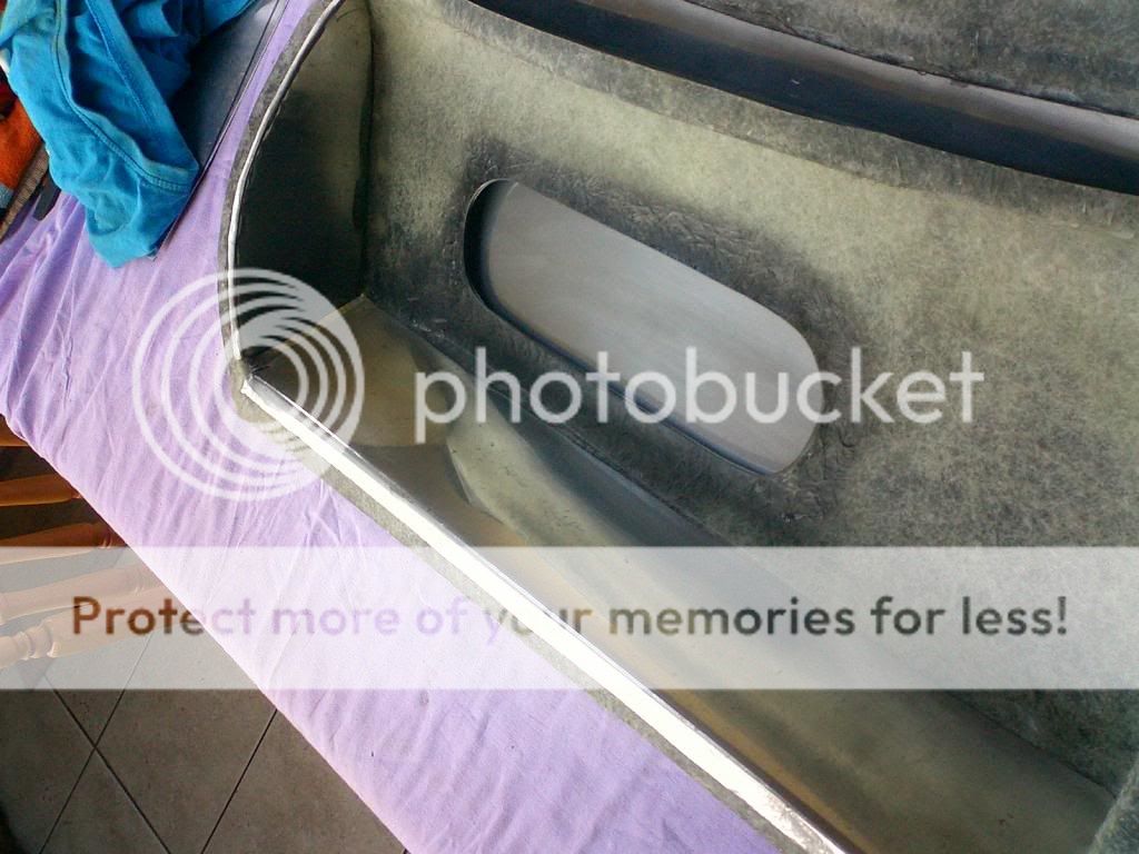

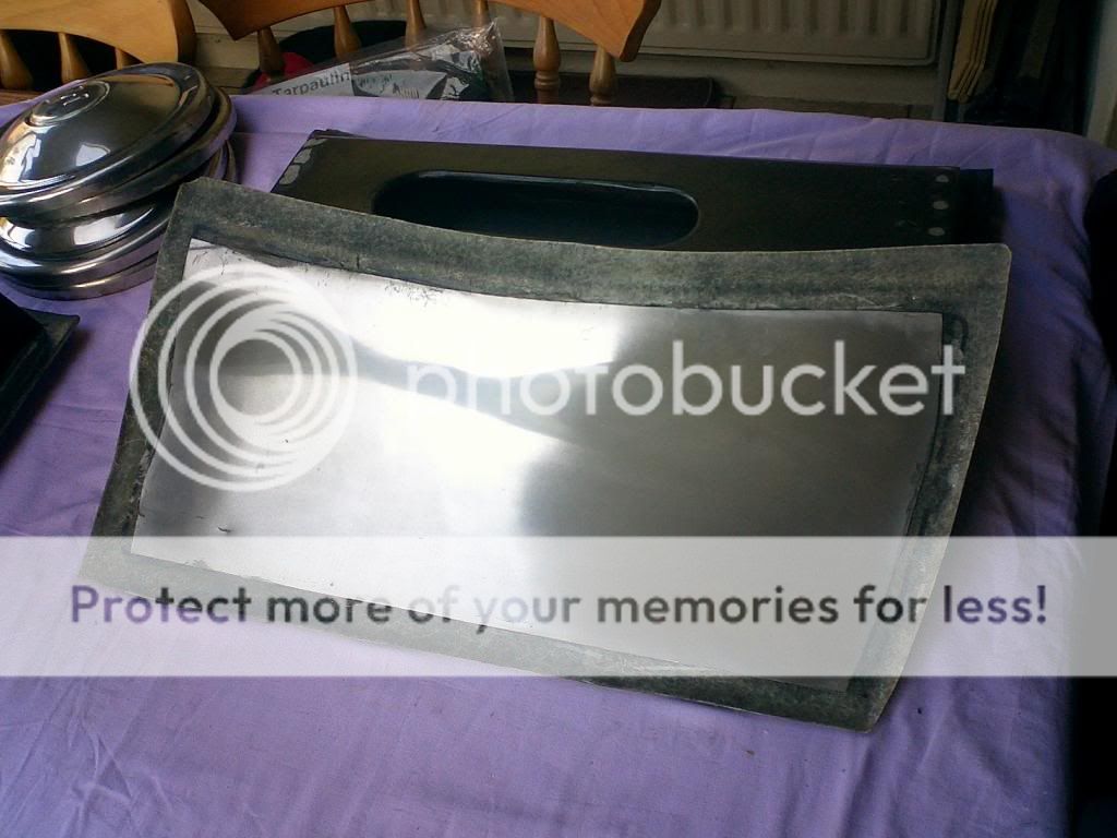

I had a go at the doors next, I wanted the illusion that the car is made from aluminium, so I lined the inside of the door skin with it, and the edges, so that it would be seen if some looked inside the door aperture
[IMG][/IMG]
[IMG][/IMG]
[IMG][/IMG]

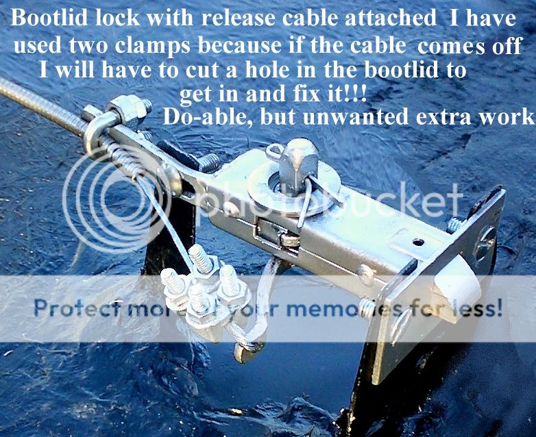

Old 25th October 2013, 22:14

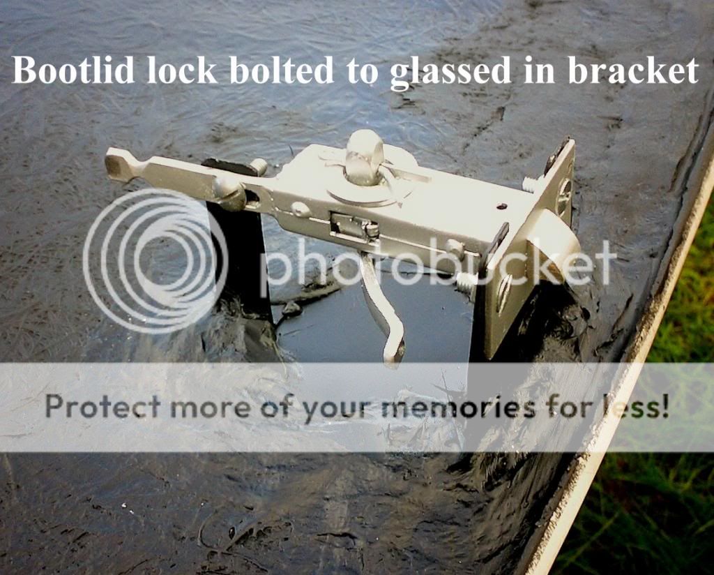

Default Hidden bootlid lock
[IMG][/IMG]
[IMG][/IMG]

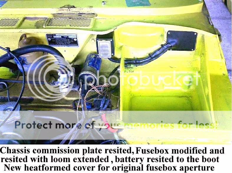

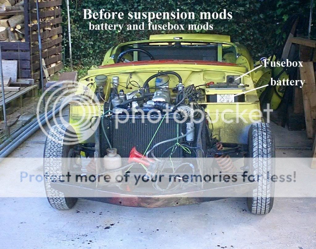

Thanks for the support MT! When I went to collect my body shell from Chris, he took the shell from a Spit it was sat on at the time, and as far as I recall, that car had no brackets, which influenced me as to removal.
The 1 mil cutting disc is my new found friend, and I do get a bit carried away at times, I'll have to dig out a pic of the dash top, where I cut so much out, I panicked and welded in two strengthening bars to compensate! I want my car to have windscreen wipers, and fitting them after the body is in place will be bit tricky and I wanted plenty of access.

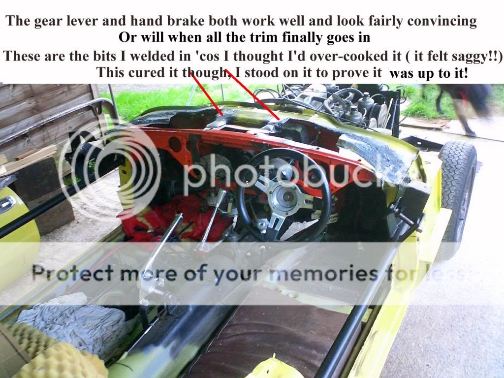

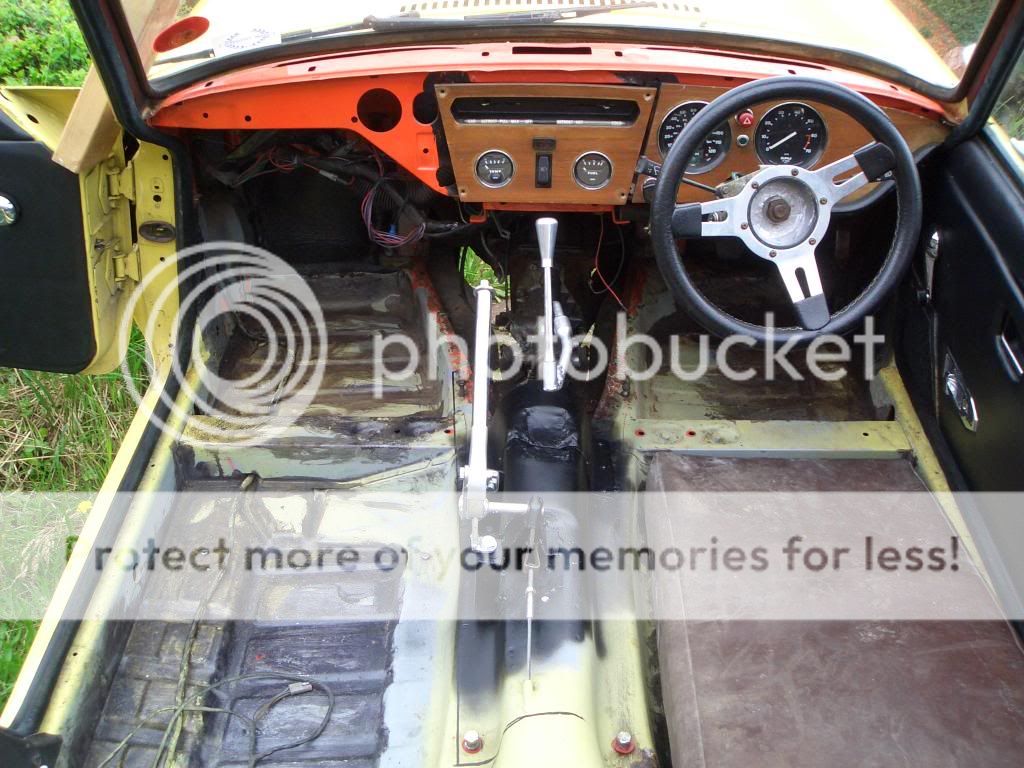

Default Gear lever and hand brake mods
An XKSS interior looks nothing like a Spitfire interior, another big headache. At first I was willing to compromise, then became ashamed of my gutless attitude, and decided to whack it hard!
[IMG][/IMG]
The Spit, for those that don't know, looks like this.
[IMG][/IMG]
I decided to make it look like this
[IMG][/IMG]

Old 26th October 2013, 13:39

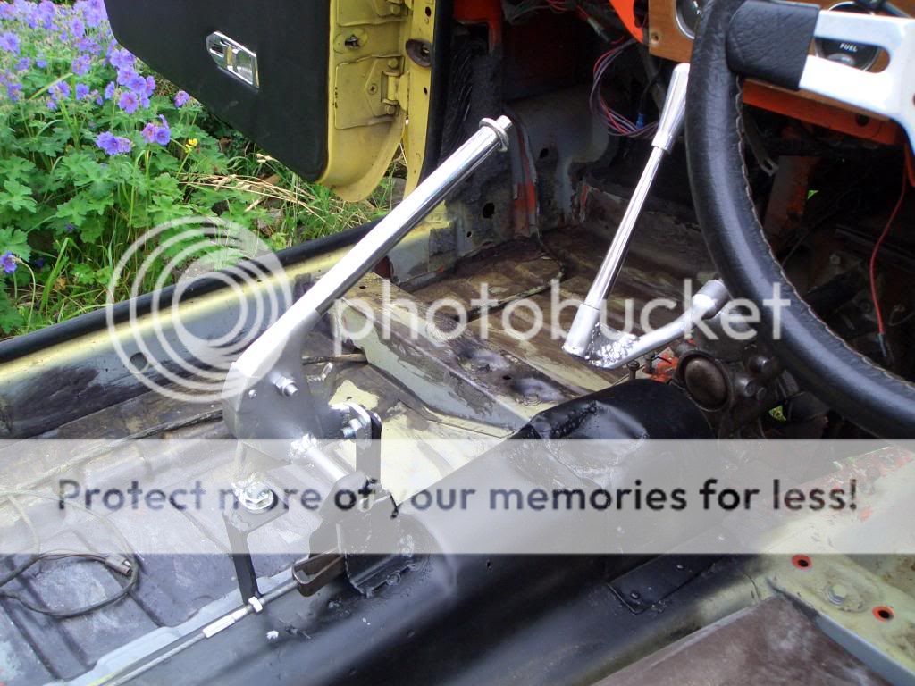

I was happy with the outcome. Of course, compromise has to come into it somewhere.
I welded a lump onto the Spit gear lever ( with it out of the car)
Then welded a 1963 Jaguar gear onto that, and fitted a very expensive
"C" Type replica knob to complete it.
t looks very mickey-mouse but works very well . I ripped the handbrake out of my rotten 1964 MK II Jaguar, (which didn't need much ripping it almost fell out) And cleaned it up a bit and used that. I had to make frame for it to bolt to and designed it to fit to an unmodified,already in position handbrake cable.
  #56

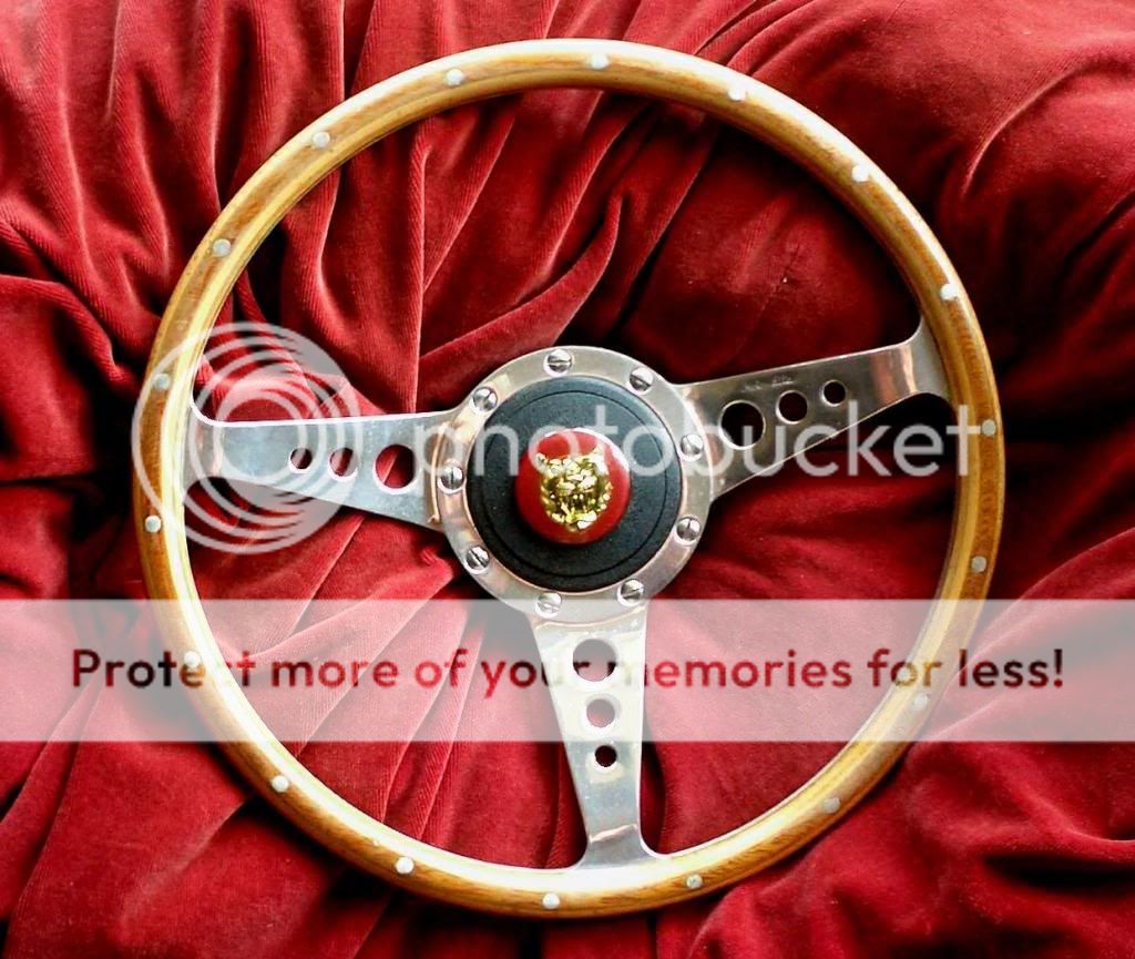

  #60
Old 26th October 2013, 14:52
Default steering wheel
I can not resist posting a picture of the wheel which will complete the build
(One day far away!)
It is a genuine Moto-Lita as fitted to the racing D types, and the XKSS's too.
It came from a humble Triumph Herald 1962 vintage. I have seen these new, (very pricey) but this one has all the age related patina and little nicks, and is obviously quite old, so should really look the part.
The 1962 Herald boss is different to my 1972 Spit, but half an hour with the drill sorted that one out.[IMG][/IMG]
