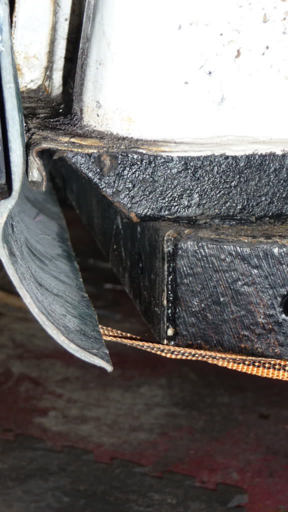

Cut the sides of my floor down today after reading the various threads on the correct line to take,
I cut from tight in at the rear of the chassis out to the bulk head, test fitted the body with the ratchet straps and it has pulled in lovely and feels really rigid just with the straps.
At the front the gap has closed in but may take a fine bit of fettling just to draw the body in a bit closer to the chassis side rail on the drivers side.

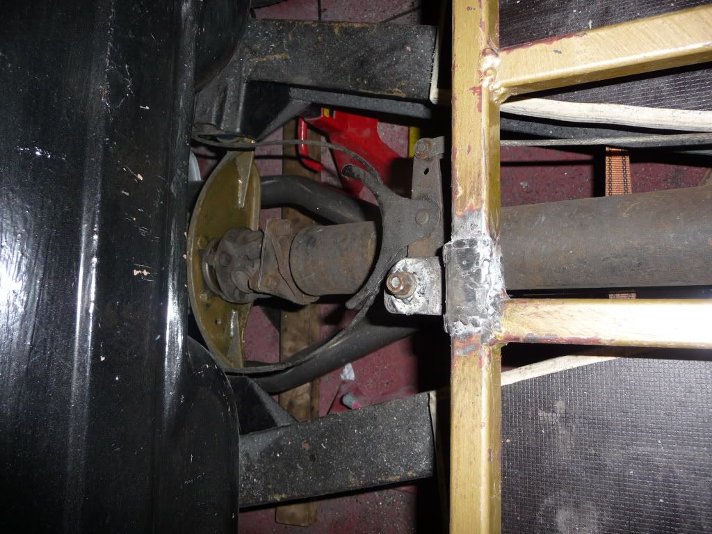

Nice! How you going to mount the exhausts? fyi, I ended up mounting a bar crosswise between the two rear outriggers and then hung brackets down off of that. That also had the added benefit of giving me something to bolt the inner rear wheel arches to!

I had two ideas in mind,
One is the cross bar idea such as you have done,
The other was to sheet out between the outriggers and then form the wheel arch from there, not sure if there is a benefit to this if it would make air flow better underneath or just keep the worst of the weather off the fuel tank etc..Will have to wait and see what develops.
