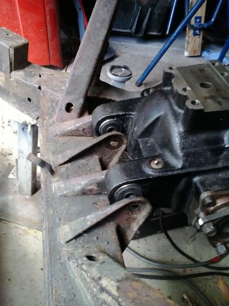

chassis cleaned and ready. heres the diff mounts in finally! ( thanks to my mechanic and a press. ) look, i had them *almost* all the way in by myself...

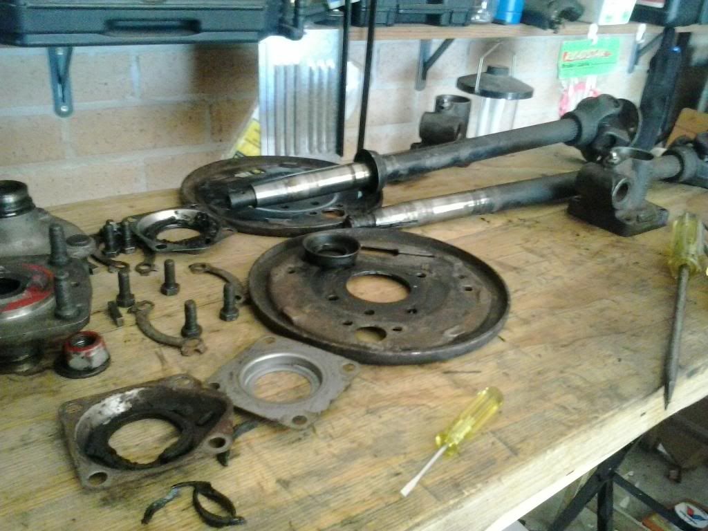

and the rear axles: i was going to leave them alone but had a bit of end float in one side, so thought i'd better take them apart and change the bearings and shim that end float.

you can see the last guy used moly grease for the bearings: it had separated and all the oil gone leaving just the waxy moly. no flow, no good. propper bearing grease going in this time.

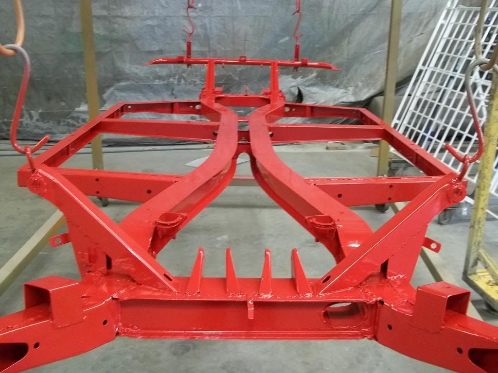

Behold! Untold beauty:
  #66
Old 13th March 2014, 10:58
Posts: 1,767
Lovely, it will be nice to start putting parts back on. Also nice, is the fact it will probably stay in that condition forever...
  #67
Old 13th March 2014, 11:56
Posts: 5,195
Ooh, that looks nice. Good choice of colour - would nicely complement a silver body...
  #68
Old 13th March 2014, 13:19
Posts: 1,145
I love to see a chassis in this state - all that potential.
Looking good.

Th@nks gents, body will end up red too! Most parts are ready, but still working on those rear axles. One side had some end float but measuring the housings there is not appreciable wear. And how far do i squeeze the bearings/rear trunnions back on !?!

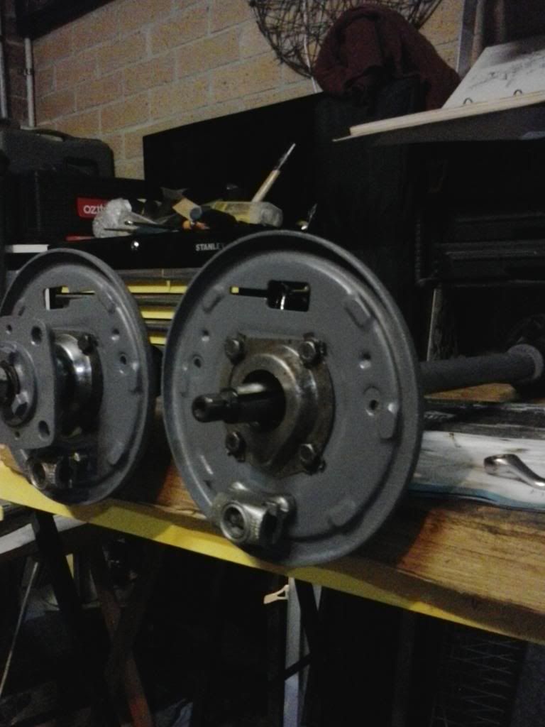

I'd done with the renovation (reconditioning!) of the rear axles, bearings in, I used loctite 641 on the outer race to housing interface as i had movement there. This should hold it. More pics when there's more to show!

rears practically done now, brake back plates on, just need to buy the rest of the freelander wheelstuds and put them in then i can finish the job.
