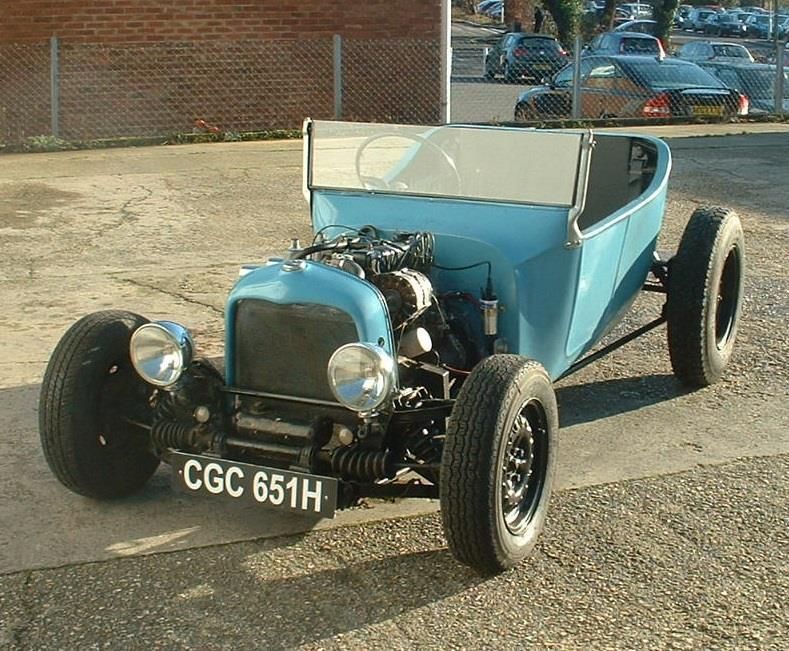

About 3 years ago I built this little open wheeled Roadster around a Triumph chassis ...
