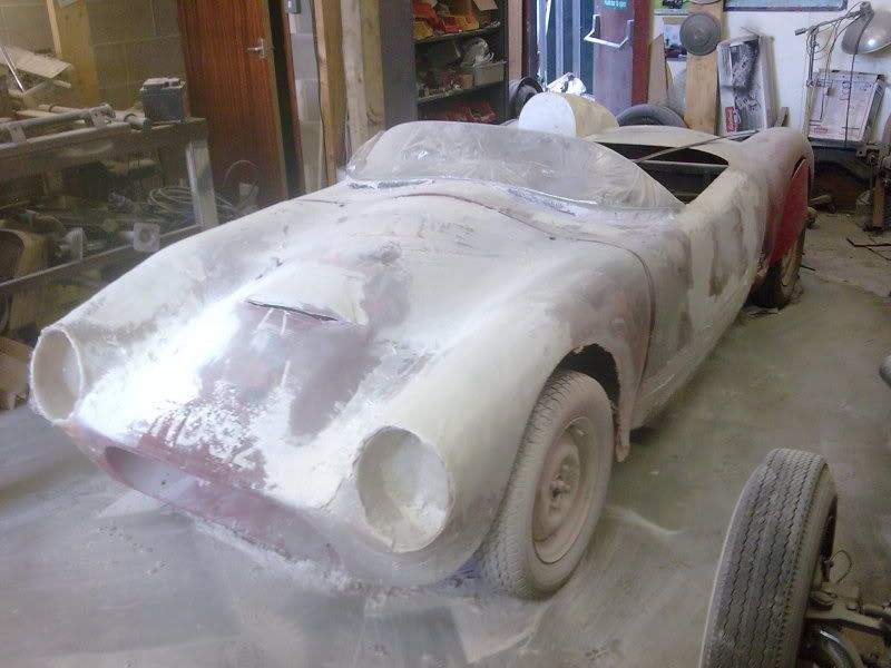

Hi,
I am new to this forum. I am more well known on various Hot Rod and Volksrod forums as I run a small workshop involved in building Hot Rods , Volksrods and importing Classic American cars.... www.bayarearods.co.uk
My reason for posting this thread is that I have undertaken building a 50's style Sports car , similar to a 550 Spyder but borrowing various style tips from many of the cars of that era...it is going to be offered as a single skin style body with seperate front section , no opening doors etc..a basic format ideal for budget and ease of build.
It is based around a Herald Chassis for registration purposes but could easily be put onto a Custom Chassis. Width is similar to a 550 Porsche , wheelbase is 4'' longer at 90'' , height from lower sill to doortop is 24'' , seat bases will be recessed into the floor slightly.
The headlights are VW / Porsche , screen is 550 Spyder , tail lights are Hillman Imp style round units ...all available quite cheaply.
The idea is to offer a car with the look and feel of the 50's Racing cars but without the complicated or expensive build issues......The Ferrari and Porsche examples are traditionally expensive.
Prices are to be finalized but this is intended to be a budget offering.
Heres some pictures of the plug body so far ....units are expected to be available mid-Summer , price to follow....
I would appreciate any comments , good or bad...Thank you

Always admire people willing to give things like this a go.
The front on that last picture looks very much like it's from a Fairthorpe (but then other angles not so sure)
Not sure about the headlight treatment as they seem to dominate the front end but like the overall concept. Sylva are doing something similar with their new car, the Sceptre I think its called.

THANKS JOHN , The car actually started out as the remains of a 1958 NICKRI , only a handful ever built and designed for a Pop chassis , I have changed it a lot , mostly the front to accomadate the Beetle headlights , I wanted it to get the look and feel of the Porsche Spyders and Borgwards etc of the early 50's and both cars use Beetle headlights , small bonnet scoop , screen area to accept Porsche Spyder screen , rear deck has been lengthened and a headrest fairing added , wheel arches made smaller and the body has been given more depth by putting deeper sills on as well as moulding the doors shut and changing the cockpit shape quite dramatically as well......The car will also have skirted rear wheels
I am going to make a mould of it over the next few months and put a few together to sell.....if anyone else wants a body , thats cool , if not , I'll just knock a few out.....

I like the shape and I don't think I would be put off by the headlights. As it has the feel of a classic/special, rather than a kit-replica, then it may well be received by the public as the real deal. (I must add, nothing wrong with replicas!)
The car doesn't lend itself to extensive modernisation, so the Herald base is an ideal option, in my opinion This is so long as the cheap Heralds come with a solid chassis. I think it would need a non-Q plate to pull it off though. It looks like it will be a fun budget drive.
The questions I would naturally ask are..
Will this need the IVA treatment?
What safety features are there - side impact for example?
Will any age Herald be OK to use?
All the best with the project.

Thank you Iadda , you have 'got it' .....it is meant to have the feel of a special rather than a component or replica...
IVA isn't needed , the non-radically altered Herald base qualifies it for the re-register as a rebody , not IVA route ....a whole lot simpler.
Side impact bars would be very easy to install along either side. By tying the front and rear bulkhead hoops together along either side with 1'' box or tube , this also makes fitting trim panels a whole lot easier too...
Any year Herald will work and due to being a rebody , it won't be a Q , retaining its original reg. mark.
