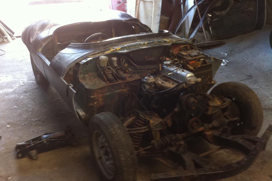

A series of events and opportunities has lead to us putting together a "mock up" car (ie. non-running/unfinished) for the Exeter Kit Car Show. A D-Type shell and a slightly crispy Spitfire shell had found there way into the workshop and it seemed rude not do combine the two of them. No welding is being done on the Spitfire at the moment, so please forgive the ragged edges, although most of the rotten bits have been lost during the trimming process to leave a basic "tub" for the GRP shell to be bonded to.
Once the some trimming had been done it was time to offer up the new outer shell

More trimming of the Spifire

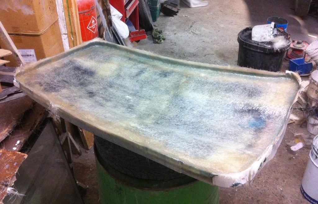

Returns added to boot opening, rain gutters will be added at re-moulding stage, the show deadline wont allow such luxuries at the moment

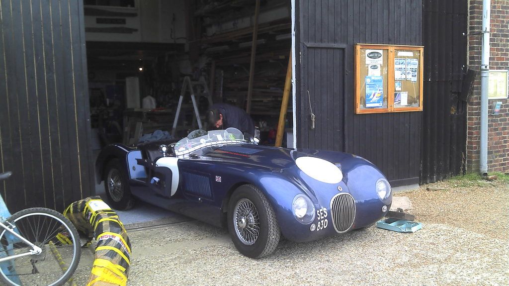

Talking of Jags, heres a C type we had in the workshop the other day. Its also an excuse for me to try and upload a pic to the forum, which more often than not does not work. However just updated my ohotobucket app which now has a new button, so here goes....[IMG][/IMG]
Nice Jag. Congrats on getting the Photobucket thing sorted, now you have no excuse to start your MX250 build tread
