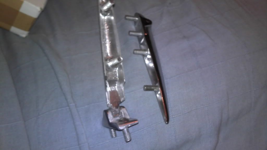

My hinges arrived today. Its the second set as DHL lost the first pair.
They took three days from New Deli, India.[IMG][/IMG]
They are reasonably made and finished, but they will need tweaking to make work.
The small end mounting face is bevelled to match the camber of the bonnet. That will need abeveled wedge of rubber to level it up.
the mounting face of the long bit is slightly curved so that will need dressing straight with a file.
Finally the hinge pins are not at 90 degrees to the hinge so I will probably remove the pins and slot the center hole to allow the them to open square. The slot might need tweaking too. Its possible after all this they may need to be rechromed, but I hope not. I still think its worth doing as they are a lovely shape! Oh yes 9" long.

I received mine too mate, I have to say as I am not willing to be rebuild them I am really disappointed in the finish particulairly the machining and chroming around the hinged area
