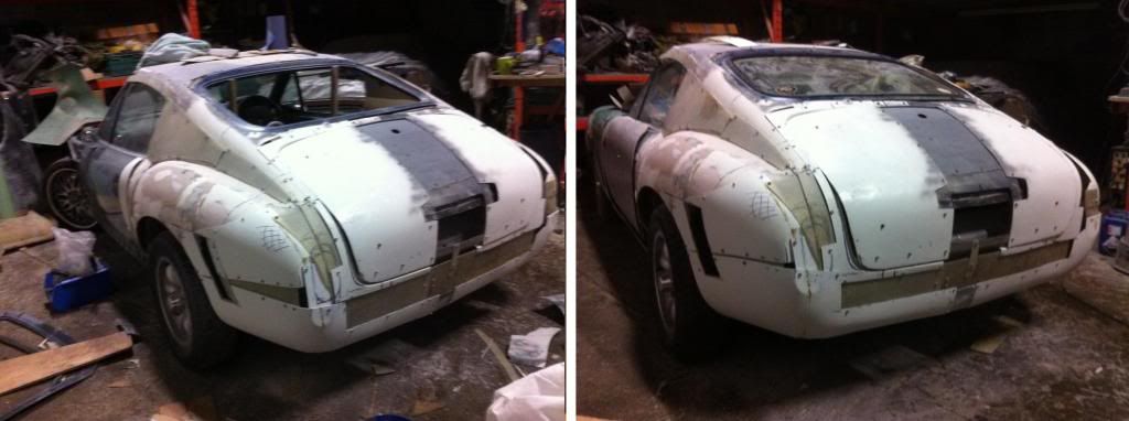

  #158
Old 8th January 2014, 20:32
Geoff's SWB is coming together nicely. The rear end is nearly all there, next stage will be to glass all the parts together and start filling and shaping.
Having brought the front end up the windscreen by a couple of inches has removed the clearance issue over the top mounts on the front suspension struts and has the bonus of improving the side window opening too.
The Z3 doors aren't a bad shape when viewed from the side but belly out in the centre, this will be sorted by adding new door skins.
The rear valance seemed a bit deep and bulky, so it was unscrewed and pushed up 1.5 inches. Much better.
  #159
Old 8th January 2014, 23:34
Rudycob1 Rudycob1 is offline
Join Date: Oct 2013
Location: Doncaster
Posts: 29
Rudycob1 is on a distinguished road
Really looking good. It's starting to take shape. The glass works well and looking forward to seeing the rest of it coming together.
