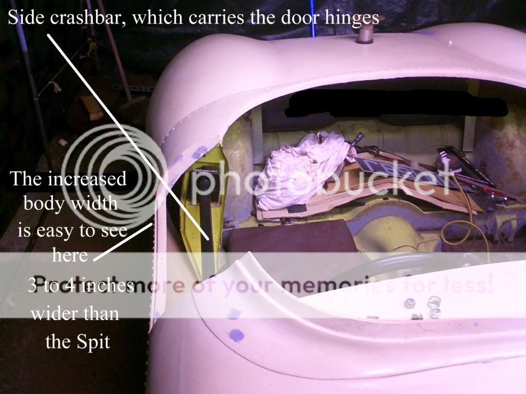

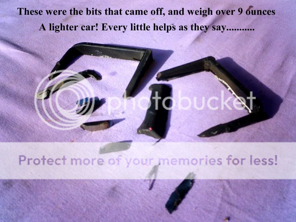

My initial euphoria on finally getting the body actually on the car was short-lived.
I realised that the body was resting not on the scuttle as it should, but at the 10 and 2 o’clock position each side on the door hinge bracket. A totally impossible situation.
Doom gloom death and destruction. The plan is to remove the body again, and cut at least half an inch off the offending brackets, and weld back for strength if necessary.
On the positive side, the body should then be around 1 inch LOWER than it was. Ride on, way to go!!!! Watch this space………..

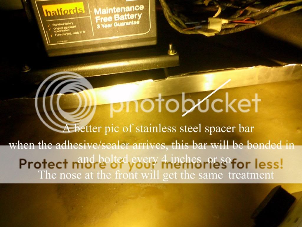

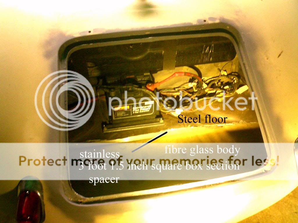

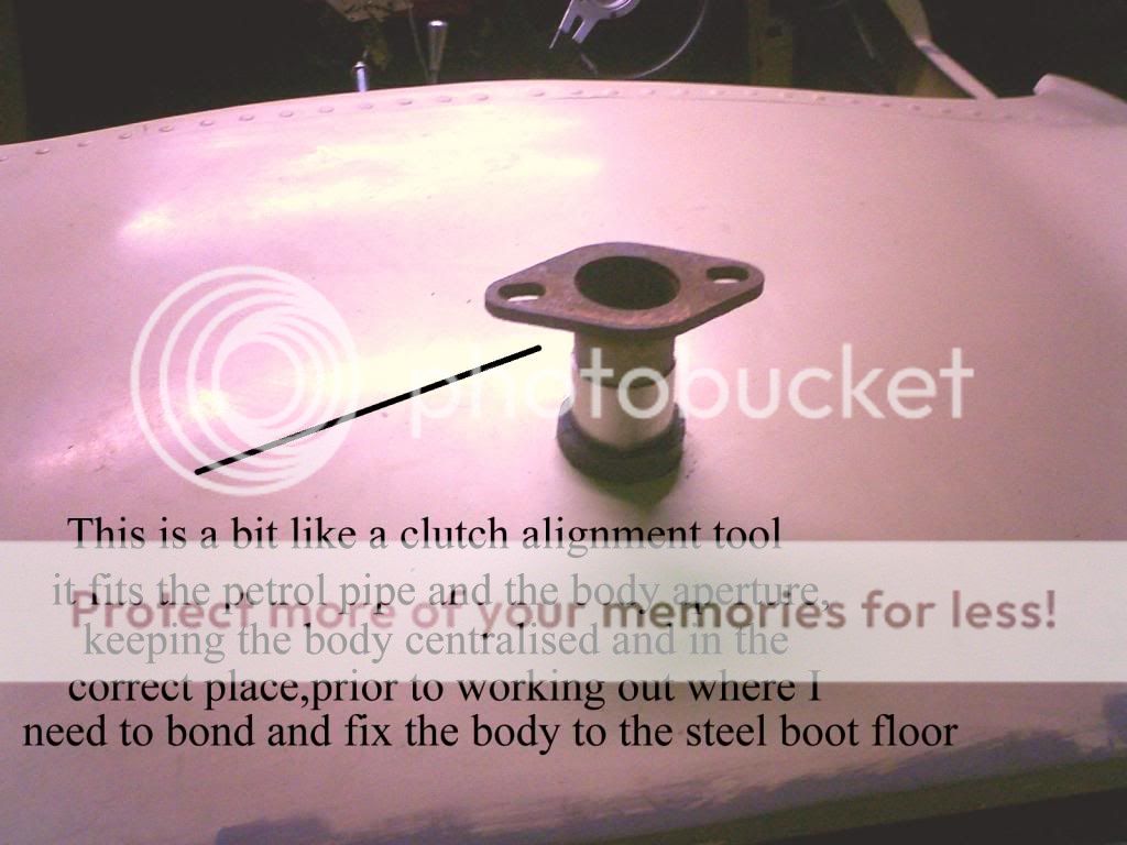

Today I started the preparation I need to do before bonding the body permanently to the chassis / tub.
The nose and tail were too low, with a 3 inch gap between the chassis at the nose and the boot floor at the rear.
When jacked up enough to make contact, it raised the whole body off the
Spit tub, and was far too high.
I found that about half way was a good compromise, the body rested on the tub top, fore and aft, but that position left a 1.5 inch gap between the chassis at the nose underneath, and the boot floor underneath at the rear.
Therefore I needed a 1.5 inch spacer. A trip to my local scrappy yielded Several feet of stainless steel box section the correct size for the princely sum of 2 quid.
I then realised I had not ordered the bonding / sealing goo. Poosticks!!
Should be with me in a day or two.

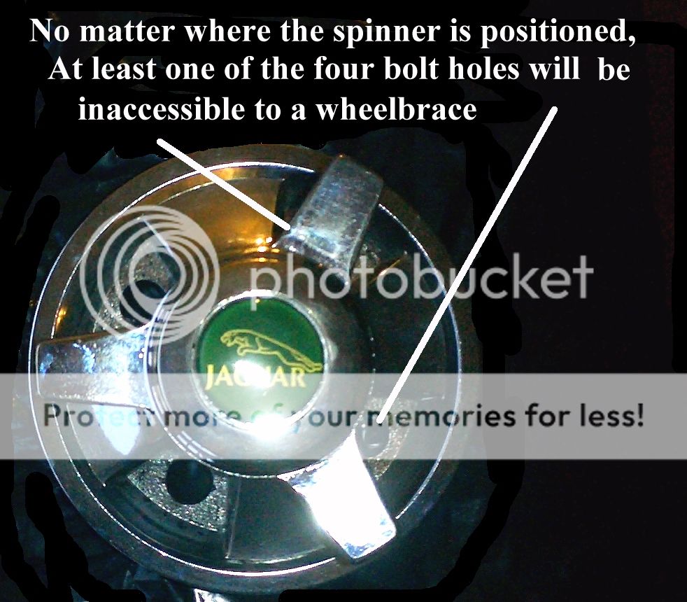

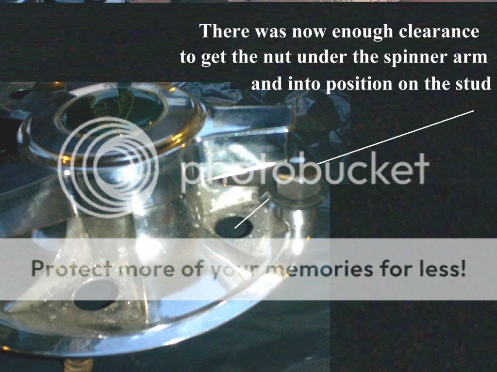

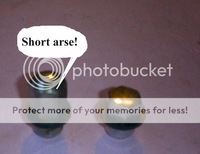

Default Spinner problems

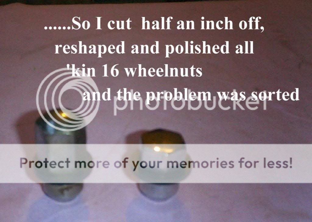

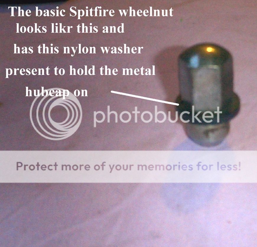

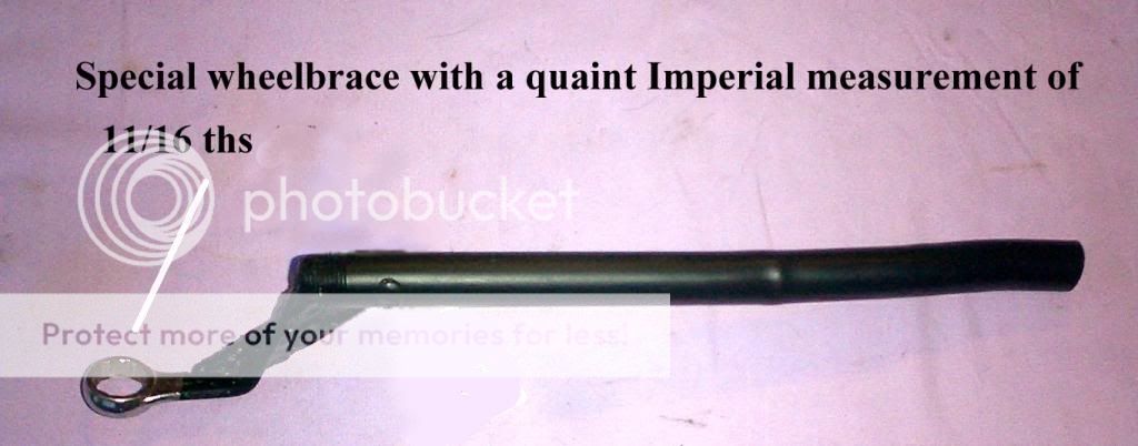

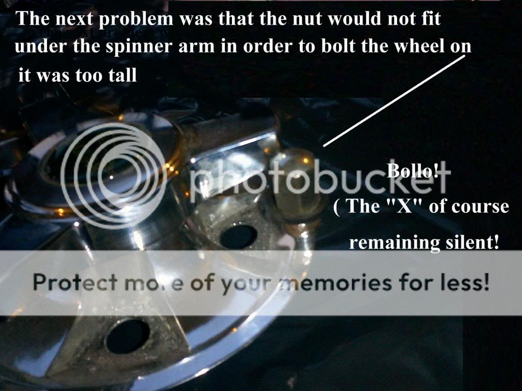

Earlier, when I engineered the spinners to fit, I realised I had a problem with being unable to get a wheel brace past the spinner arms.
I needed to make a specially shaped one.
My first attempt was a failure, and it bent in half.
I did some research, and found that Spit wheel nuts should be torqued to 48 foot pounds.
I made a beefier spanner and gave it a good test, and it worked.
I then hit other problems which I have tried to show in the following pics.

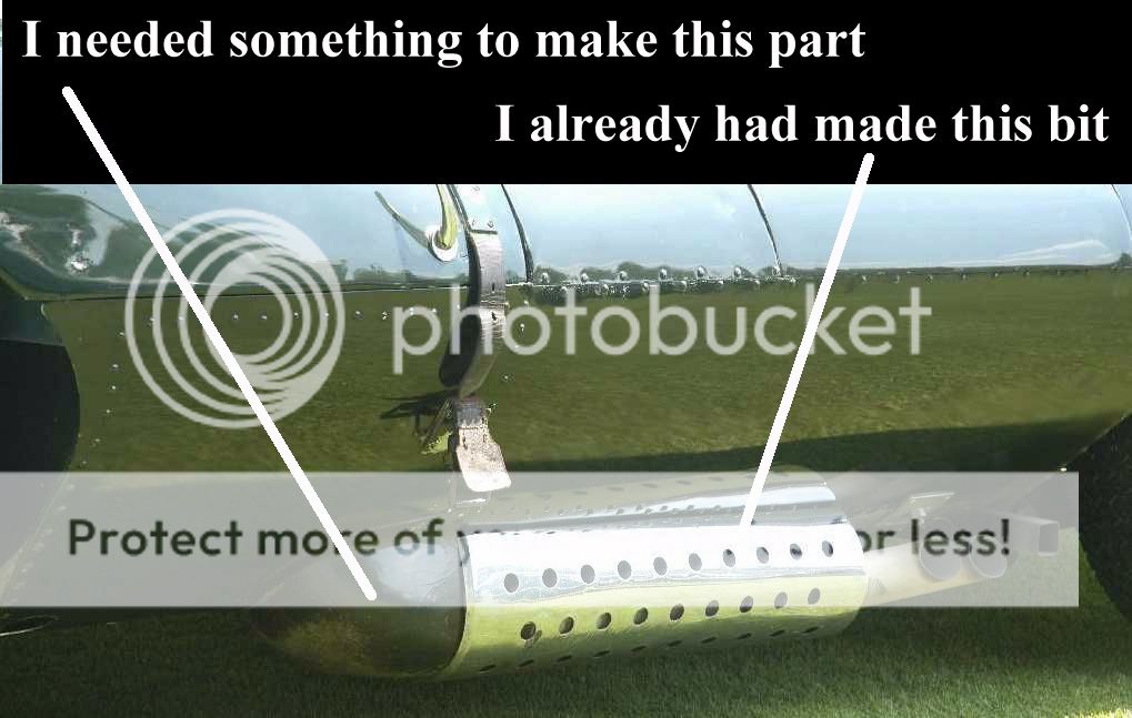

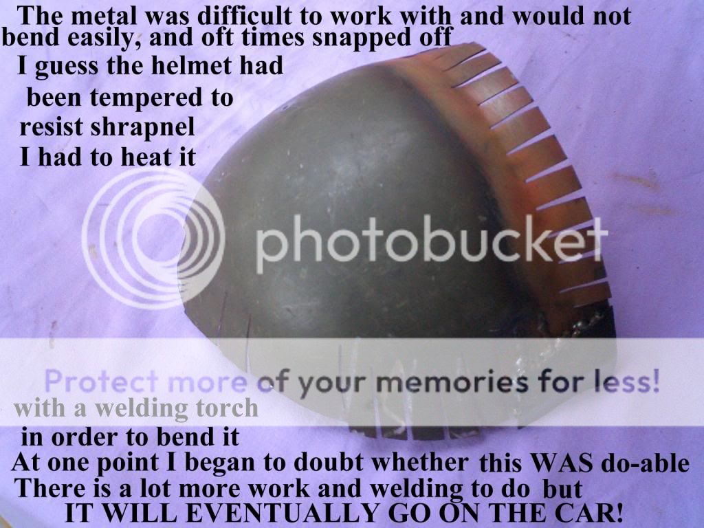

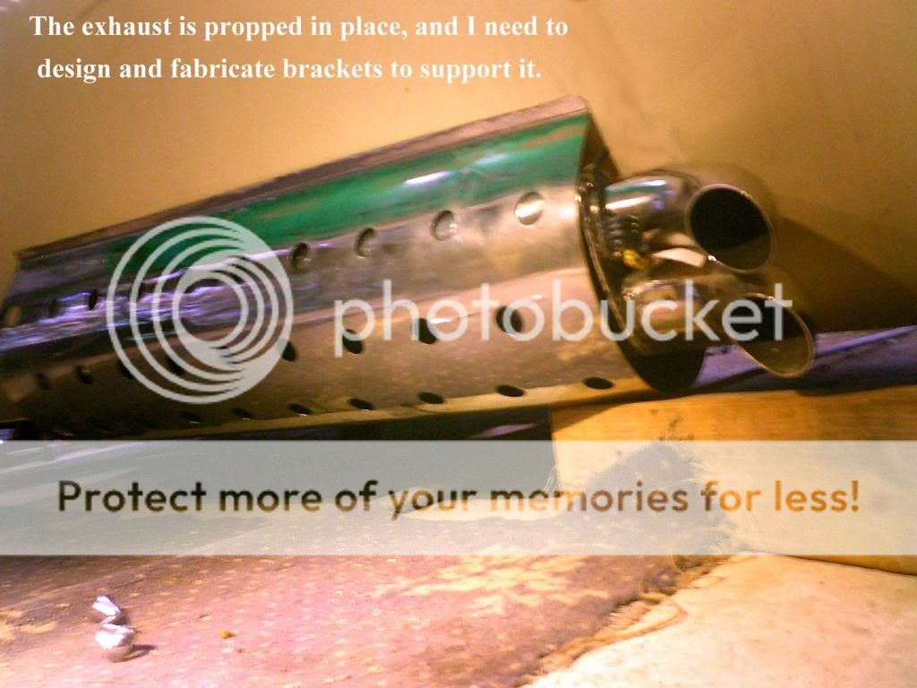

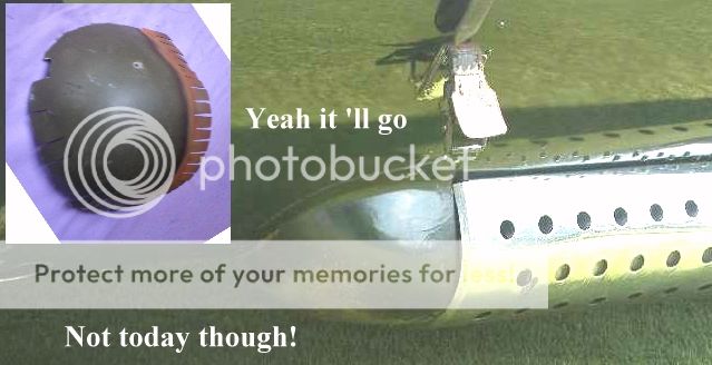

Default Exhaust dome
The bonding goo STILL has not arrived, but I have lots to do before I finally use that anyway.
I need to make a dome type thing to go over the front part of the side exhaust. Also to fabricate brackets to hold it all in place
This really has to be done before the bonding bit.
I always knew that making this dome thing was going to be difficult
But F.H. it taxed my patience I can tell you, and it’s not finished yet!
[IMG][IMG][/IMG][/IMG]

  #113

Posts: 4,874
Scottie - Love the idea of using a soldier's helmet, very outside of the box.
But I have to ask, does the dome need to be made of metal?
Would fibreglass with some heat reflective material on the inside work?
Not sure if you have read SeaNick's build thread?
http://www.madabout-kitcars.com/foru...ead.php?t=3924
But he would probably be doing something based on a drinks bottle for that shape.
Obviously not great timing with the suggestion given how much work you've already put in.

Scottie22 is on a distinguished road
I think you are right Paul, some of the D type replicas have fibre glass
domes. I think it was the challenge that made me pick the hat!
I wanted steel, but the amount of welding I will need to do, it will most likely look crap, and I'll end up filling it anyway!!
I intend to heavily wrap all the exhaust in the right stuff to prevent the
heat from affecting the fibre glass body, so I most likely could have made it from something else.
The work I still have left to do is daunting enough to make me consider
something else anyway! I will have a think about it.

I knew this exhaust mod reminded me of something else I had seen.
These photos are taken from Charman.tech's G46 build thread.
Full details here:
http://www.madabout-kitcars.com/foru...ead.php?t=3211

Default Exhaust
Thanks for the input Paul and WCA, it is interesting.
At least I have no worries about using filler or fibre glass to finish off what I started.
I still find it hard to believe that the red hot exhaust does not damage the fibre glass which is so close to it.

With your spinner/spanner conundrum, could you maker the spinners, er, spin?
  #119
Old 12th November 2013, 20:27
Scottie22 Scottie22 is offline
Posts: 2,161
Seanick, when the car is finished and has the wheels attached, and when it is driven, I fully expect the spinners to spin!
In fact, I'd be mortified if they didn't.
