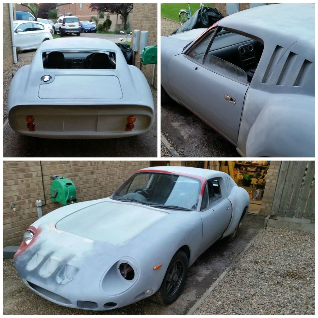

So I haven't posted in a while, there has been a lot of changes my end since the last post but I have managed to steal some time here and there to work on the car.
So in my haste to do some work on the car I removed the rear section... some might say a little to quickly as I had forgotten to unclip all of the rear lights and pulled most of the wires out of their respective plugs. So I had to remove all the lights and corresponding wiring loom in order to spend a whole evening soldering and repairing/replacing a number of the damaged plugs.
I have finally got around to fitting the new side repeaters although a bugger to get them symmetrical with no square line to work from! I am happy with the result and intentionally put a slight slant on them for visual preference only. I have got the front end as square as physically possible with a 5mm variance between the two sides. On the subject of lights I ordered new headlights, in the continued attempt of trying to make this car look retro I replaced the flat faced headlights for domed ones - only time will tell as to the answer of it will add to the effect but first impressions were a thumbs up from the wife!
Since the last time, I have shaped the O/S vents, a much quicker process than the other side. Both sides need trimming internally but not rushing it as I want them to be absolutely symmetrical in depth. This will make the corresponding headlining holes a lot easier to do too.
Today I re-profiled the O/S front wing panel gap to the drivers door and shaped the inner flange to prevent the door catching it as it opened. I believe the original profiles was the reason for the original damage by the door opening. I prep'd the boot extender panel ready for final fit by sanding and filling, so now if you peek in the boot it looks all square etc.
With excitement of this regained enthusiasm and determined focus I thought I would treat myself to giving a sneak peak of what it will look like. Amazing what a pane of glass will do for the effect. It was surprisingly an easy fit too so that was an added bonus. This was the only time that I stopped to take a picture.
Sooooo I have some time this week weather permitting to hopefully get the rear bonded by Friday... fingers crossed!

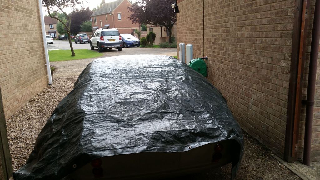

This next bit is a public service warning... Be careful as to how you store your shell over the course of a build. as you may have seen from previous posts I tuck my car away under a tarp and tied down with ratchet straps. This in itself is not an error, however how tightly I strapped it down was, over the months this has warped the body a little out of shape. The good news after a very helpful phone conversation with Chris I went out and got some long bolts and large washers, this enabled me to gently torque them up bit by bit and pull the rear of the body back into line. Phewwwww!
no pictures today but if the weather is good tomorrow I will post some.

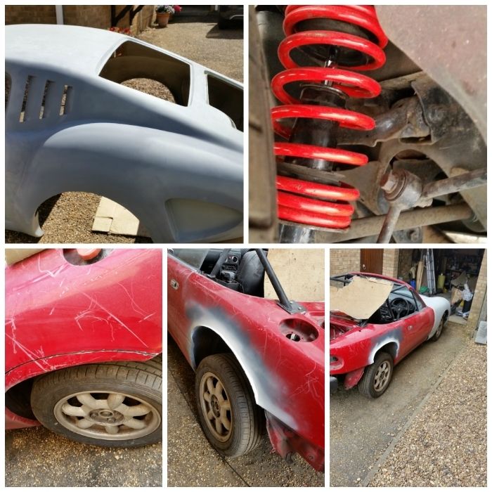

So no work on the car today, I'm having a day off. However thought I would post some pictures from yesterdays quite slow and frustrating day.
First off was to complete the fuel filler cap and hoses. I don't have any pictures of the doing bit - I had a few days earlier removed the the factory fitted neck flange but carefully grinding to slits down the sides followed by grinding out the spot welds to remove it. This left me with just the main pipe and breather hose section. I connected them via the appropriate hoses. I am one jubilee clip short however, I will get this on my next trip out for supplies.
I have decided to take a different approach to bonding the car and do away with the Polyester based resin and go for what should be a stronger longer lasting if not more expensive option methacrylate based adhesive. We shall see if this was the right choice in due course. The setback to this choice is that I made a stupid assumption that dual applicator guns would be readily available and didn't order it with the glue - this is not the case and had to place an order on Friday that won't be dispatched until Monday so looking at the back end of the week for bonding me thinks.
So with that in mind I looked at a few other jobs, mainly preparing the doors and removing the swage line. I found this the most frustrating task to date on the build and accumulated to make it the first non fun day on the car - removing the underseal paint on the lower half of the door. I also wanted to cover over the wing's dark etch & red primer I had used to help me see the curve of the headlight bowl better. I powdered on with the lighter grey primer to help give me a truer vision with it sitting in one colour. I still have work to do on the blending but I truly had enough at the end of teh day and didn't want to over do it and save it for another day.
So here is the the view at the end of the day.
