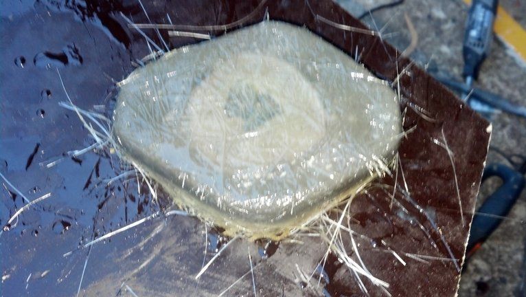

Had a go at placing the fuel filler but wasn't happy with the way it sat at the back so tried my hand at some real fibreglass sculpting..with no real idea what I was doing.
First made a mould routing into some ply
Then applied Vaseline as my release agent, and put in some Bonding paste..
Once dry popped it out and then Covered in Glass strand and Resin
Left it overnight to harden before trimming it up and glassing it to the underside of my body
Then shaped the cut away in the body to the edge of my moulded shape and now I should have a semi recessed filler cap , proof will be tomorrow when I hope to fit the cap after bonding the body.

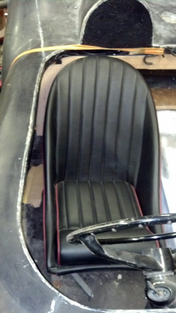

Considering its a flat floor no drop and standard Herald seat runners the height isn't too bad..

Default Your seat!
Sorry to ask but where did you purchase the bucket seat?
It has a much cleaner line to the covering than most I have seen, it almost looks in period.
  #110
Old 29th September 2012, 07:40
Charman.tech's Avatar
Join Date: Oct 2011
Location: Surrey
Posts: 363
Sorry and does the seat squab lift out?
  #111
Old 29th September 2012, 07:43
Psycho pops's Avatar
Location: Marmande 47200
Posts: 501
Hi
The seats came from Westfield , they are lotus XI buckets and yes the squab does lift out,
Dont know if they are readily available from them as I got mine through their E Bay sales sight..
Pops
