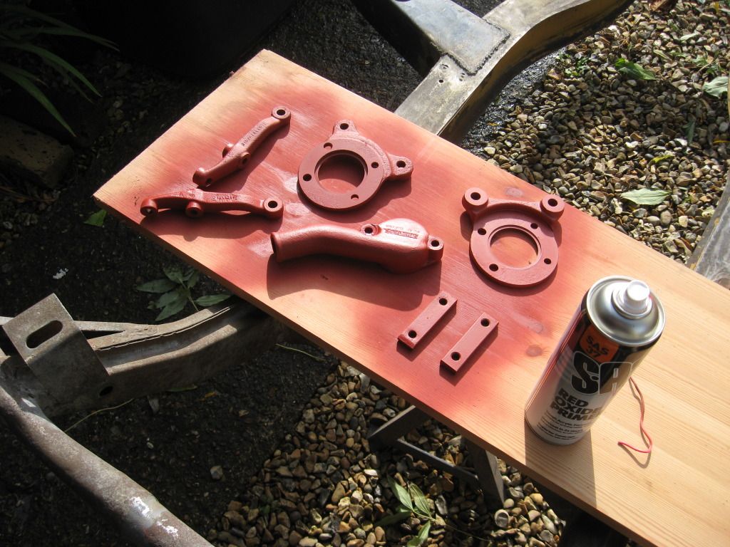

Old 8th October 2012, 14:23
Question.
So i have shotblasted some parts and rex oxided them... can i rebush now, so that i don't scratch the top coat?
  #188
Old 8th October 2012, 15:10
I top-coated before bushing - didn't want to get any Micha overspray on the bushes. I was very careful before putting bits near the vice - wrapped them up and used wooden blocks etc.

Old 12th October 2012, 15:51
I have metal prepped the chassis to take the POR15 which i will do Sunday. I did a bit of shotblasting of parts and got some red oxide on them. Also had the old tyres taken off the rims ready for blasting aswell. I was intendin on having white walls, but i have been told that may mean having to have tubes.
