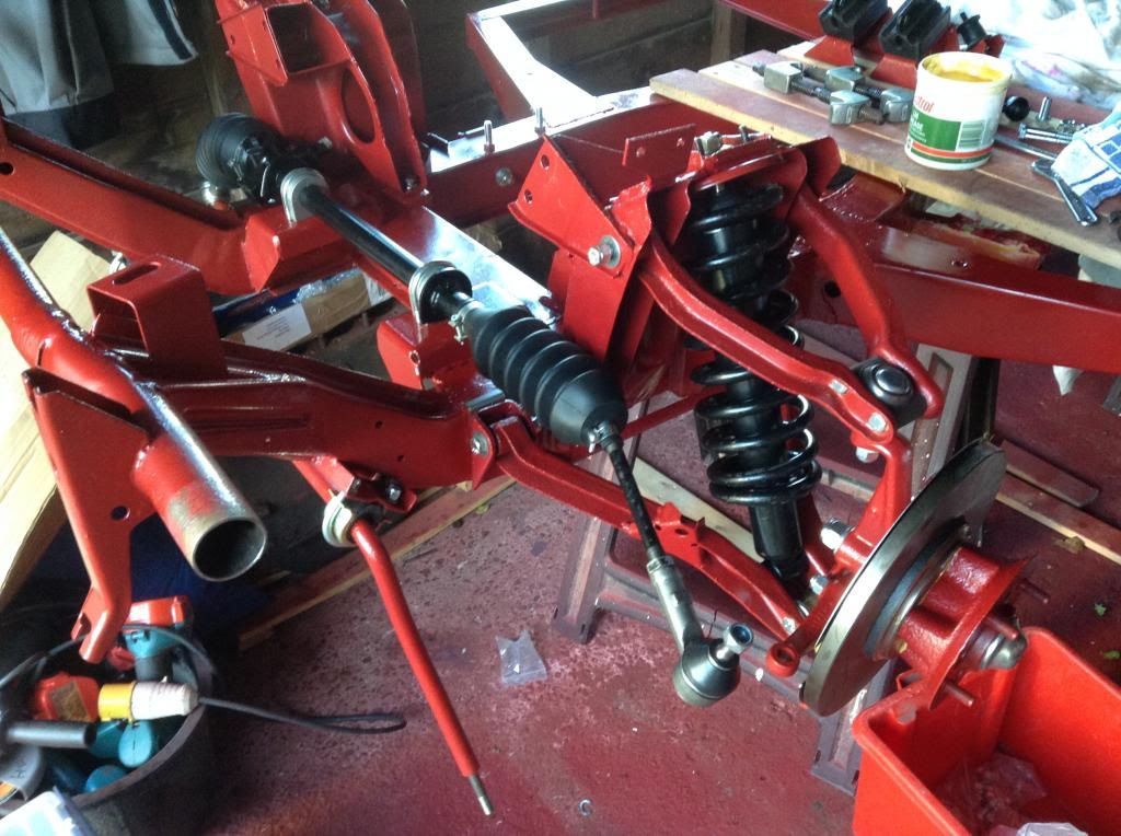

And here are some bits on the chassis at last.
  #347
Old 11th November 2013, 15:51
That is such a nice stage - clean items and new nuts and bolts. Set ratchets to tighten! Well done - keep going!

Old 11th November 2013, 21:34
Posts: 5,055
Gary - Sorry I can't help with the gearbox question.
But the rolling chassis is starting to come together nicely.
Although it was always going to, given the restoration work you have done.

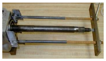

also, when i remove that main bearing what sort of hammer should i be using or should i make one of these...
  #357
Old 25th November 2013, 11:14
Viatron Viatron is offline
Posts: 1,163
wouldn't use a hammer Gary, that looks pretty simple to make so would go with that if you have the bits to make it, just make sure you tighten the nuts up evenly to draw the bearing out straight.
