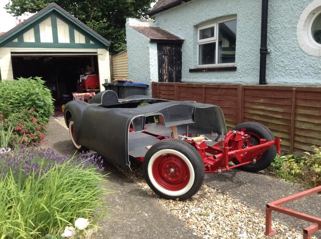

My nephew thinks it would be great just left like this... a Rat Rod.
i cut them off, looks much neater.
re-welded wishbone bracket, hope the otherside will be ok...

Gary - Your rolling chassis looks great and I love your wheels.
Good luck with the floors, Paul.

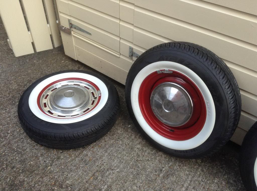

Thanks Paul, i will fit the trim rings and hub caps.

I want to start measuring for the internal frame but my wheels are tucked under, so doesn't show how it will sit in regards to arches... do i let it settle or do i weight it down? I have already fitted the wishbone brackets that allow you to lower car, any ideas...
or do i take some leafs out? Don't want it getting too soft.

Set the wheels where you want them to end up and fit the body around them. You can always readjust them later when the car gains weight.
From experience I'd recommend that the back wheels should be upright and effectively camber free with the vehicle unladen. Any lower and you start to get ground clearance and tyre to wheelarch fouling issues (dependent on wheel/tyre size fitted).
At the front I've ended up with the lower wishbones rising slightly towards the wheel by about an inch. With them parallel to the ground I suffered weaving at speed and with them lower I had serious ground clearance issues, which made it stressful to drive. As it is now I'm very happy with the looks, ride and handling -
Good luck, looking forward to seeing the results.

There are so many variables at play here: weight of the vehicle; weight of the occupants; condition of the spring after 40+ years; personal preference of the driver; road or track biased; etc, that there isn't really a one size fits all solution to that question.
Assuming you've already taken out the three loose leaves on top of the stack, I'd suggest you try it with all the remaining leaves in place first. If it's too firm then take one of the leaves out of the next stack down. I've taken out the one from under the leaf with the 'U' clamps that hold them all together attached. It now sits where I want it without any lowering block fitted and rides compliantly allowing higher speeds to be attained with confidence on our rough old roads.
A bit of trial and error will get you there Gary.
