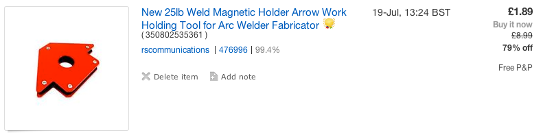

I THOUGHT THIS WAS GOOD VALUE.

Good value? I'd say! Just paid £3.99 and thought I had a bargain!
