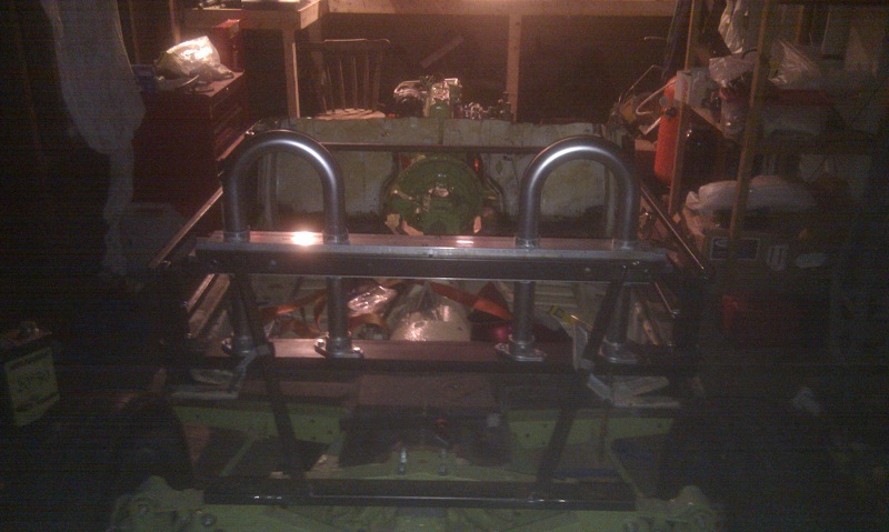

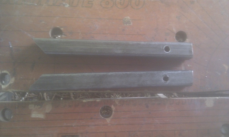

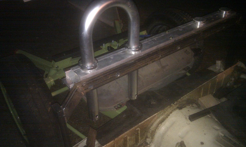

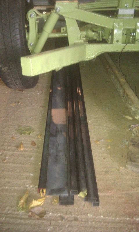

Another quick trip to the woods to cut a couple of box sections for the rear frame. Ran out of light to weld which was a shame but they are ready for next time. They're held in place with welding magnets in this pic.
Finally, I couldn't resist sliding a hoop in place. Obviously it needs a base plate on which to sit, but it's quite encouraging to see.

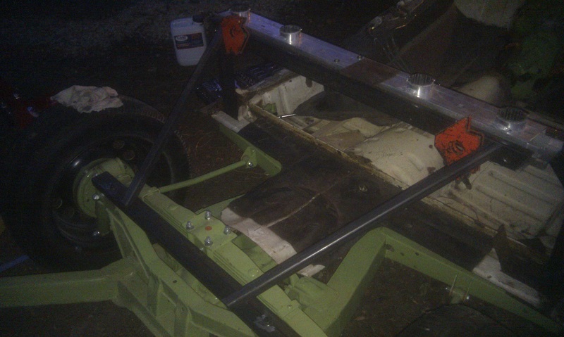

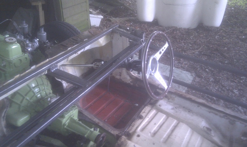

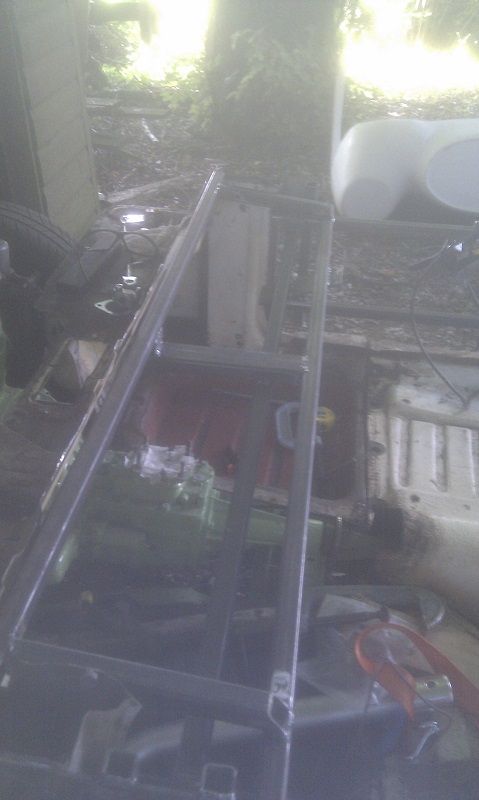

Just to prove that I am still alive and making some (slow) progress, here is a pic to show that the moon rover stage is getting closer. Apologies for the poor quality, but it was getting late and so was I.
The frame is currently tack welded together and I am reasonably pleased with it. I've included lots of mounting points with crush tubes. Some are being used already, and others are "just in case" because I don't want to butcher it once it is primed. For the attentive readers amongst you, you will remember that I am using the full Herald steel floor. This will be blasted once I have finished tweaking it.
This afternoon I decided it was time to stop fannying around with a gas MIG that isn't quite up to the task of welding the box section, and I have ordered an eff-off arc welder. Behold the power of the stick!
Oh, and after months of "will I, won't I" I have opted...........not to go for doors of any sort. And, that is my decision........unless I decide to change it before the body is bonded.
Tomorrow I plan to do some trials for the position of the steering column/wheel. I have added two UJs so that it sits centred and square-on to my driving position. Who said life should be easy?

Old 6th June 2014, 20:02
Audi TT hoops and crossmember. They are easily removable and I won't use them most of the time. However, there will be times when I feel the need for a little added protection. They won't provide much but would support the car in a gentle roll.

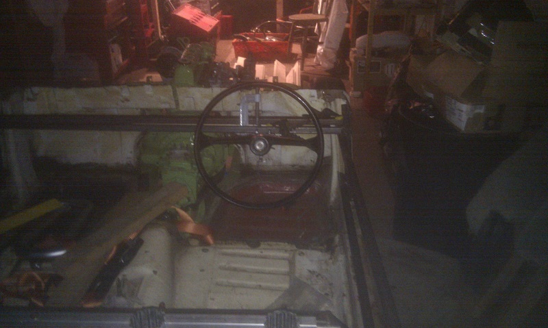

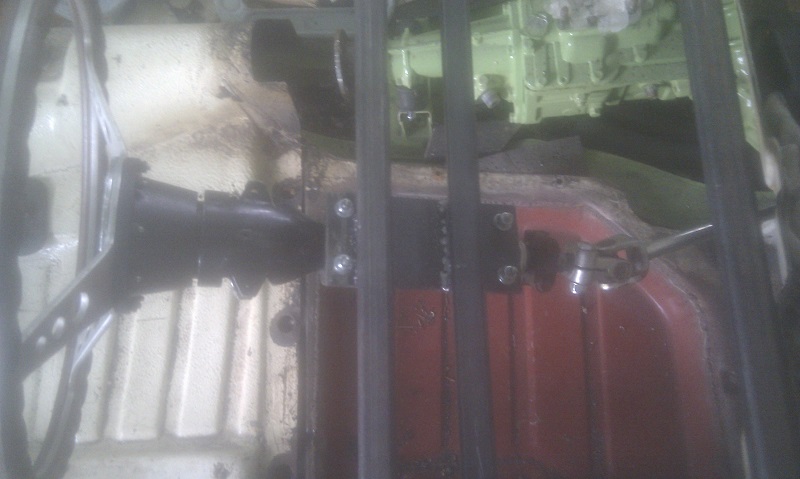

Another picture taken by candlelight. Nothing much but behind the mess is some real progress. By deciding to build the frame myself I have to decide the position of the steering wheel - height, rake, distance from driver. And, I have to do this without knowing exactly my seating position. I got myself comfortable and put the wheel in the ideal place.....but this made it almost impossible to get out. So, a few compromises later and it is now central and square to the driving position. It may not look like it in the photo, but the wheel is perfectly in line with the roll hoop.
I shall connect up the new articulated column this evening and get some proper pics of all the steps. This will show the new super-short original Herald column.
After the pic was taken I popped the bodywork on and the position of the wheel in relation to it is great. I'm resisting adding my Moto Lita but I won't be able to resist for much longer.

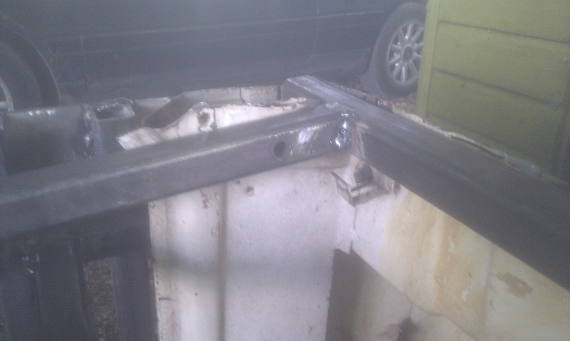

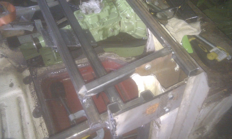

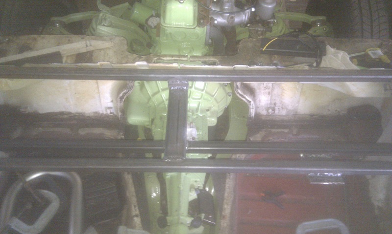

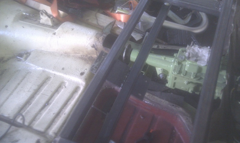

Not very interesting pics but I need to convince myself of progress. Today I had a chance to continue welding the front part of the frame. I'm gad that I chose to make it myself. Like all aspects of the build, I've really enjoyed the chance to learn new things.

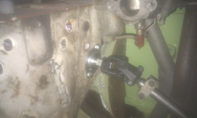

A view of the very simple but quite neat steering column mount.
Two small braces compete with crush tubes - more on these in a moment.
You can see the driver's brace in place. This attaches to the box section that runs along the top of the front bulkhead.
This is the passenger side. I shall put a bolt through to get a solid fix on the old A-pillar. The more things that are attached to each other the better. I shall trim off the top of the A-pillar to be flush with the top of the brace.
A centre brace to strengthen to two cross-members that run beneath the scuttle.
A full view.
The steering column is all ready. I shall bolt it in tomorrow and then, for the first time n three years I shall be able to steer it as I push it and out of the garage. It doesn't take much to make me happy.

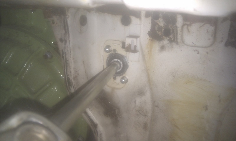

A good afternoon. One of those days when all the planning and preparation pays off (rather than cr*pping on your dreams).
When I planned to redo the steering column, the challenge was how to have a solid mount next to the middle UJ. When the column passes through the bulkhead it is not perpendicular to any plane, i.e it is heading downwards and to the the left.
Components for making your own column are not as plentiful as in the US where the hotrod market delivers just about anything you want. However, CBS has a few things -
http://www.carbuildersolutions.com/u...ng-column-link (it was cheaper when I bought it)
Then I discovered pillow bearings and life became easier -
http://www.ebay.co.uk/itm/17mm-Inner...item43bbd09900
So, here we go -
For the first time in three years I have a steering wheel connected to the rack. And, even with my work boots, the middle shaft clears my feet.
Now, I can understand fully why other builders will stick with the Herald column, but if you are thinking about straightening and centring it, it's easier than I expected. I did have the luxury of three full columns to use for parts, but even so, they are easy to come by.
