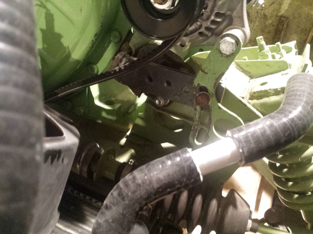

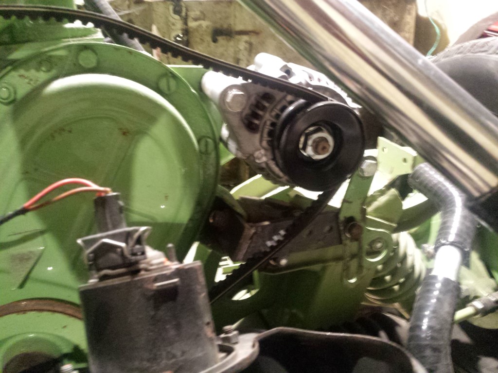

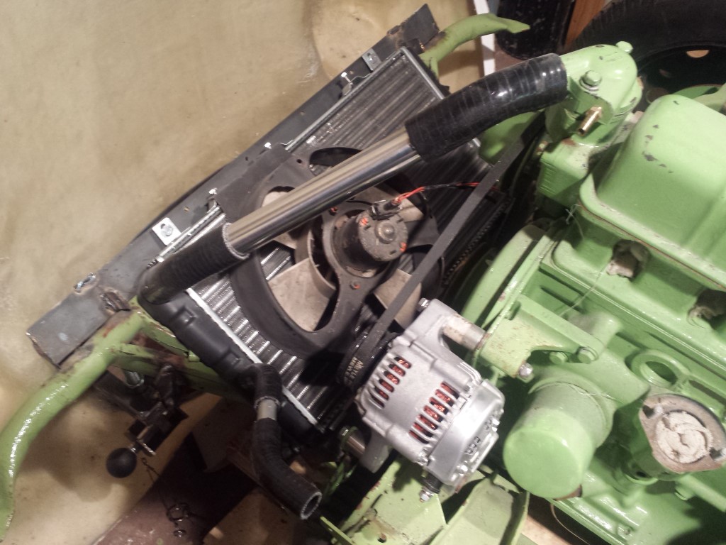

Ed, the Kubota alternator fits nicely. I had to make a new mount for it that bolts to the engine side of the engine mount and buy a conveniently available M8 spacer, but it now sits exactly where I want it.
As you can see I have also done some tentative plumbing to make sure that none of the key components are vying for the same limited area under the bonnet.
The rad (from a Skoda Felicia as the take-offs are in the right place) is at an angle but an aluminium shroud in front will direct air through. Only testing will see whether it works, but I am reasonably confident.

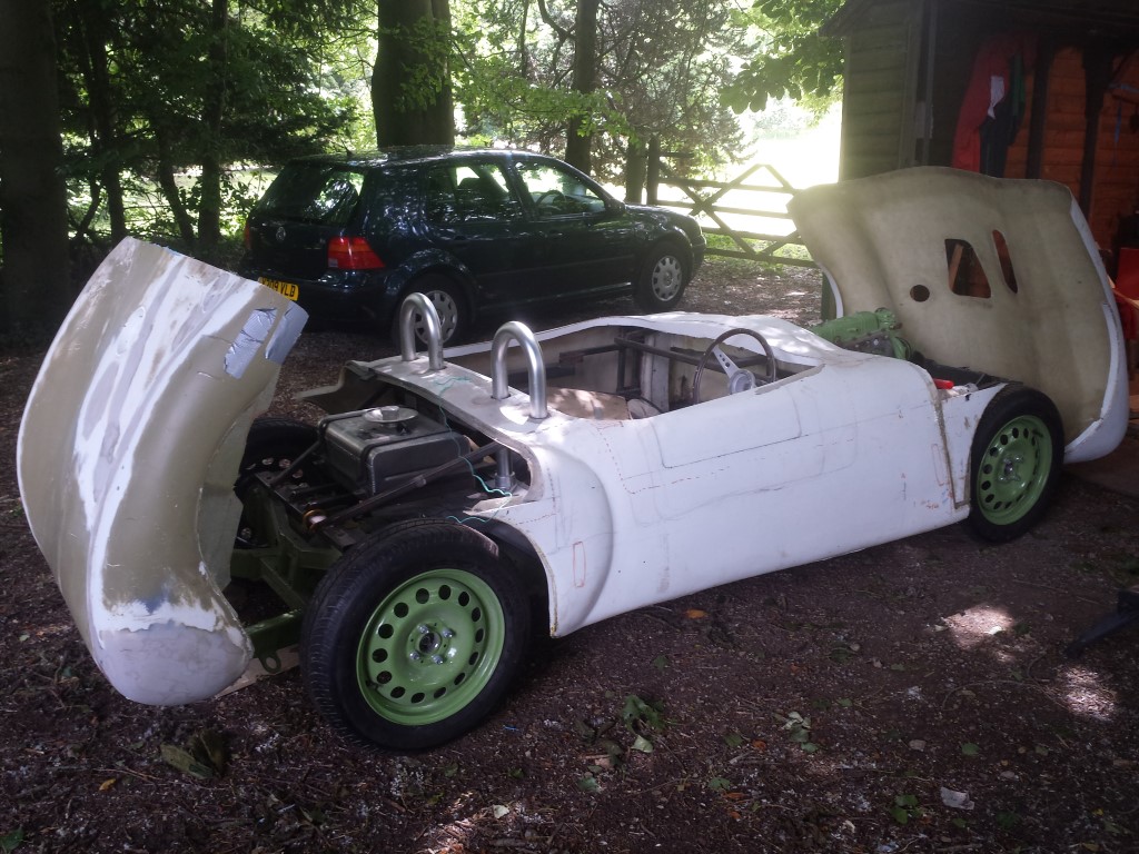

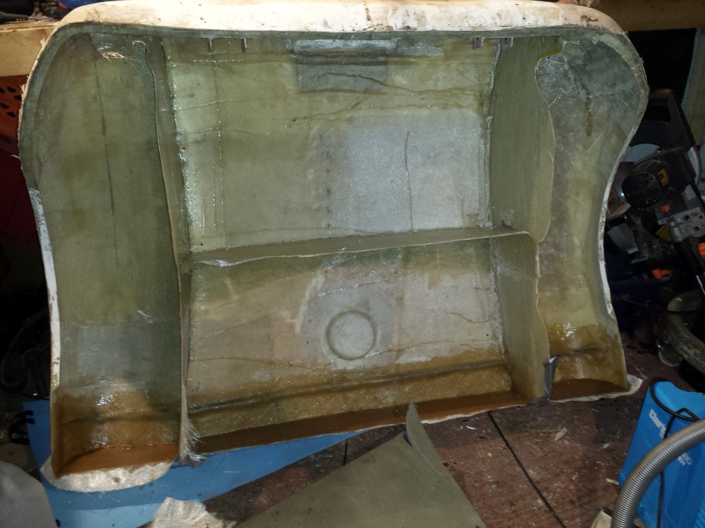

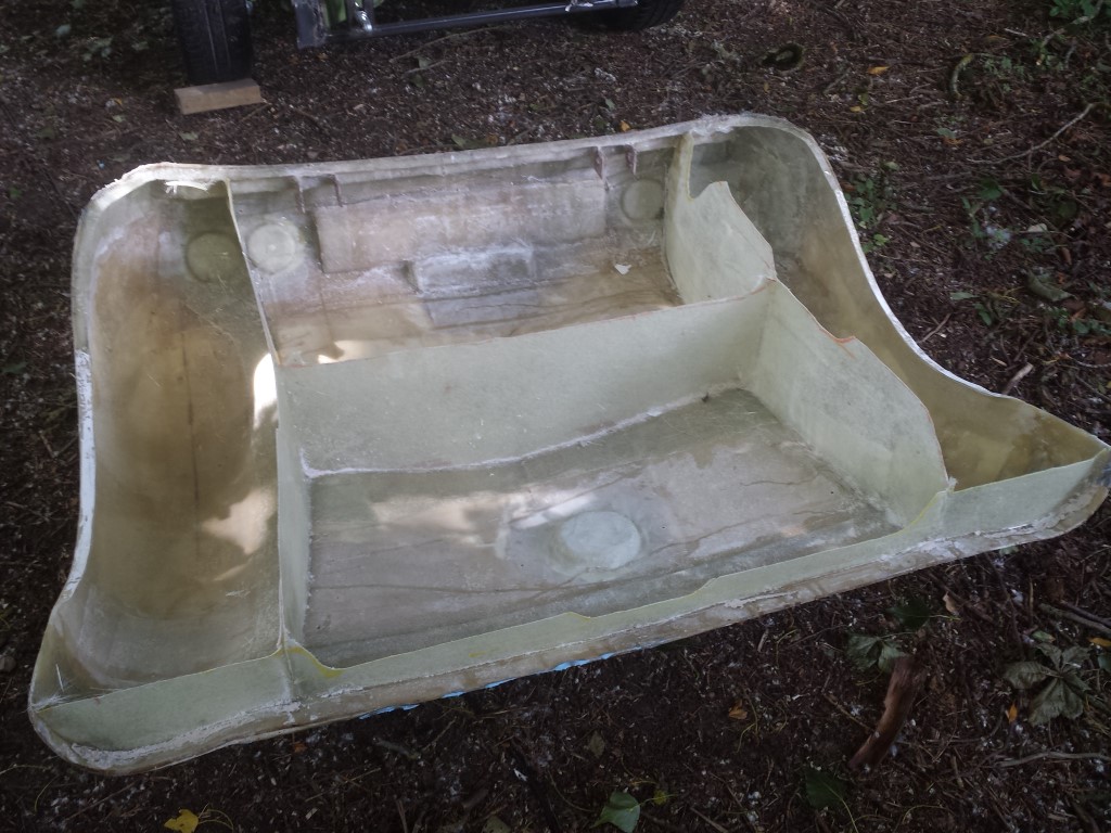

More time spent on Operation Rear Deck. I'm sorting out the inside, adding internal arches and some mini bulkheads to add rigidity.
They are currently single layup of 400gsm. I will then trim them to shape and add further layers. It is adding weight but I believe that it is worth it.
The deck looks distorted in the photo but it is just an optical effect.

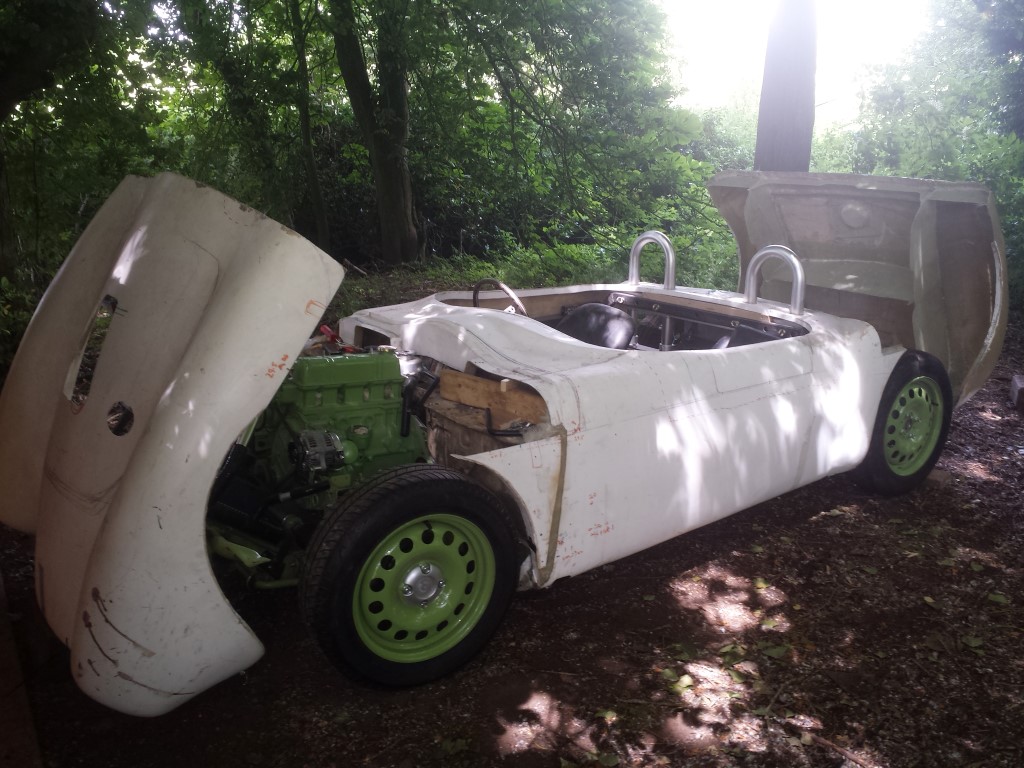

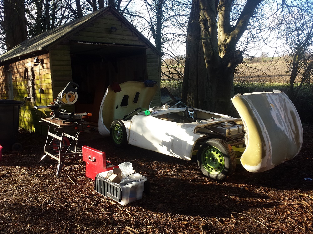

So, before some more laminating I couldn't resist seeing it with bonnet and deck open.
Then it was back to the inside of the rear deck - trimming and lay up.

Did you make sheets of fibreglass? what are all the drawings on the shell? Doors...
  #507
Old 21st June 2015, 15:01
Hi Gary - I use hardboard covered in parcel tape as barriers/formers and then glass up against them and remove when it's all gone off.
A few photos back you can see an example of the board in place along the front edge. In the most recent pic that board has been peeled off.

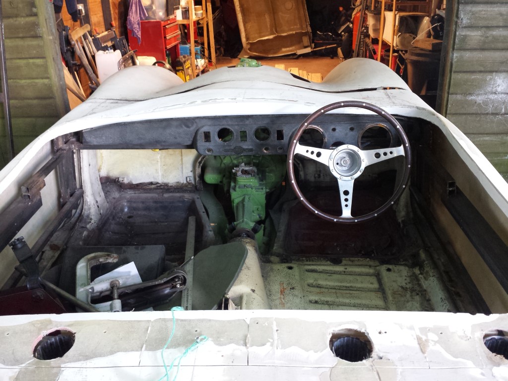

First trial fit of the dashboard. It's steel which will help the illusion.
Quite a bit to do.......as always.

Spooky! I've just posted a photo of a very similar steering wheel on my build.
Your metal dash looks great and seems to have a lot of "contours", how did you achieve this?
  #515
Old 9th July 2015, 20:07
Paul - it's from an early Midget. £10 from eBay.
