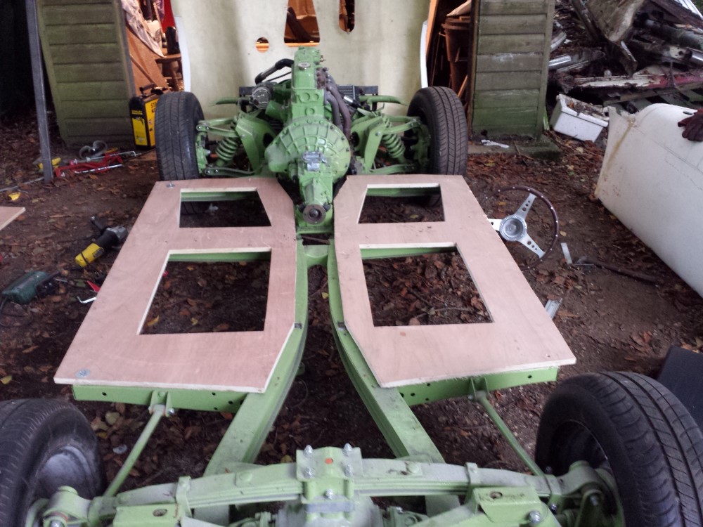

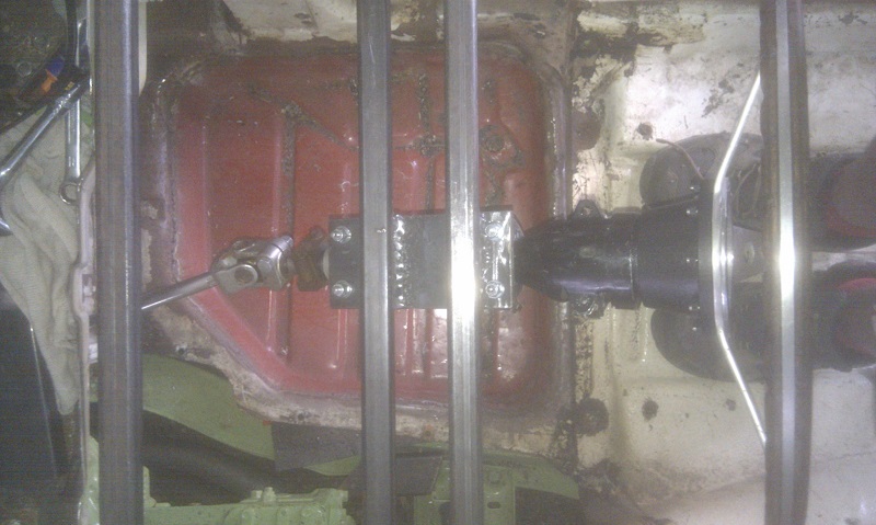

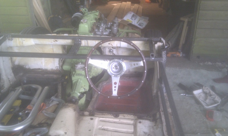

So, a quick update. I became obsessed with trying to build a car that was "perfect" in my eyes. It was a mistake. I should have got on the road and then improved it. Anyway.........

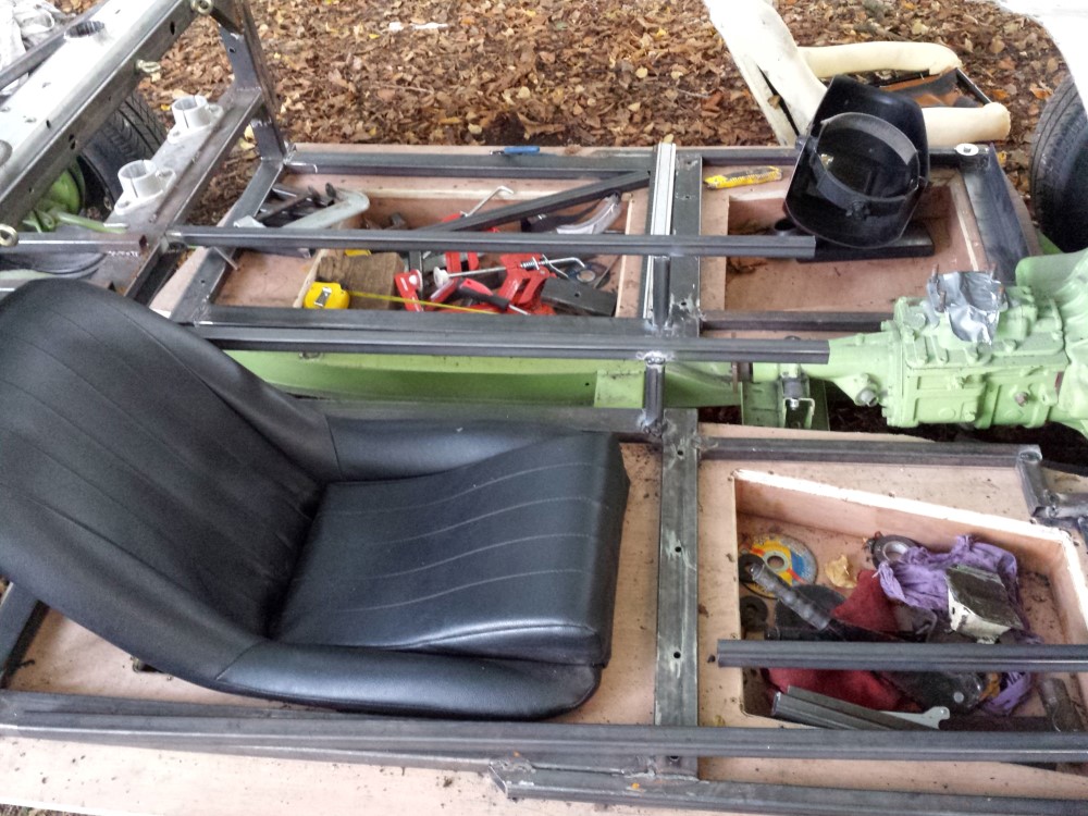

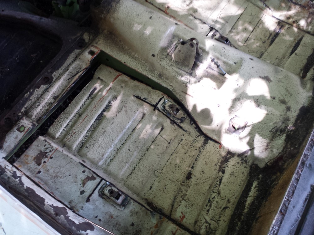

To recap, I wanted to use the full steel floor of the Herald. I made a new steering column so that the column was perpendicular to the bulkhead and centred on the driver.

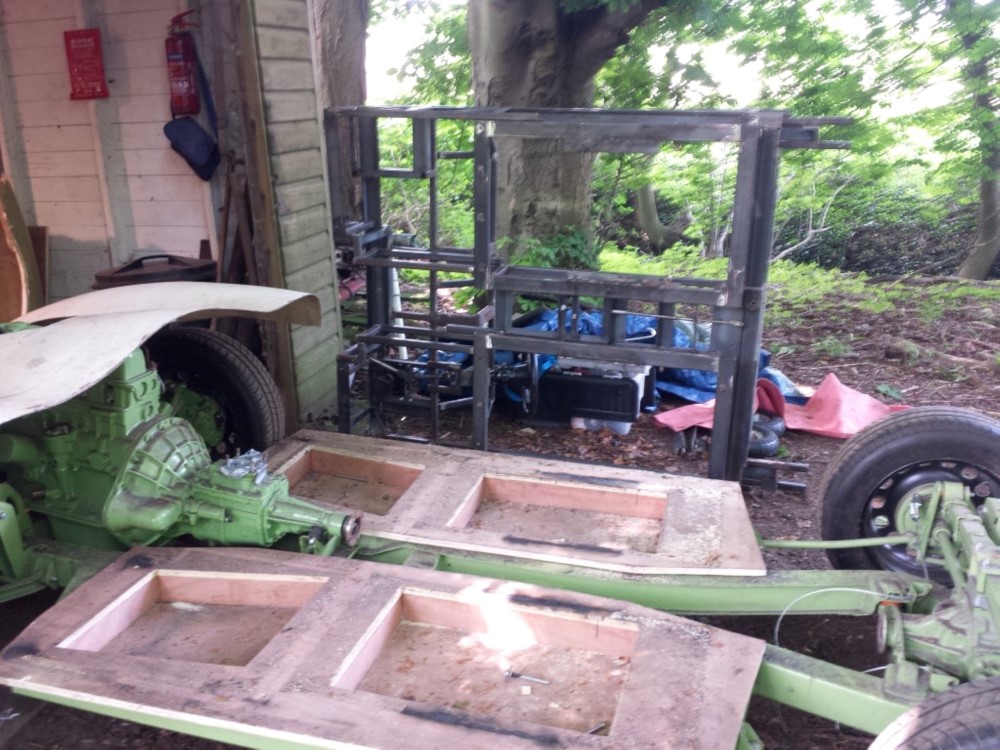

But........the floor was a pain in the arse. The shape made it impossible to get a seat in place that would allow me to get in and out. I tried a lot - I cut it with the intention of flattening it.
After a day or two of p*ssing about, I though, "What am I doing?" So, if anyone wants some new footwell floorpans, they are free for collection.
The new ply floors are exactly as I need. They will be GRP-coated and they will not be load-bearing - they are just there to keep the water out.
These aren't the seats I'm using. They are just to give me an idea.
You can see the semi-spaceframe appearing.

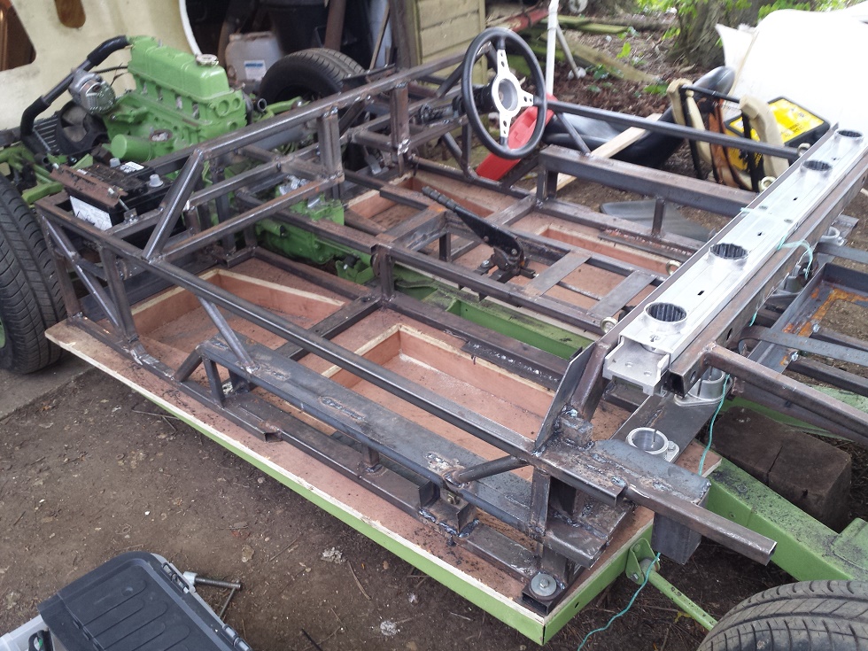

Default Update - Part 2

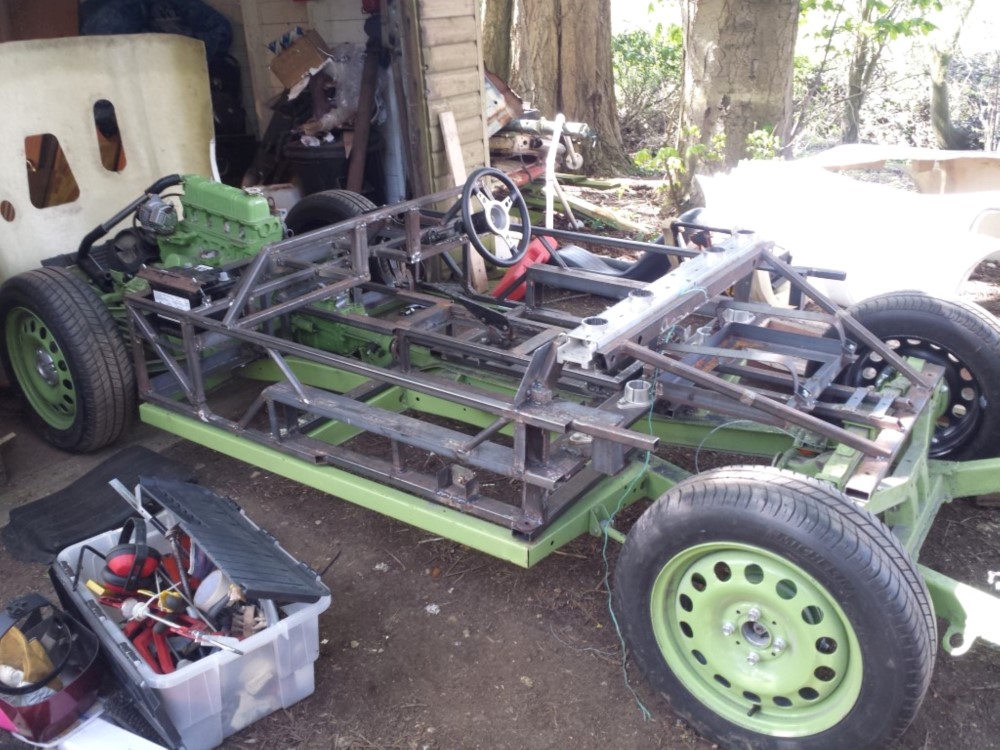

So, I needed to build a semi-spaceframe. I ordered tens of metres of 25x25mm and 25x50mm box plus 25mm and 50mm angle.

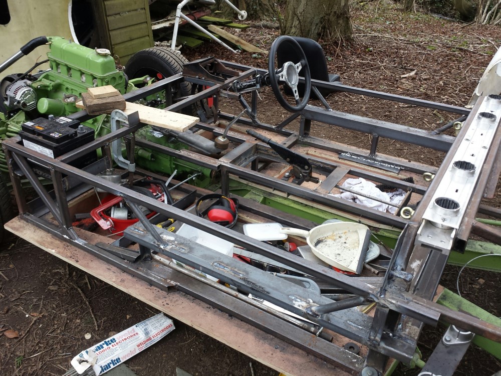

The handbrake is from, er......a box of anonymous spares. Battery mounted above the passenger's feet.

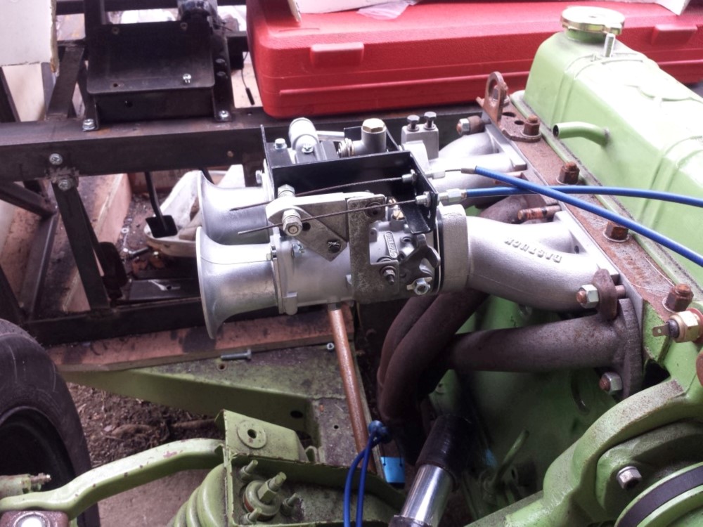

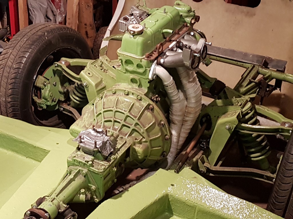

The picture below shows a problems that I will be tackling shortly. I have used standard engine and gearbox mounts.....bot look at the angle of the top of the rocker cover.
The final pic shows the dash area taking shape.
I have dispensed with the Herald pedals - the offset was wrong for the new floor - and I am using a Midget pedal box with remote reservoirs.
Part 3 to follow.

Engine angle not a problem but I believe that raising the rear gearbox mount will level it if that's important to you.

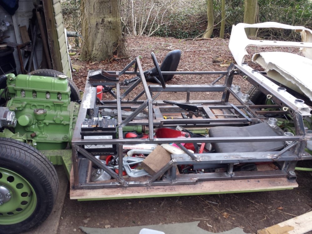

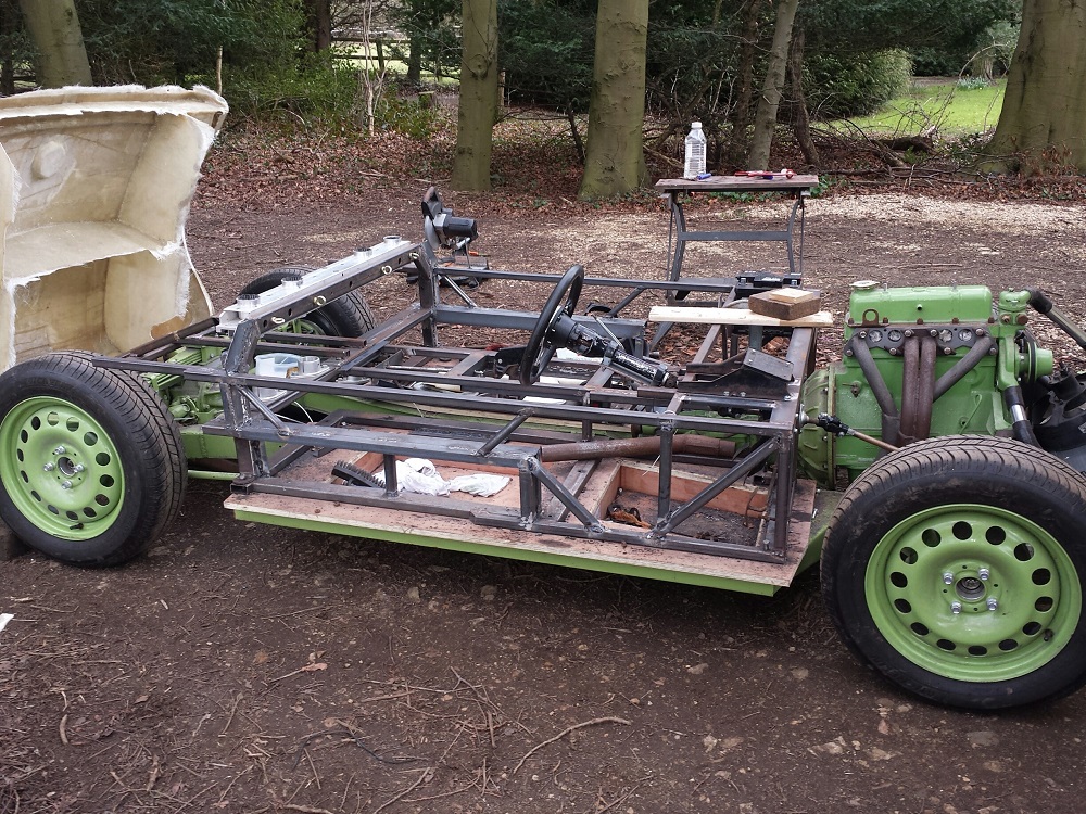

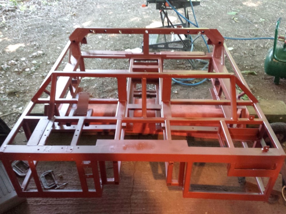

Default Update - part 3

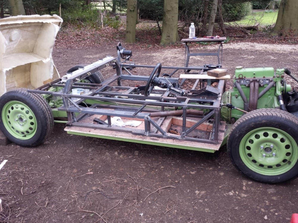

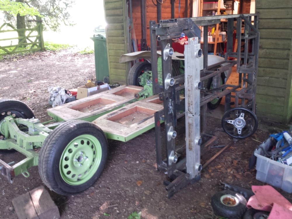

Sometimes you have to maintain morale.......temporary fit....for fun.
Floor off to check alignment with the chassis......
Getting there.....it's the things like lugs to hold the battery and loads of other fittings that took time.

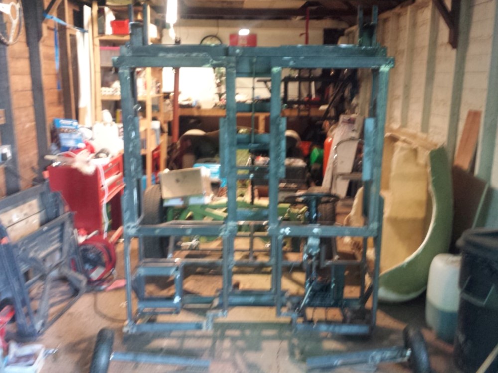

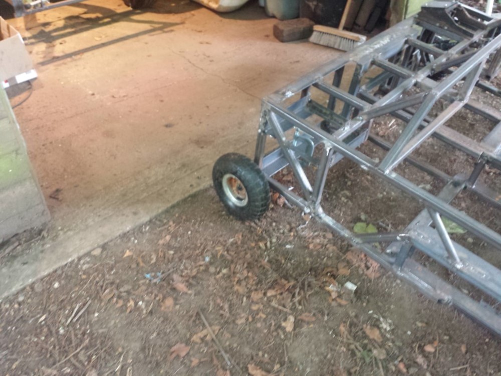

Spaceframe rolled off prior to painting. It's effing heavy as you'd imagine and I have no assistance in the woods.
This isn't a move to smaller wheels - just a solution to moving the blasted thing.
A coat of rust treatment yesterday.......
And, today, a coat of Rustoleum primer.......
The frame will be green.....for a change.
Next jobs........fibreglass the floors.....ali panel the spaceframe (I'm looking forward to that)......get the engine level (lower)......hang the exhaust.....fit the propshaft.........re-fit the floor.....add the spaceframe..........

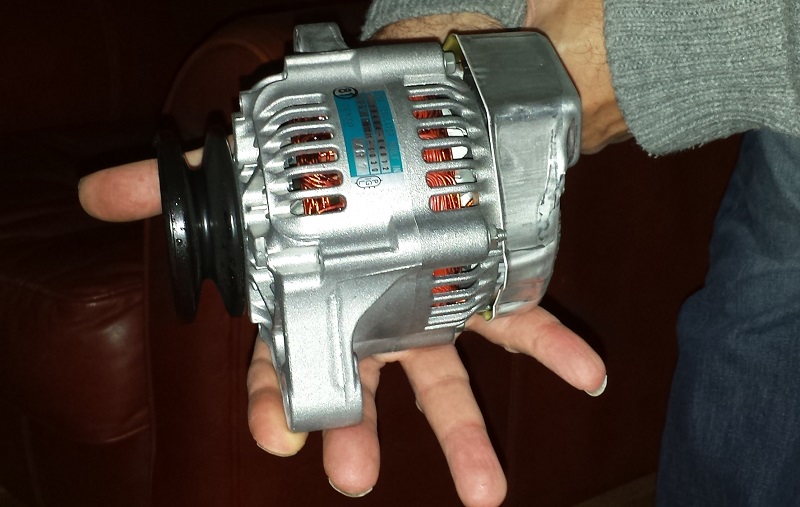

Is that a standard Lucas-type alternator, or a more modern alternative?
Thanks, TS.
It's a tiny Denso -

It looks like you are using throttle bodies, what are they off.
Thanks, Swifty. If the finished car looks anything like as good as yours, I'll be pleased.
It's a Dellorto DHLA 40. I couldn't get the SUs under the bonnet so I went for this solution.

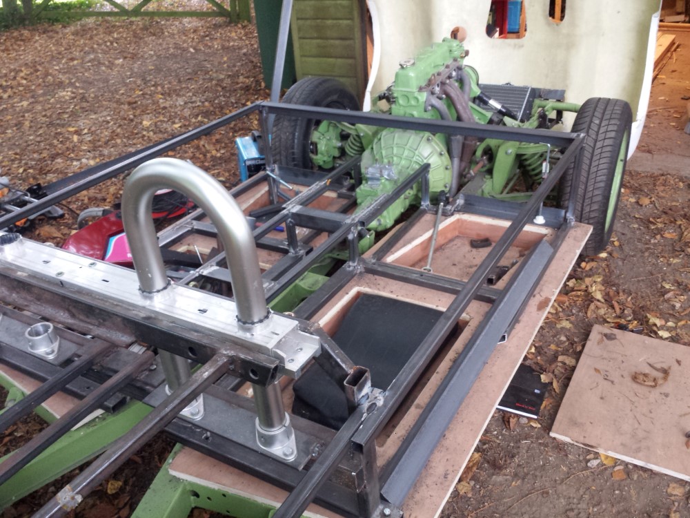

  #540

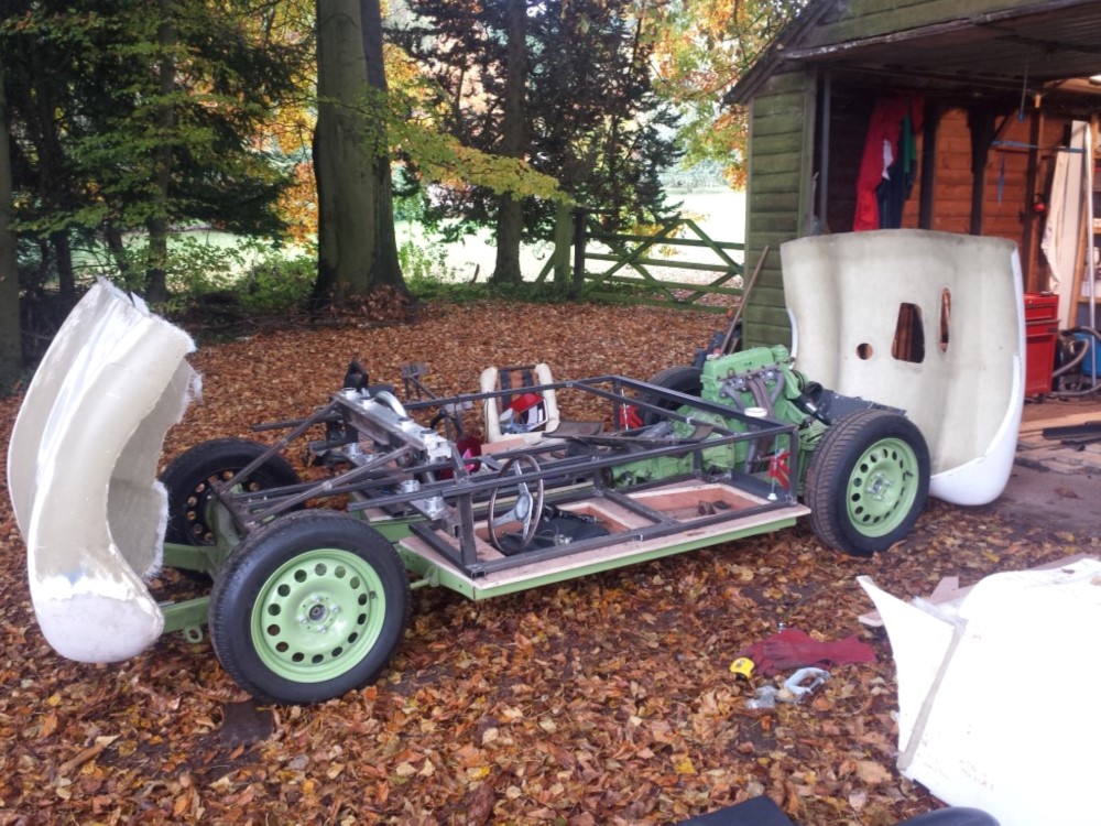

Old 14th August 2016, 21:50

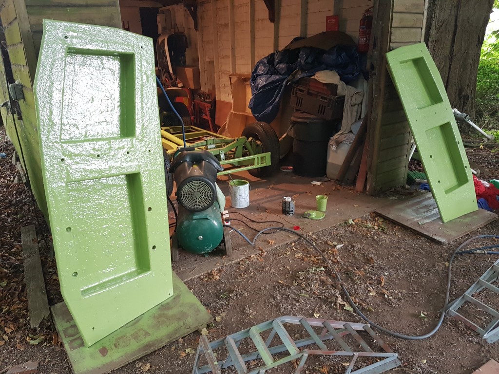

A little more progress......and all progress is good progress.

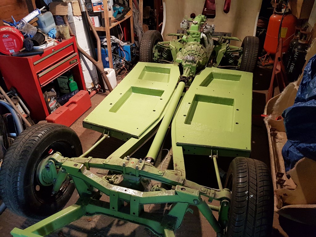

Floors painted -
In place -
Exhaust wrapped and fitted -
Next up, finish full-length exhaust, top-coat the semi-spaceframe and fit it.
The chassis, engine, gearbox and rear end are filthy. A wash might be in order.
