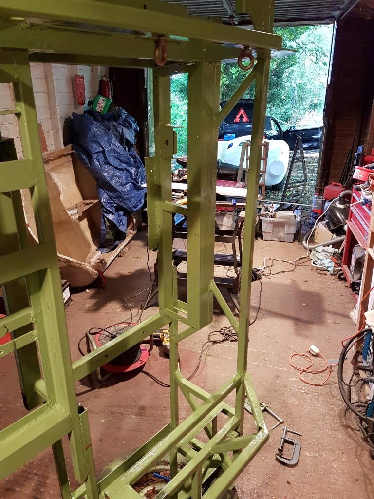

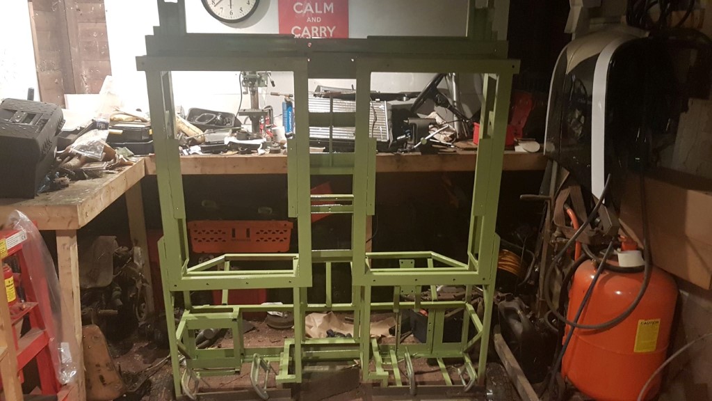

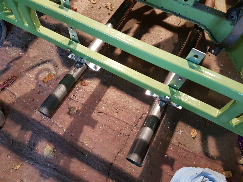

I now have an exhaust that exits out the back.......
.........and the semi-spaceframe is pretty green. Spraying box- and tube-section is effing tedious.
Next job, ali panel the frame. I'm looking forward to that.

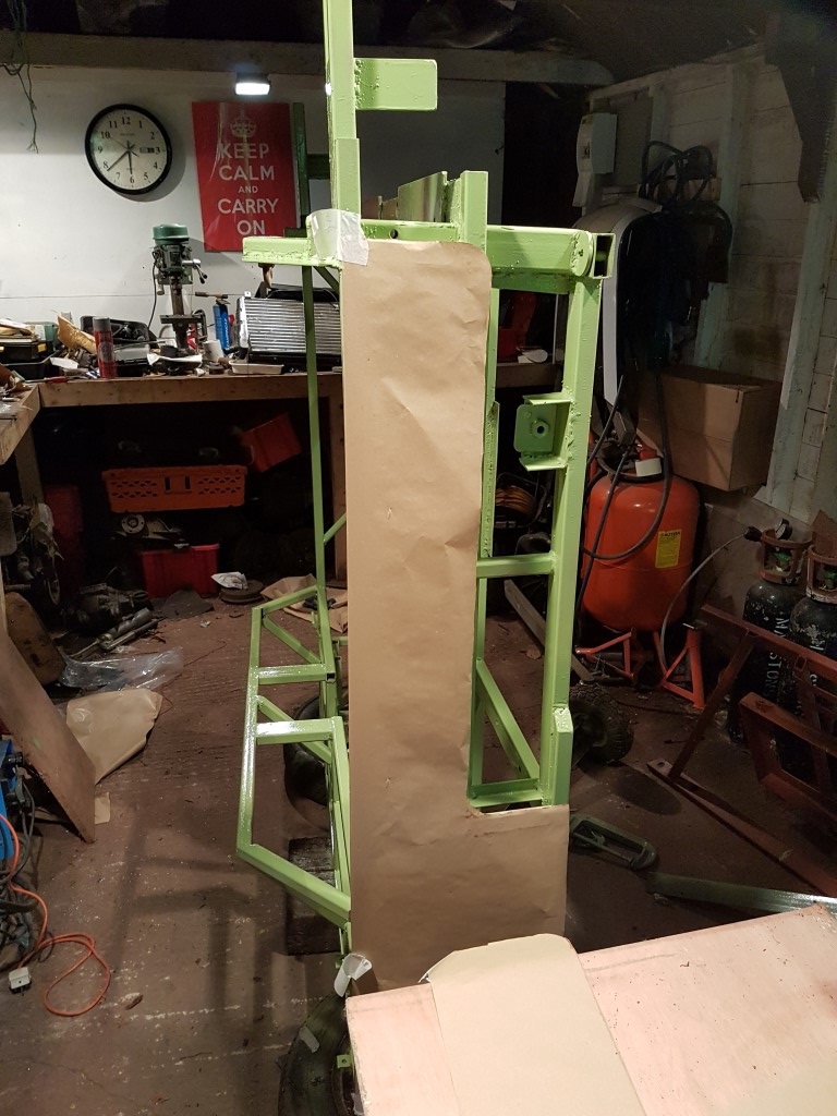

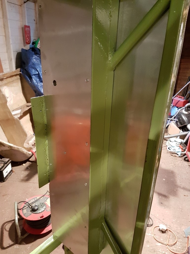

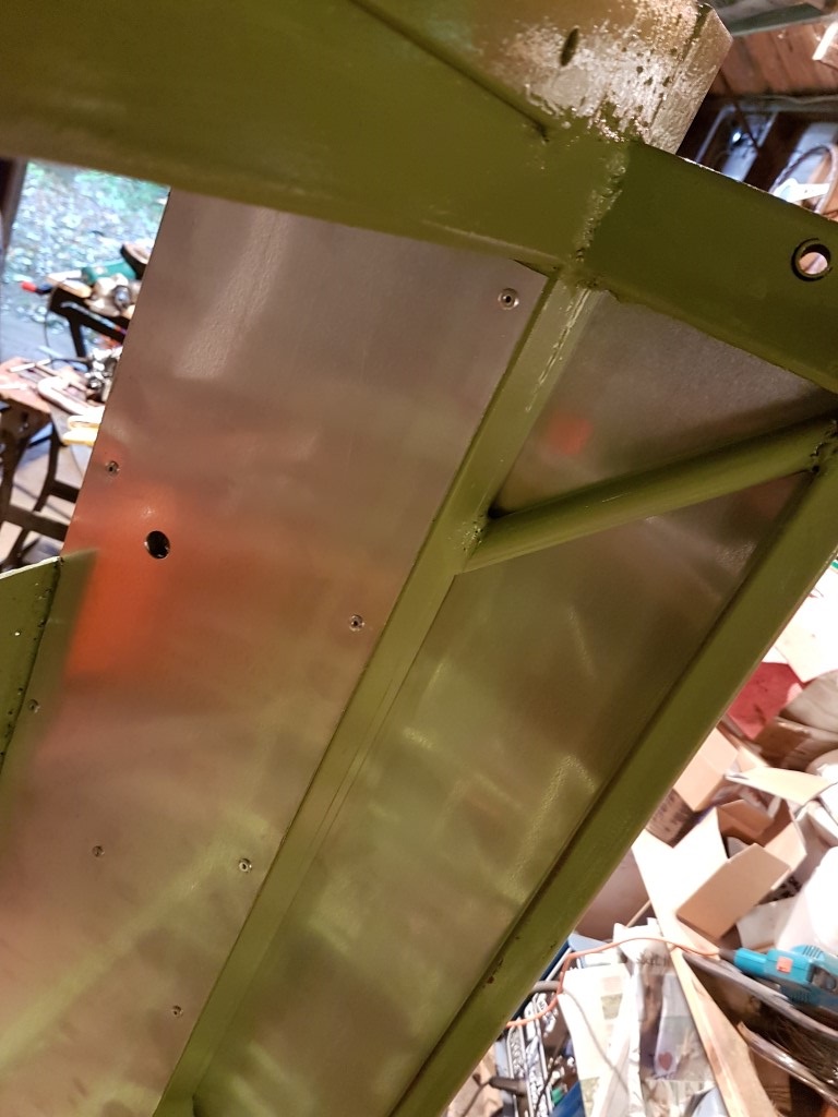

Paul, Charman.tech, Scottie22, Mickey1Mo, Marc F, and Triumph Special – thanks for the recent positive reactions. It does help to maintain morale. With Paul about to be the proud owner of an MOT certificate, I feel rather like that last Giant Tortoise…….

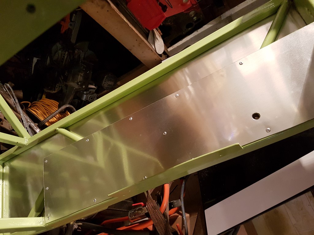

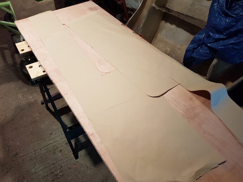

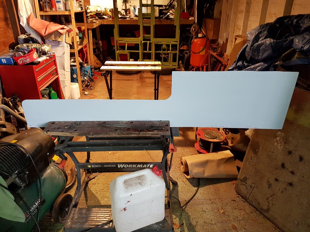

This weekend I attacked the aluminium panelling. I started with some paper templates.
I cut out the panels with a jigsaw, then started to hand-finish with a file.

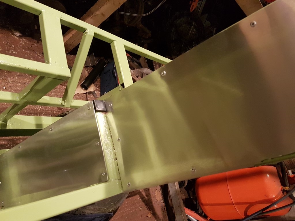

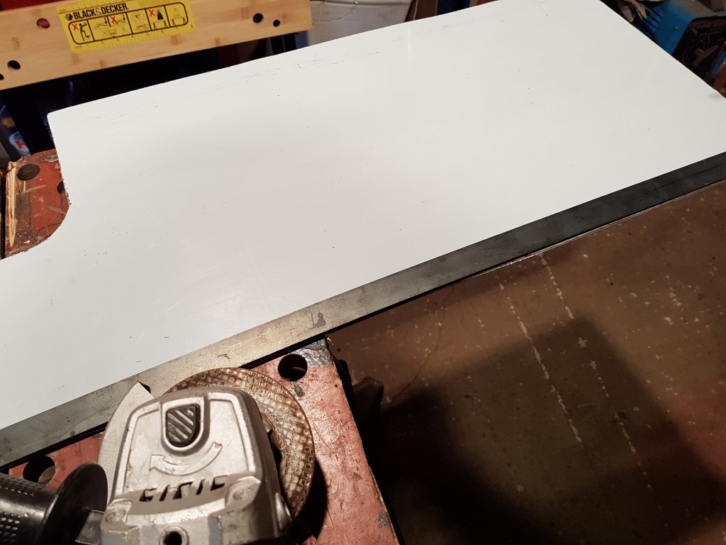

For those where the cut-line was a little wavey, I clamped some steel strap and ran a power tool along the edge.
Some ”before” and “after” shots…..
And a detail shot.
I have another six of the vertical panels cut but not fitted. I need to buy another sheet of ali to complete the front and rear bulkheads. All rather rewarding.

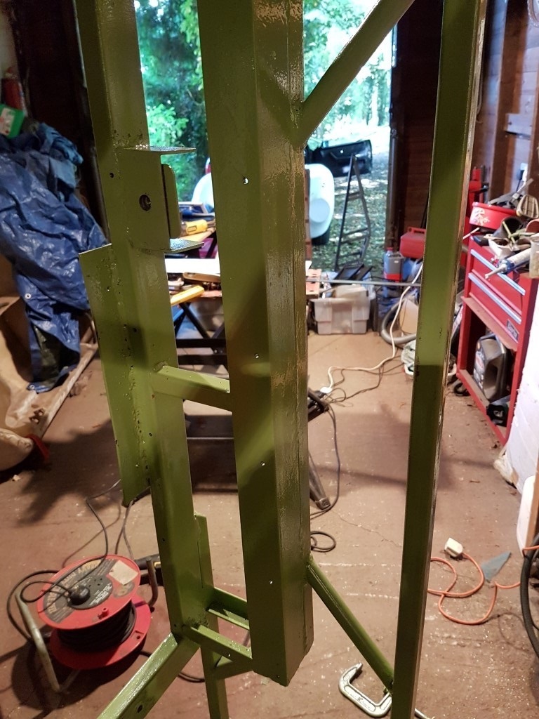

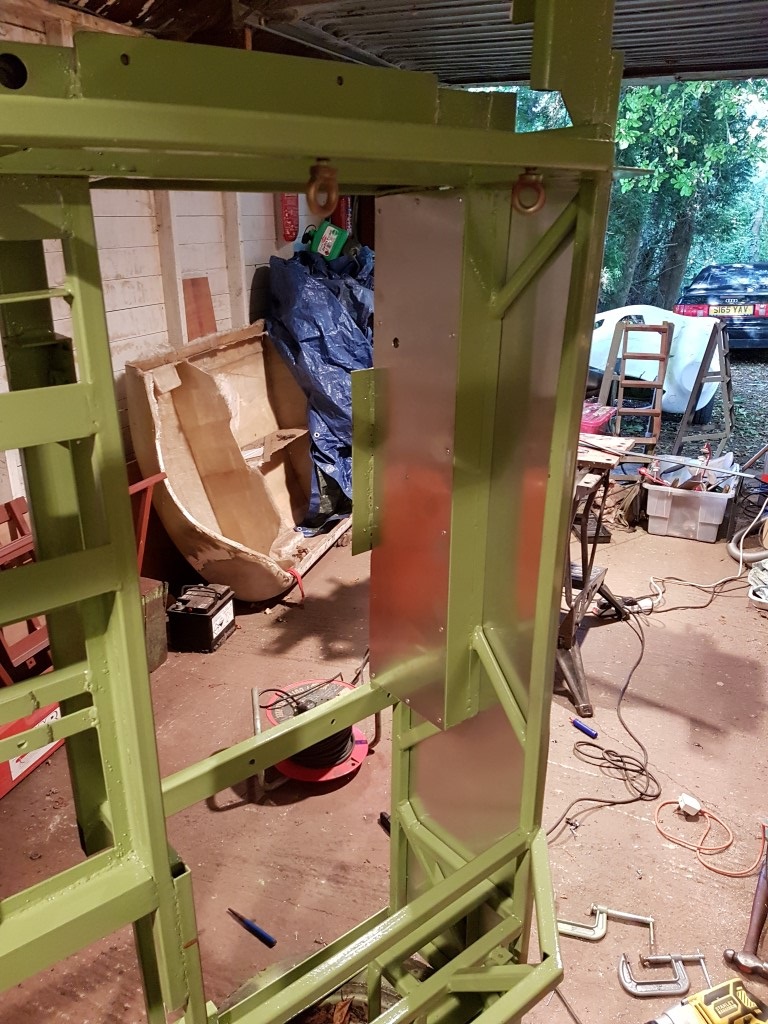

I am trying to achieve a panel a day. Images would be a little repetitive so this will be the final one until I have fixed them all. Another 500 rivets should arrive tomorrow.
All progress is good progress......
The spaceframe is currently stored vertically. This is the passenger side of the transmission tunnel. I am using plastic ends in places to tidy-up open box section. This allows access for Waxoyling. They aren't very period, but they will not be seen when everything that I have planned is in place.

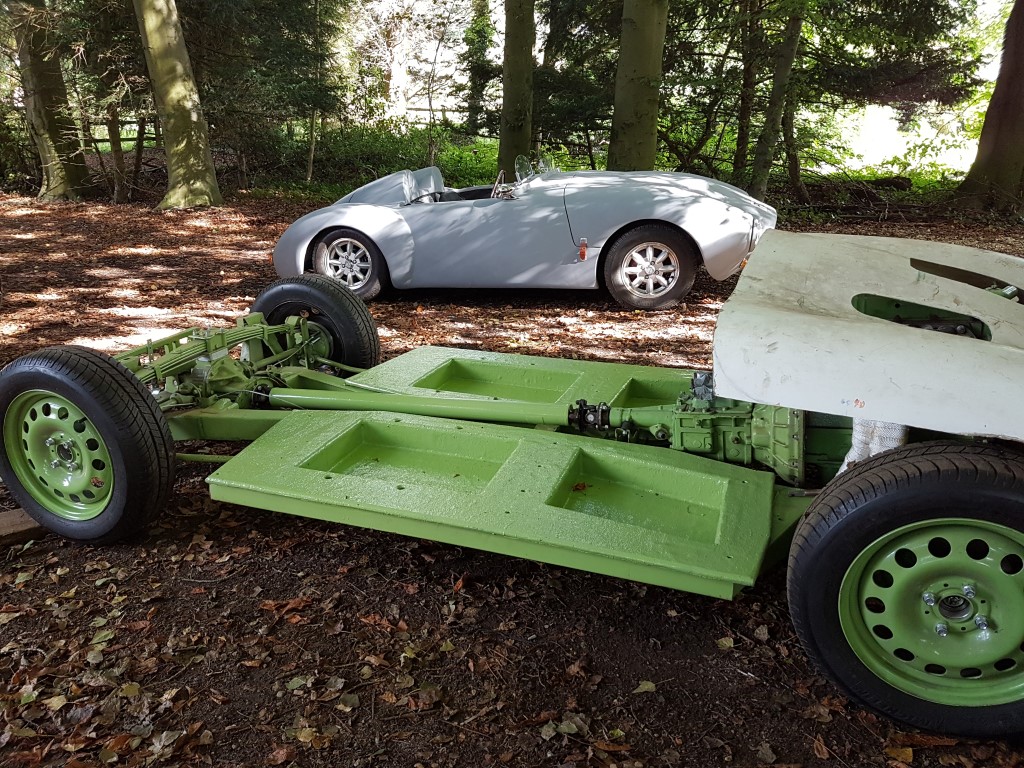

If you go down to the woods today, you're sure of a big surprise......such as a Swordfish.
Paul's efforts have really been rewarded. The car looks even better in the flesh than in the one or two pics that he has posted over the last few years....... It also sounds great.
It handles and feels like an old car (rather than a kit) and it is so solid - all edges and panels are able to bear weight as you get in and out.
Paul and I had a very enjoyable real-time forum chat. At times it was like a counselling session....."Hello, my name is Paul and I built a Sammio."
