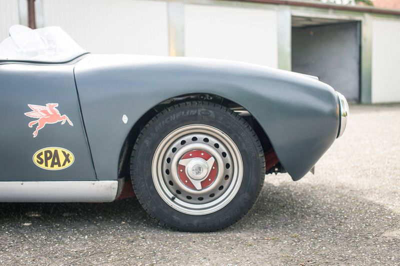

Back to the real hobby (the Miglia) and i have found something worth sharing with any Triumph based kit owner who's fitted wire wheels.
I have had the wheels off the Miglia doing some checks to see how it's holding up after year-1 on the road and i noticed that one of the front wire-wheel adapters had started to work slightly loose!
Now i had experienced that with the Sammio, so i had lok-tighted the nuts during the Miglia build, but it would seem that isn't enough and i am going to have to go down the "Centre-Punch" route!
Has everyone else with wire wheel adapters had to punch-secure the adapter nuts (i.e. the old wheel nuts) Or am i just unlucky / doing something wrong?
  #283
Old 3rd February 2016, 17:40
I loctited my adaptor nuts and haven't had any problems. The nuts are quite difficult to tighten though, you can't get a socket or ring spanner on them, just the tips of an open ended which doesn't help.

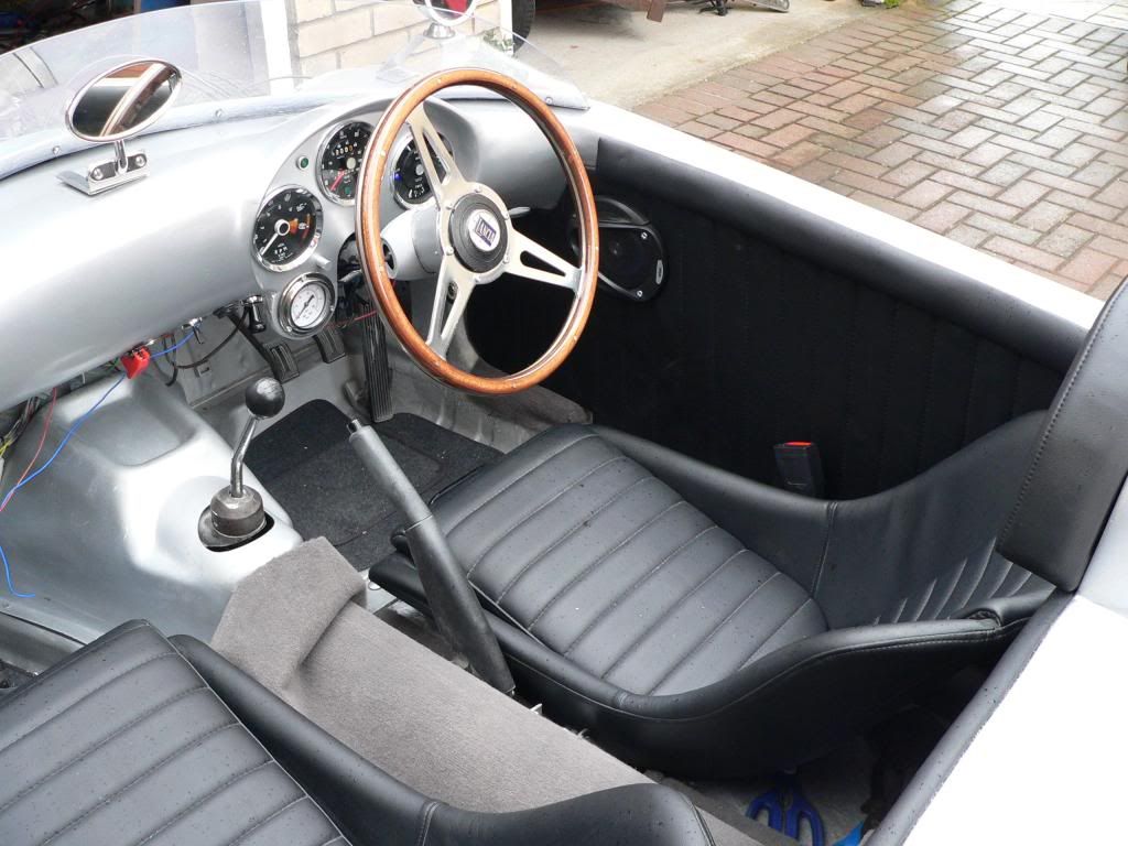

Fit a smaller steering wheel as even though i moved the column position at it;s first MOT, there still isn't much space.

Congratulations on reaching a year on the road. Nice to see you've kept this one. How do you find access with the doors? Is it as easy as jumping over the side and is there any particular technique needed?
Try a 14" wheel to replace your Vitesse ship's wheel, I got mine from the MGB hive for £99 including the boss adaptor. Not sure if they still sell them, but the wheels are available from other sellers on ebay -
http://www.ebay.co.uk/itm/Classic-Ca...gAAOSwe-FU~wuX
  #286
My experience of little roadsters or low cars is you tend to step in anyway rather than contorting yourself to use the doors.
I am working on a D type at the moment and the doors are quite pathetic really but the barrel of the body forces you to use them ...The Sammio/Miglia option is far easier to access !!
  #290
Old 8th April 2016, 11:43
Yep, I find it's all part of the theatre stepping over the side Le Mans racing start style, but I have a feeling that when I design my own car it'll have perspex side screens and, unless I don't mind kicking them off every time I get in, that means having doors.

Hi Dave fit a quick release s. Wheel

Me to likes the head lights, fitted p700 to mine, they do give it a period look and add to the illusion.
As already suggested may be a removable steering wheel is the way to go, you can modify the original cast alloy boss to suit a new wheel, i did something similar for my removable steering wheel, http://www.madabout-kitcars.com/foru...t=4861&page=32.
