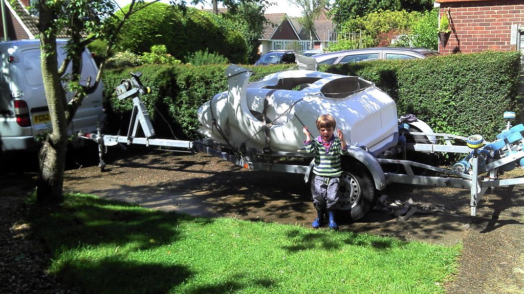

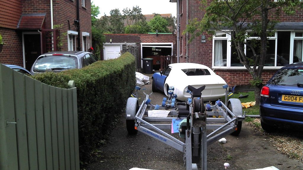

About the end of August I picked up body number 15. It was the first 'de-vented rear plus jag nose that Chris had done, as was my preference.
Picked it up on a trailer, I think the two bits snugged together are about 6 1/2' long by 4' high.

The boy is happy, even though he is not sure what it is.
'Daddy, we have got too many cars'
Yes son, You may have a point!

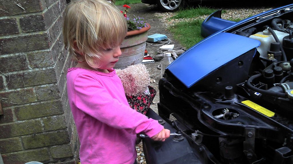

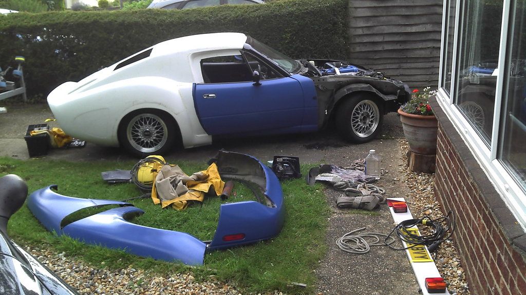

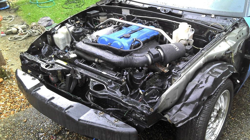

I had spent a few evenings removing bits from the Mazda, and bit by bit they were selling on Ebay. By the time I collected the body on the saturday I only had the rear bumper and front wings to remove......so sunday saw 'driveway chaos's...
Had some help 'Daddy I need a 11mm'

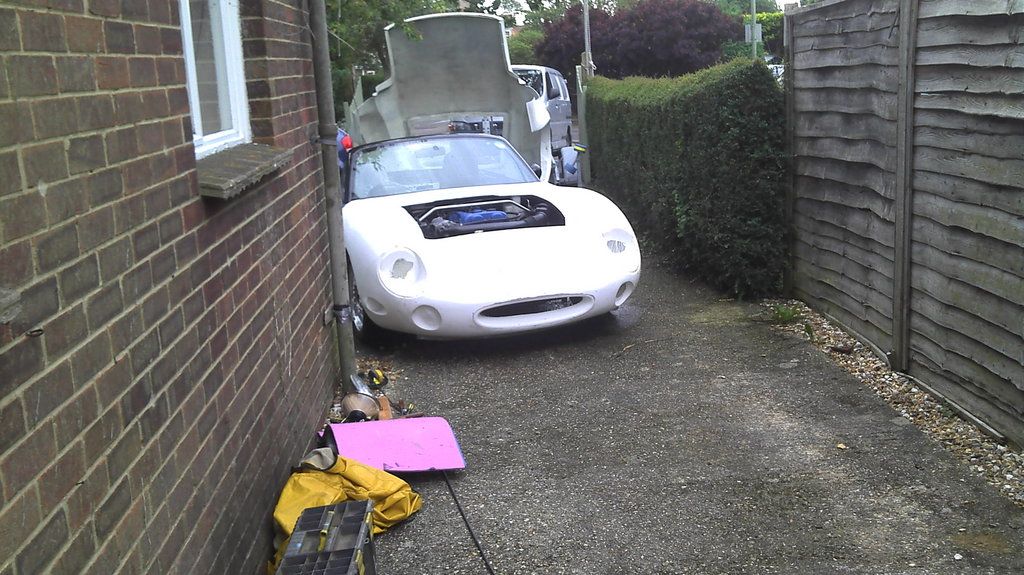

AUGUST
It seemed the safest place to but the new body was on the car....

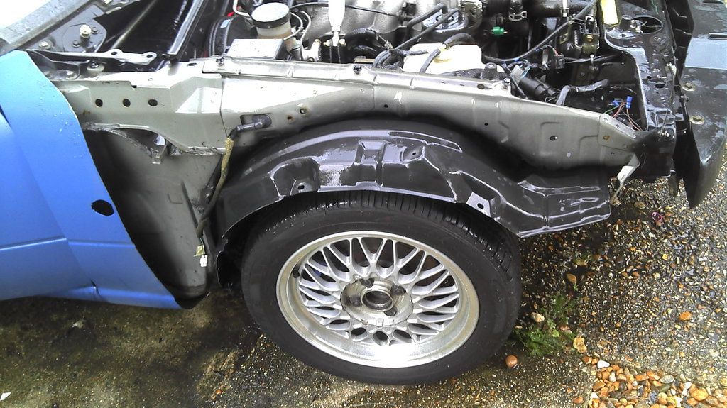

[IMG][/IMG]
After trimming the wings back I pressure washed all over. No rust anywhere! Its like new. I shall spray it all with waxyoil whilst its easy to get to.
[IMG][/IMG]

A good distant shot showing the front end.

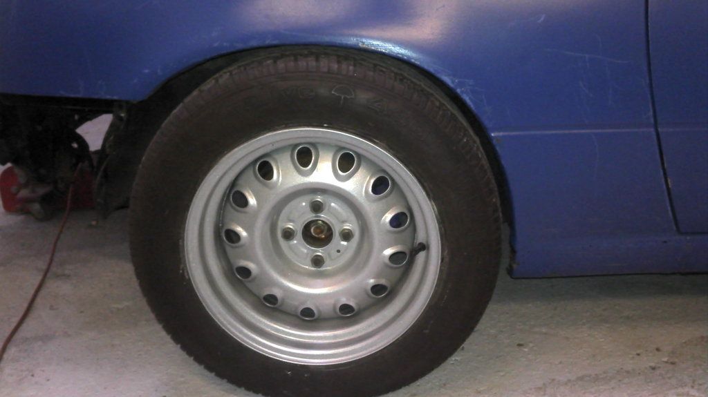

At this point, about mid August, I decided I wanted to source and fit the wheels before bonding on the body.
And so began the hunt for the perfect wheels.......
Some were too wide.....at 11"
some too big....
[IMG][/IMG]
Some too small...
Old 25th October 2012, 21:53
seanick's Avatar
seanick seanick is offline
Posts: 810
After spending a month of evenings searching fleabay, piston heads and Gumtree I gave up. By now I had sold the BBS Alloys and the car was on bricks. A mate leant me some 13" corsa wheels for the rear which look cool fitted inside out, even if very silly!! A spacesaver on the front and an Astra sport steel wheel completed The Look!

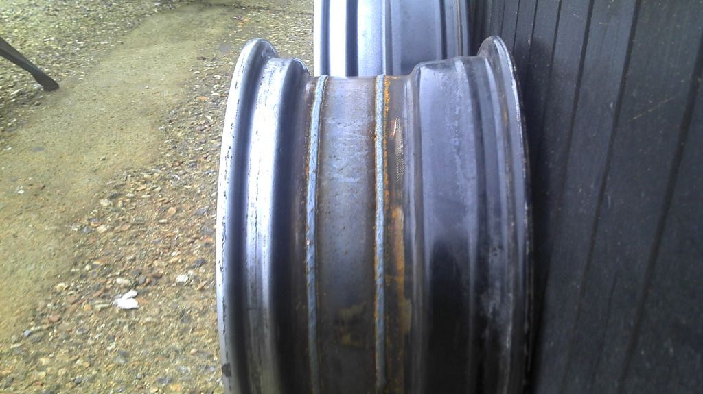

I then decided to go for steel wheels, but banded to get the size I wanted. I contacted a set up up north with a nice website and they agreed to source vauxhall wheels, band them, shotblast and spray them. However after four weeks nothing had happened, due to the owner having an accident on his bike. Eventually I received a refund, then began to search for someone else to do the job. Found the wonderful James on some forum, who offered to do the job.

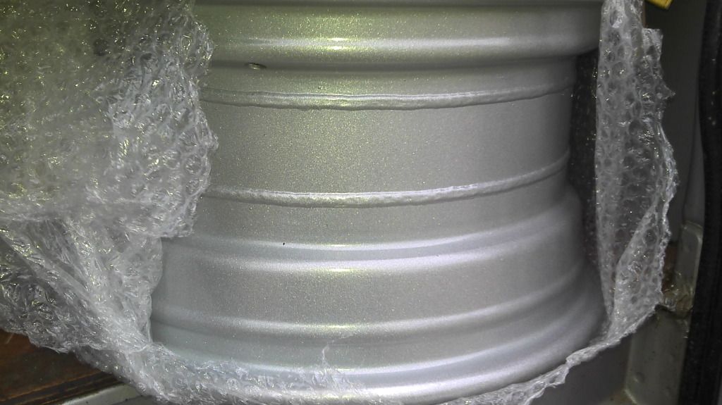

I found a perfect set if Mk1 MR2 Wheels which I sent him.the rears to have a 2" band fitted. Picked them up last weekend.....a perfect job. This is what your mit welding should look like folks.....
[IMG][/IMG]
[IMG][/IMG]
I LIKE THEM!
They will have three eared spinners and nice tall tyres!
These are one fwd and one banded rear.
I get them back from the powder coaters tomorrow

Very nice wheels. How much did he charge to band the pair?
Old 25th October 2012, 22:22
seanick's Avatar
Posts: 810
£50 each. Rims parted on a lathe, band added, all tacked up and checked for run out before welding fully. The welds are what I call gas bottle quality.

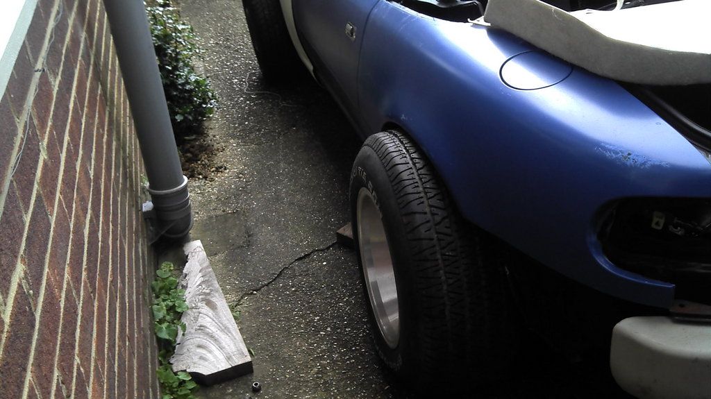

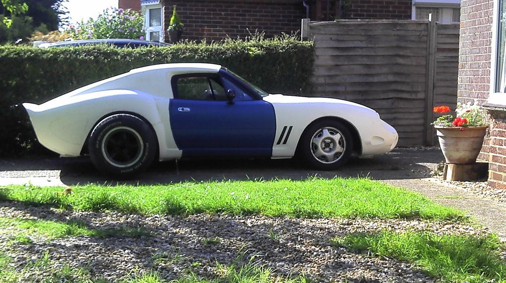

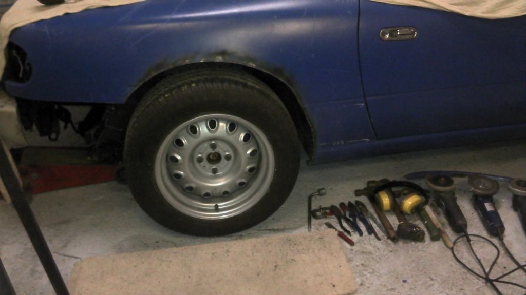

Finally got the new wheels on, and drove it (dont read this Towed) to the workshop. Front body held on with ratchet straps, and rear suspension held up on wooden blocks so the tyres clear.
Got one wheel arch cut out and welded back together. Hope to do the other one tomorrow.

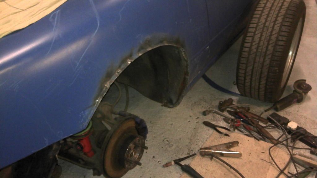

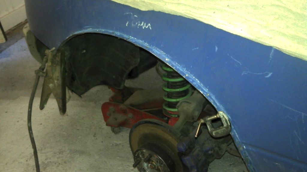

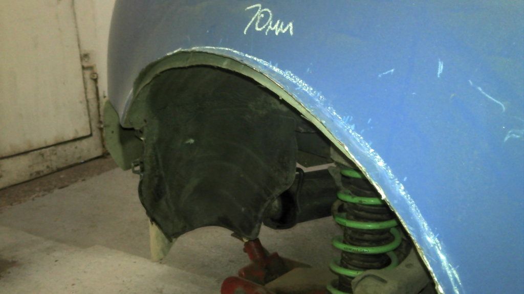

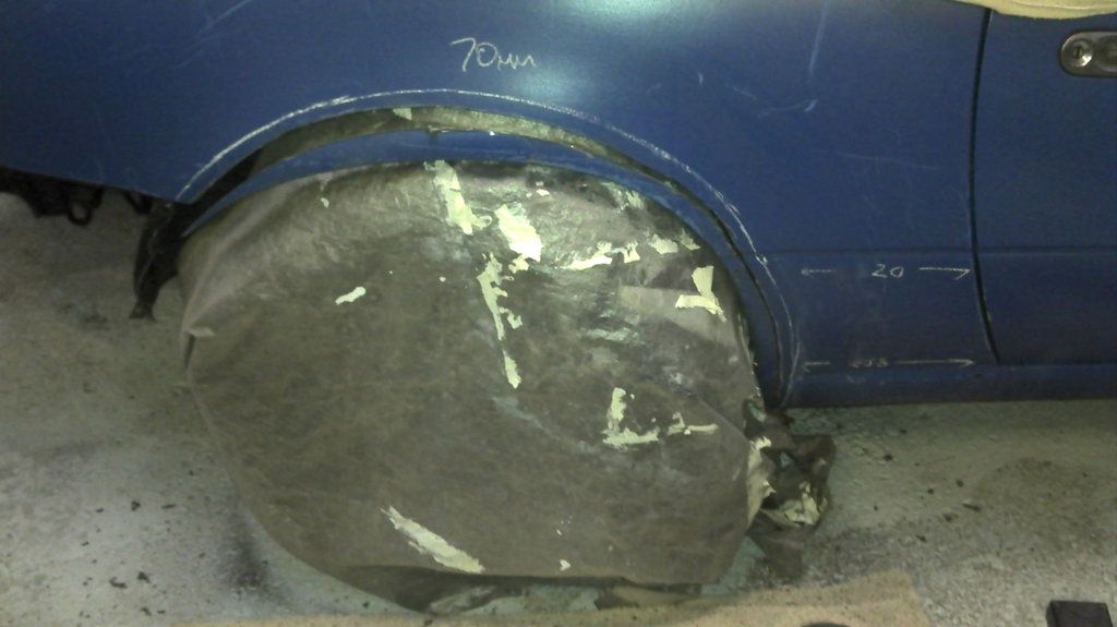

Got down to the workshop for a couple of hrs today and tweaked the rear arch. Because my mc is lowered by 40mm and I like large tyres I am having to tweak the arches.
You dont normally have to do this on Tributes kit, its just me!
Heres the issue.......
[IMG][/IMG]
only 10mm of travel.
[IMG][/IMG]
Chopped out with a grindette
[IMG][/IMG]
working a new flange out the other way[IMG][/IMG]
Both inner wing and outer now flanged together and drilled for plug welding
Finally welded back together
[IMG][/IMG]

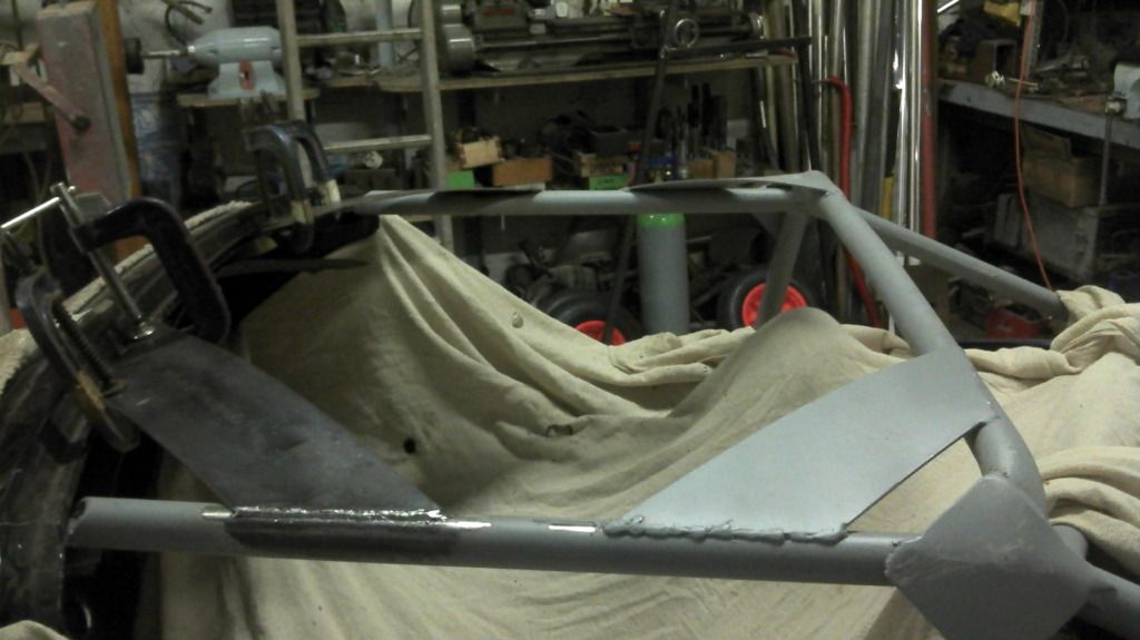

I have added the roll cage braces to the screen. Again this is a deviation from Tributes design, but I wanted to maximise headroom, so came up with this:
the front is bolted with 5xm5 s/s bolts. [IMG][/IMG]s/s hex heads, so no welding near the screen
