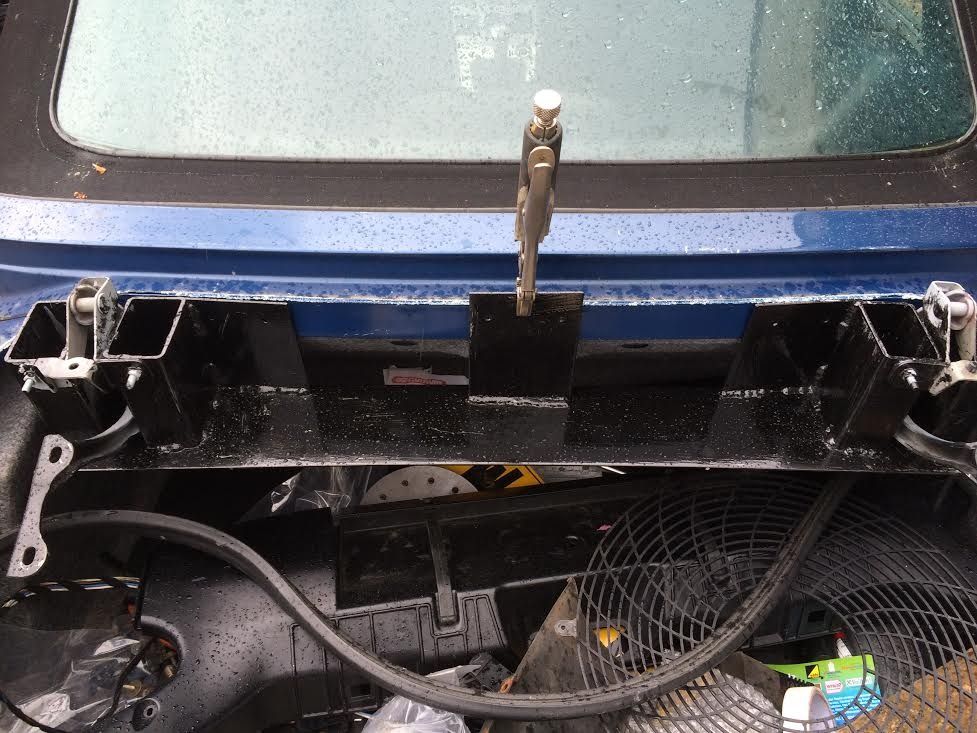

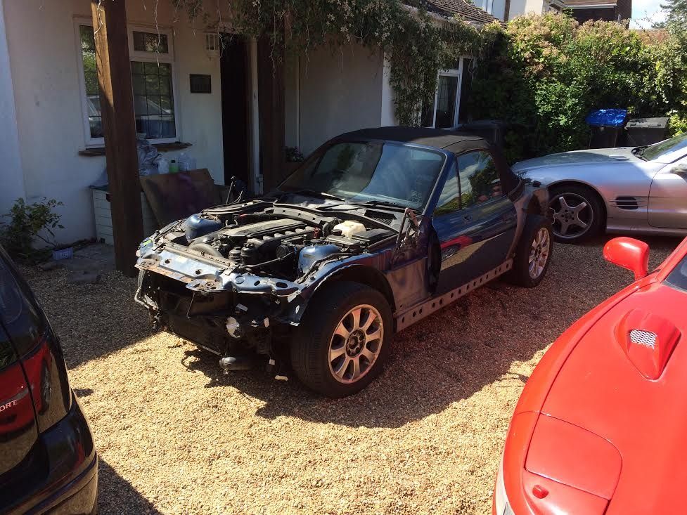

Strip complete and it took 4 hours to get it done. No problems, very straight forward. Collecting the kit from Chris tomorrow morning.
I expect the first job will be to fit the boot hinge assembly, I will take some photos of this as I don't think it has been covered before.

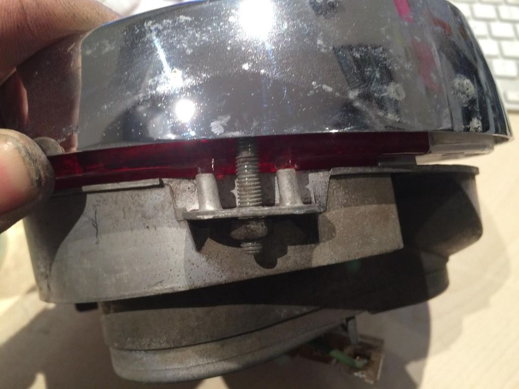

The bulbs are just standard single filament 21w bulbs, the same as you find in a standard indicator or sidelight, very easy to find.
If you look at the pictures you will see the mounting threaded bar, this will unwind from the light fitting and I was going to replace it with a longer threaded bar so that it went straight through the fibreglass, that way you just undo the 2 mounting nuts and you can remove the base from inside the car to replace the bulbs. Fit with LED bulbs and the chances are you will never have to replace the bulbs.

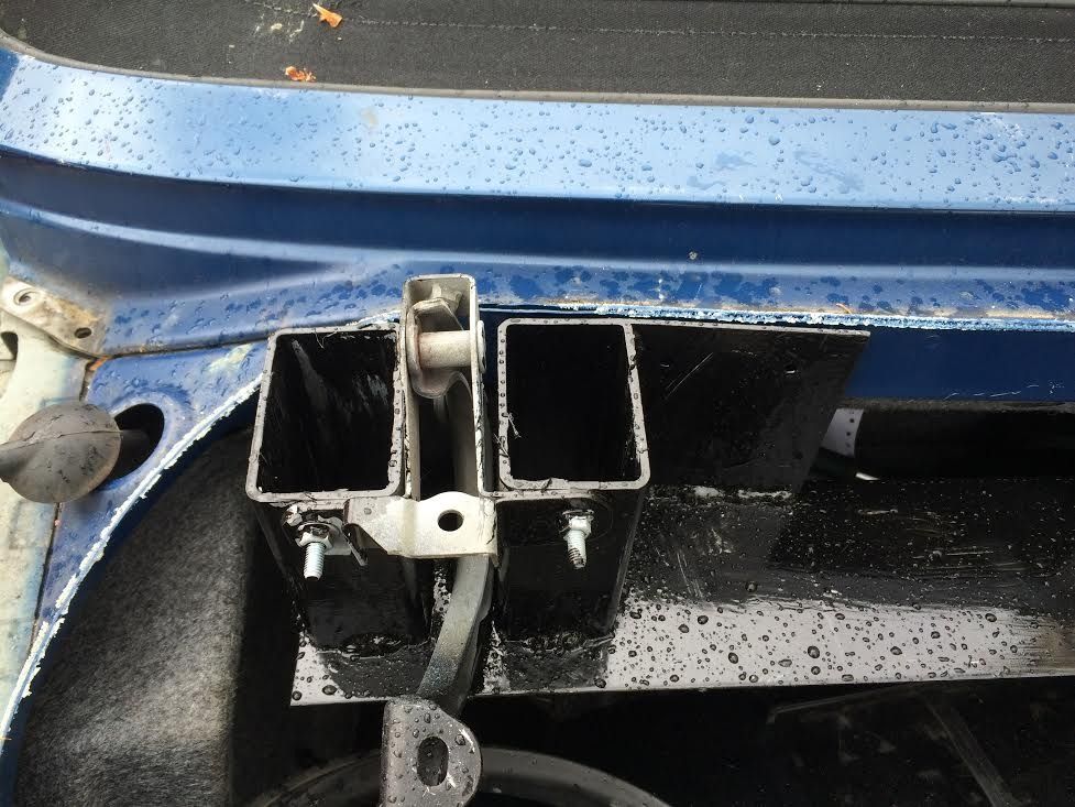

Default Fitting boot hinge assembly
At last something that Eric hasn't covered!
Chris had this already attached to his mule when I collected which was a great help. Very simple to fit, keep the outside two uprights level with the boot lip and central then grip with a pair of mole grips. I then levelled it up with a spirit level, or the modern version off, there is an iPhone app for a spirit level, it is free and very useful.
Once gripped just drill through and attack with self tapping bolts, it really is as easy as that.

Fitting the hinges took less than 15 minutes, I can imagine how long it took to fit the outside hinges, lots of fiddling getting the measurements exact. It does look more like a production car without the exterior hinges.
