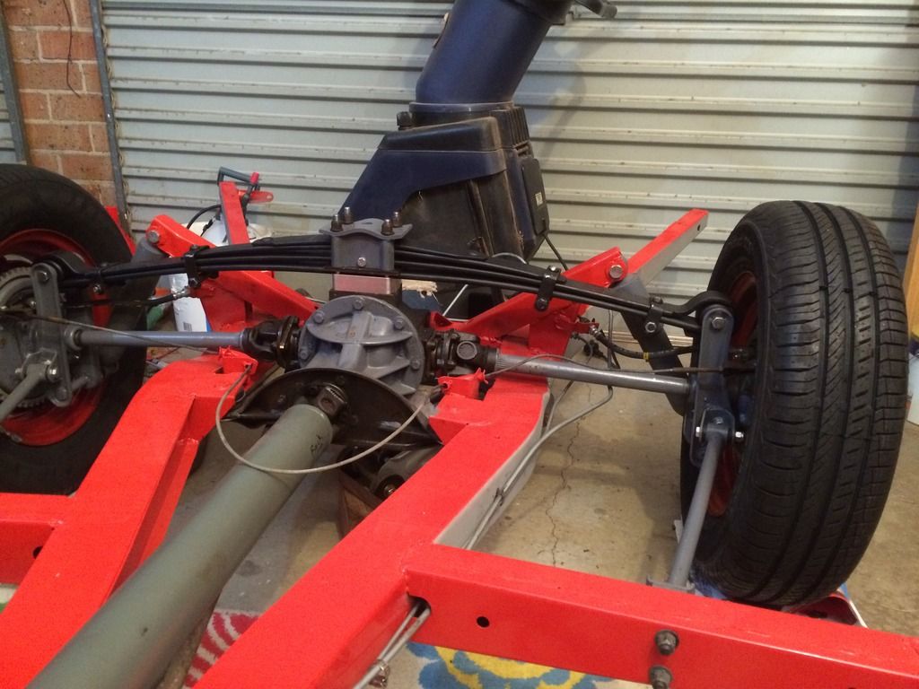

Lowered a bit. The rimmer block (which I think they get from canleys) is a tight fit:
It needed a bit of persuading with the persuader.
But got it in the end. Eagle eyes may notice one less leaf. It's a guess, but from others comments on the rear being a bit stiff. We'll see how it goes.

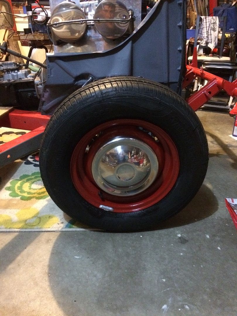

love the two tone chassis - hadn't noticed that before

The grey is an impact resistant thick plasticky paint I put underneath to protect the powdercoat from stone chips. Looks alright too!
The tyres are 175/70R13 and don't foul anything even on full lock.

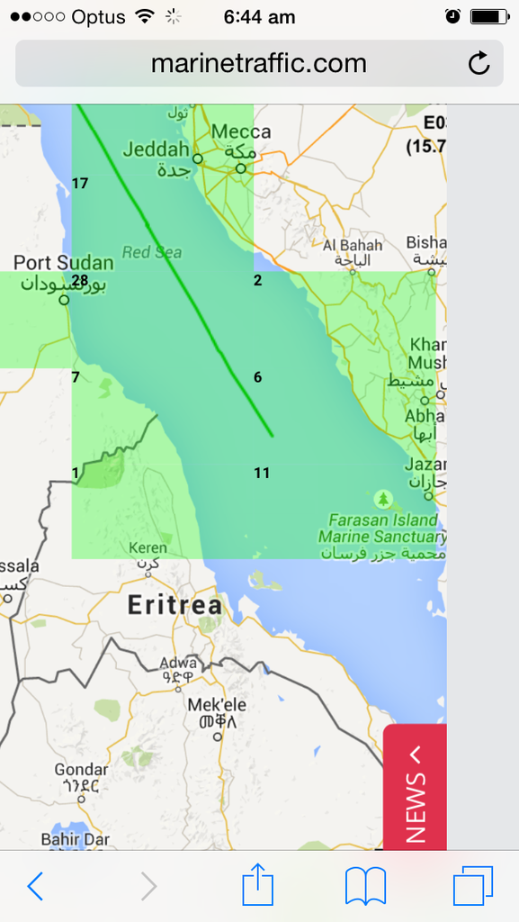

Do you have a map view of your container, in the same way you can track a plane on its flight path?

Do you have a map view of your container, in the same way you can track a plane on its flight path?[/QUOTE]
Yes Paul (and thanks, too! I may go mini lite eventually but I want to see the results with the coloured wheels first)

I think removing one leaf may be a good idea for ride quality, just keep an eye on the Swing Spring as it settles, as mine is already a bit lower than when I'd finished and Towed found a great photo comparison of my Sammio build with the new spring fitted and then after 12 months and the height difference was quite visible!

Thanks Dave. I'll certainly not throw the leaf away! And thanks about the drums- not many people can saw their car has the pinnacle of brake technology on the car! (Drum brake tech, sure, but still the best and way cool looking) also with "settling in" anyone who's taken the rear hubs off please check the nut at 5 and 10k miles

The cargo ship tracking map is great.
