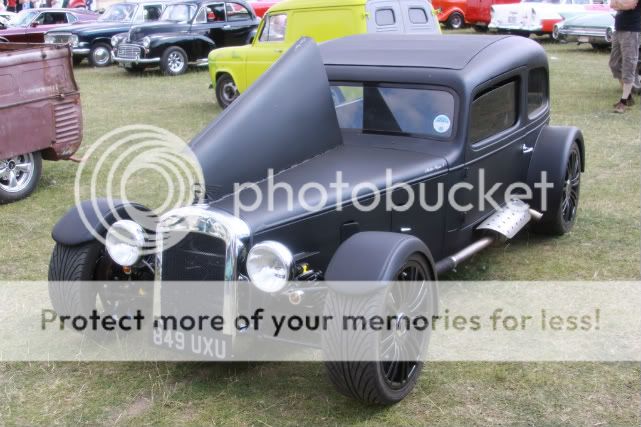

Just picking up your point about using other kit cars as a base…
I've seen a few examples on Rods 'n' Sods, where something like this:
Has been turned into one of these.
Or one of these.
