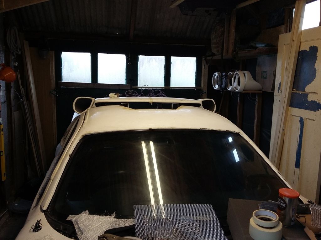

I've been working on my roof scoop for the past couple of days. Here how it currently looks. Very pleased

looking good Nick,
that lamp pod needs sorting though no good on the shelf

who sat on the roof !! you need to lay off the mince pies
