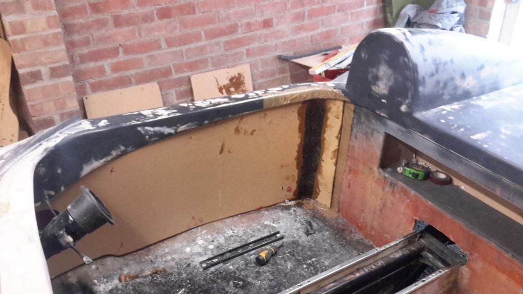

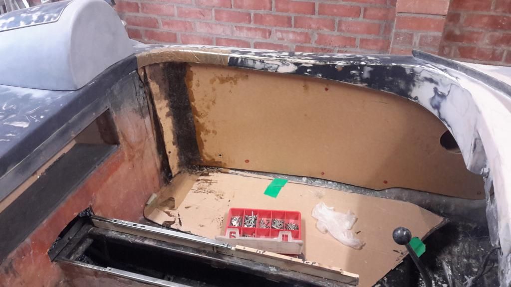

thought id push on with some interior work. handbrake cover
side lifts to reveal switches
Gear box tunnel covered in 6mm foam
started to cut out leather but quite a complex shape

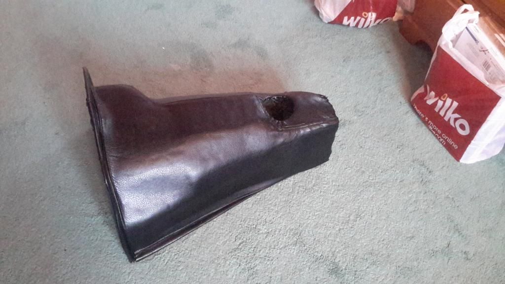

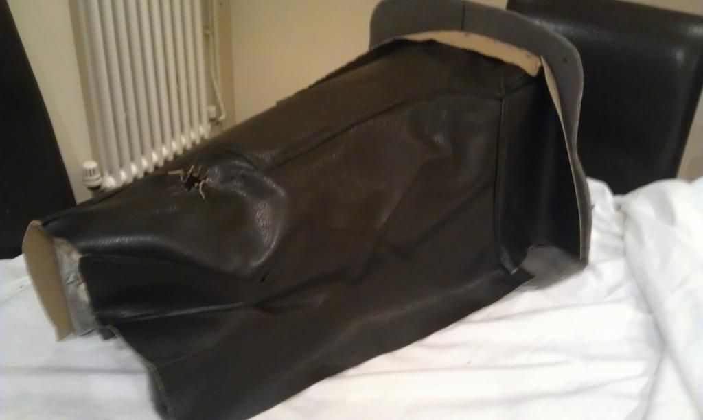

with 9 pieces of leather the pattern I made came together really well.
trim bond sticks so well you cant pull it of the foam.
also bent some hard board for the corners and joined with fibre glass to keep the shape
and left side
and finally added some fibreglass to the right hand wing to match the other side

Nice job trimming the gearbox cover 'Noob, they're a bloody awkward shape.
I'm a bit concerned about your inner side panels though, are they hardboard?
I can see you're trying to maximise interior space, but without solid, 6mm ply inner panels bonded right up inside the shell and extending down to the floor it's highly likely that the body sides'll flex and crack when you put your weight on them getting in and out.
I say this because I have a small area in the centre of the scuttle panel just ahead of my flyscreen, directly above the servo I fitted, where there's no bracing, and it started to show stress cracks from downward pressure from the bonnet closing above it. I had to replace the rubber strip with a thinner one at that point to stop it cracking any further.
Good luck and keep up the good work!
  #146
Old 9th November 2014, 14:33
CarNoob's Avatar
CarNoob CarNoob is offline
Join Date: Sep 2012
Posts: 189
CarNoob is on a distinguished road
Its ok the sides are 6mm ply bonded in with fiberglass, I also ended up cutting out the sections I push on when getting in and out as I could hear movement. I added 6 layers of fibre glass then bonded the top piece back in now its solid. The pieces I have cut are for the foam and leather to stick to. I want them to be removable.

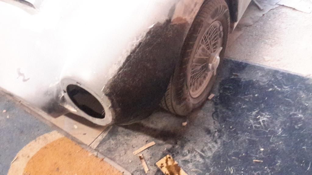

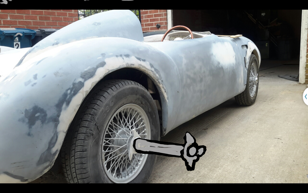

Keep chipping away. Now I under stand why spraying a car cost so much. Preparation, Preparation
I would like this finish

The prep-work is well worth it. Looking great with all the personalised detail. What colour are you going for?

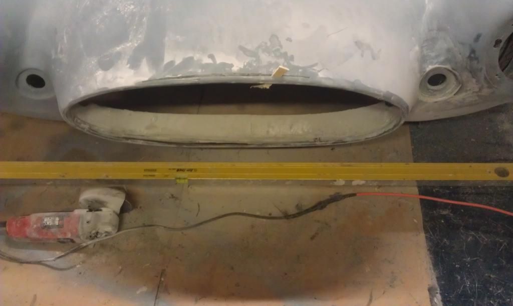

Yes what can I say. There will be a glass screen that lifts out. I'm hoping to make a hard top and the glass will lift up into this. I have made the frame and motor and it works with a mdf template. This will be changed for glass when I have figured out how the springs push two pieces of glass, to fit the two humps when it goes up/down.
Other ideas spring to mind!

colour is going to be gloss white from Jarwel. I did look at silver birch to go with the bond theme. which I now regret as I did a sample piece on the car. I thought I had removed the paint but discovered after priming the paint reacted in a couple of places so I've had to rub one section down again yesterday.

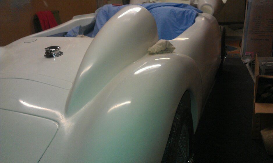

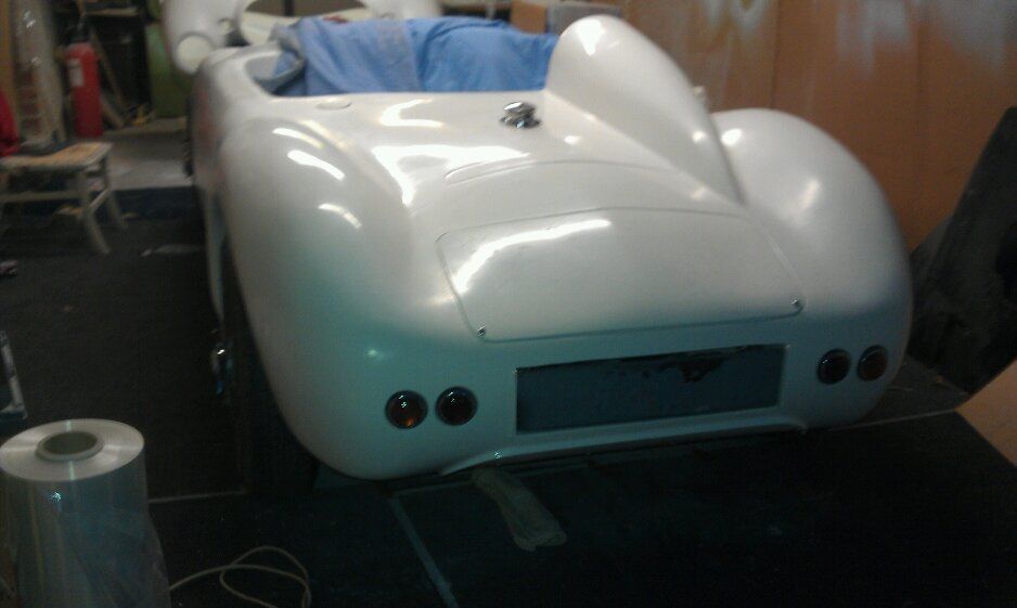

Finally Painted Jawel Pure White Gloss, Just need another ltr to finish under the bonnet.
The back end really bugged me so I made a section and pop riveted to the bottom. Now nice and even.

That looks great
All that prep and your loss of fingertips was worth it.
Did it go without a hitch?
