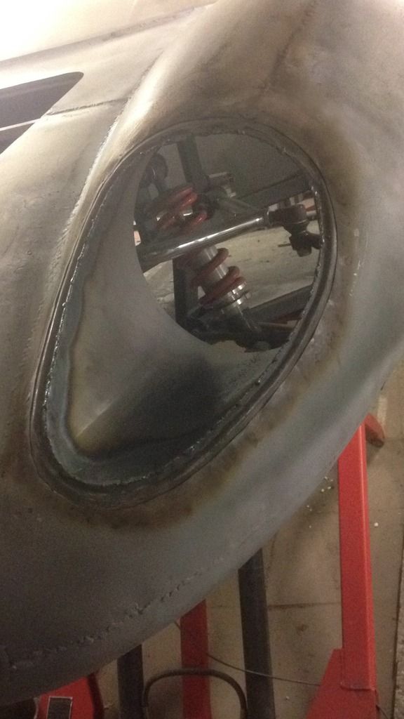

Here is the pieces I did for the headlight area with an offset, it has the benefit that I can use the cut out piece as a template for the plexi headlight cover...
and a corner for the front airintake- a lot of stretch in the flange:
and checking the symmetry, not to far off considering I did not use a wooden buck, it is all done by photos and 100% handbuilt..

Another part of the airintake, I used the same handtools to shape it. Something happened to the flat surface with the round flange but I solved it with shrinking to flatten it again.
welded in:
o/a welding the corners and the flat part

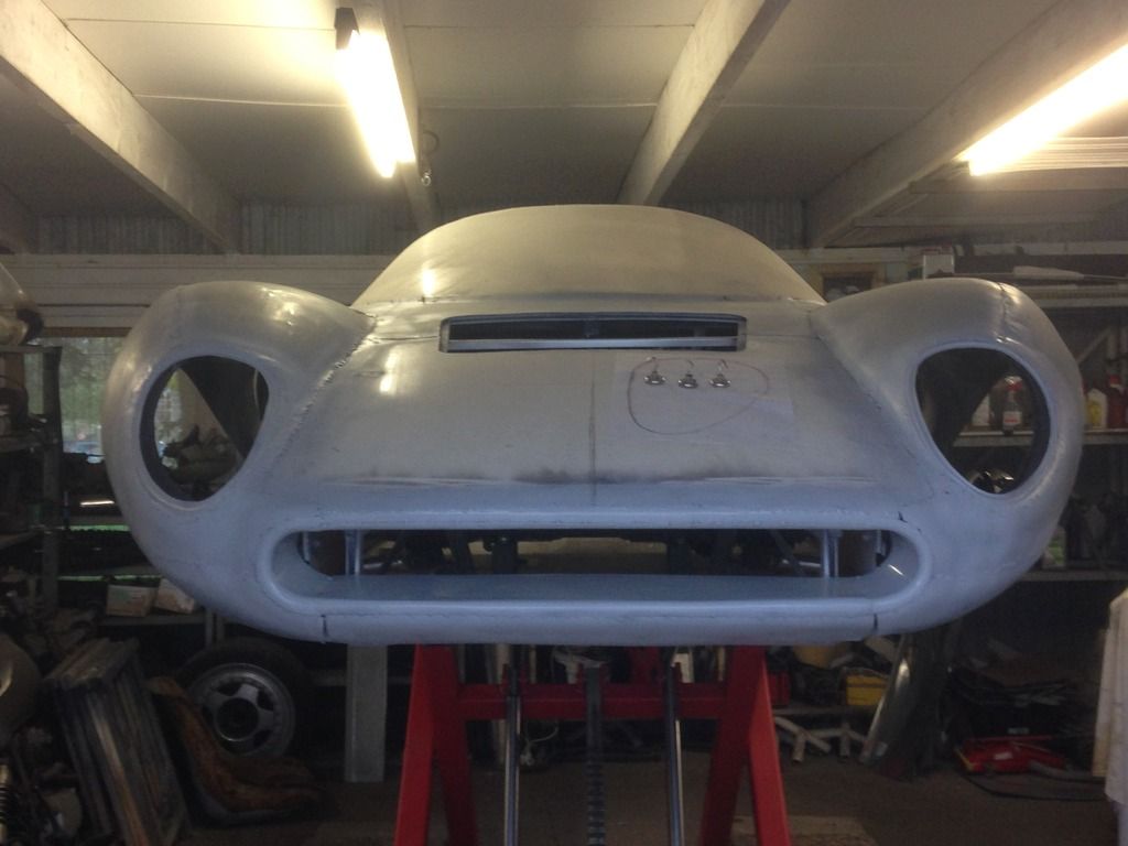

Frontend with the intake

Took some pics this morning, finally a face...!
