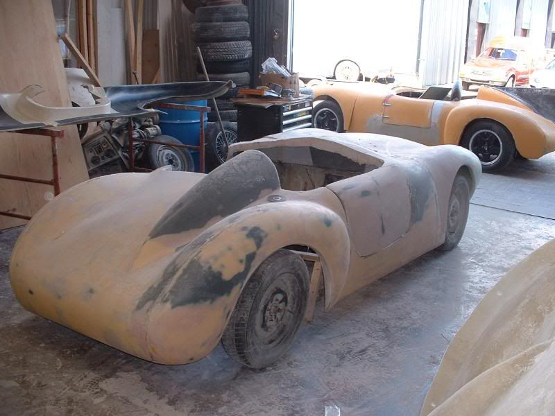

SOME UPDATES FOR YOU ....
We have been pretty busy with kit production these last few weeks ....its gone a bit mad ...several Spyders out the door and currently moulding Nike55's G46 body as well....
Mike has started to shape things up a bit now and we have doorshuts , doors , sort of , a bulkhead / end of cill area and its starting to come to life....
I have bought a nice big bench on castors and the car is going to be forklifted onto this tomorrow , so we can work on her at a decent height and roll it in and out of the shop etc....
The above shots show the shorter body quite well and how the shorter rear and bulkhead along with the set back cockpit are starting to look pretty good.
We have actually shortened the bulkhead a bit more since the earlier pics....this brings the front arch a bit nearer to where it should be and keeps a long bonnet line.
Mike has a full day on her tomorrow , so hopefully some more updates to follow shortly.....

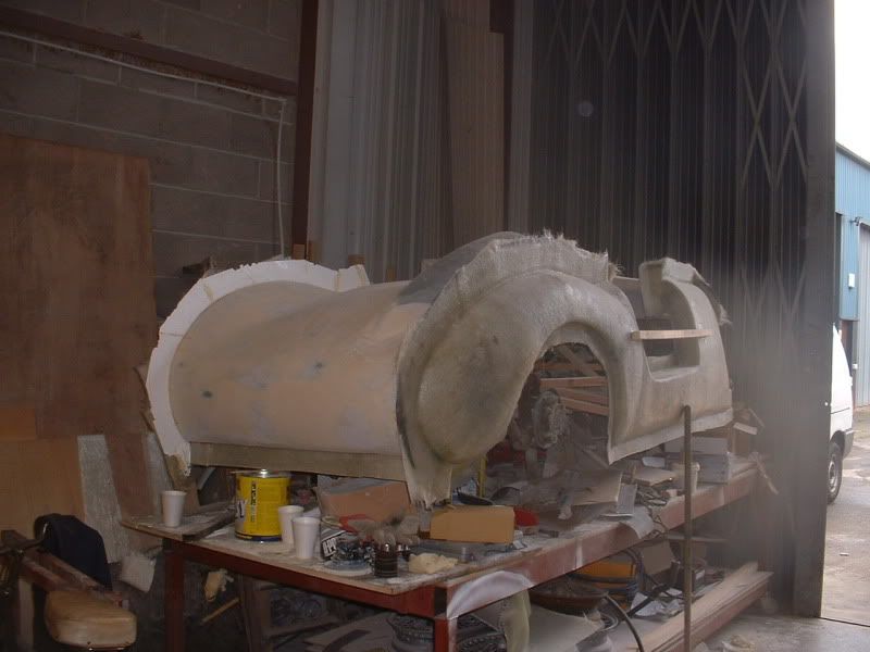

17th March 2012, 12:20
Mike has been charging ahead with the Cordite - we are very aware that Stoneleigh is coming up very fast...
The body has been straightened right out now , all mods dealt with and smoothed , a couple of subtle tweaks have been done in a few areas also , top of arches raised and curved slightly , things like that.
The moulding has begun....
both sides are done , some flange cleaning ( oo-er missus ) and finishing will be done to the centre and bulkhead Monday and then the remainder laid up....
I reckon , fully moulded and ready by next weekend !
Then its fit bonnet and start on that procedure......
