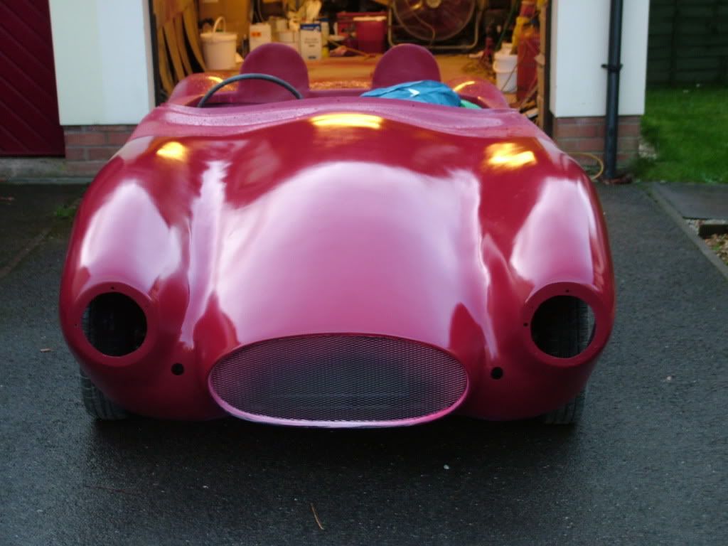

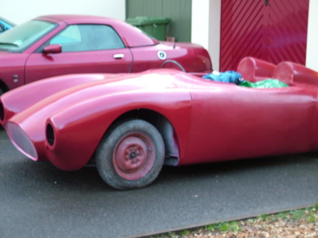

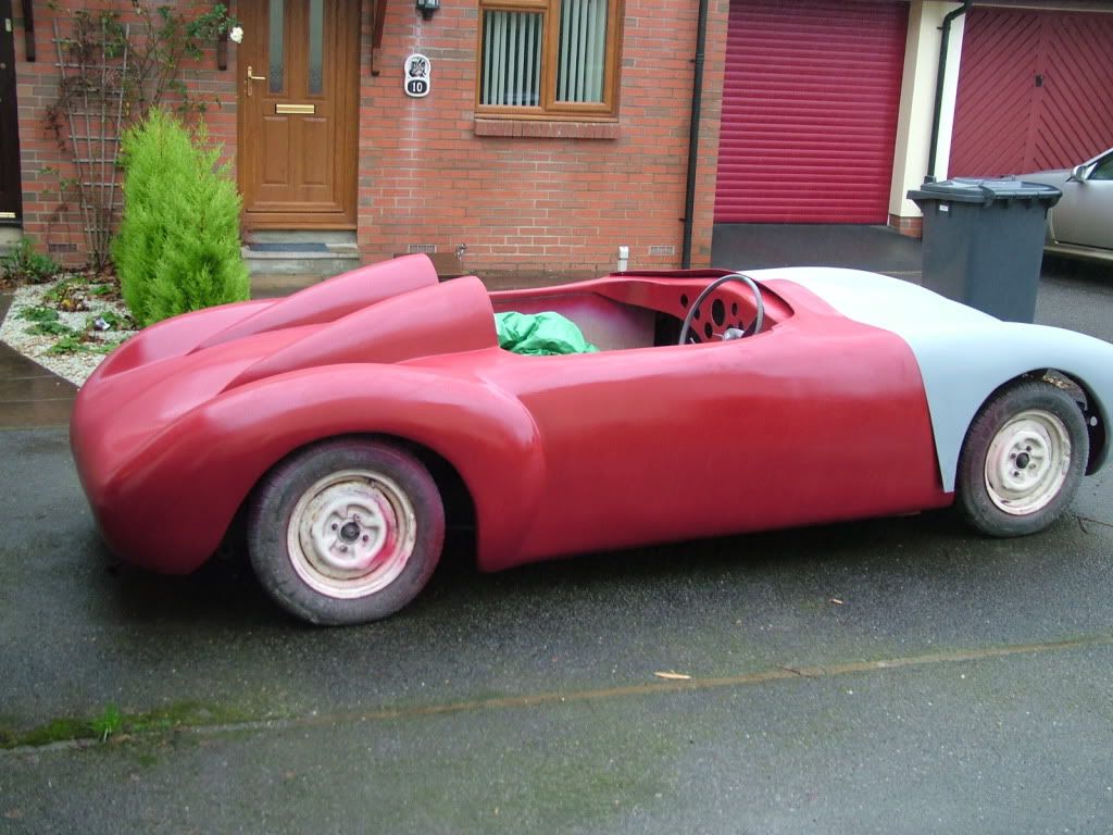

got few picks outside today,hope this shows the colour bette/IMG]r.

only had 2coats so far, and has gone back inside for a flatten down with 1500,then 3 more coats.....hopefully it get a few shades darker by then.

Looking good and I think the colour's going to look absolutely stunning once it's flatted and polished.
Mine is likely to be only a few shades away from yours as I'm pretty settled on RAL 3032 pearl ruby red. I could be swayed once I've seen yours all polished though...
  #68
Old 30th December 2011, 18:13
Nice colour! It looks a lot like mine from the pics, but then again i know how different it can look in real life.
Having fun sanding around the two humps?
  #69
Old 30th December 2011, 18:14
Just looked at the pic's again: did you practice on your garage door first to make sure you liked the colour?
  #70
Old 30th December 2011, 18:15
Default looking good, mulberry
You've got yourself a nice bonnet line... also a nice dash, good shape.

Looks good. I like the double head fairings.

Love the shut lines of your bonnet, how did you go about getting it like that?
Pops
just used a sanding disc folded over and rub between the two. till i got the line. took a few hrs tho...

got 2 coats paint on the bonny today and have started to flatten back the rear, such a shame it was nice and shinny, till then

you can see ive lost the shine to the rear, guess it come back with my elbow work
  #80
Old 2nd January 2012, 17:19
yup. lots and lots of it
