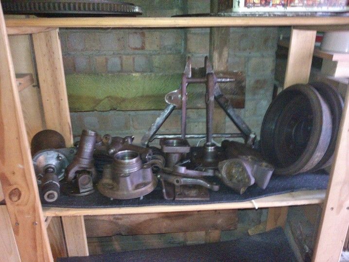

So, I'm afraid my progress will be mostly mechanical for the foreseeable, but I know everyone likes to see pictures of progress and its a useful record for future builders.
Rocker cover before and after. At one point I had delusions of polishing bare metal but I soon realised that would be the work of a lifetime so resorted to paint instead!
Distributor stripped and cleaned. Short panic when I realised its fitted with luminition electronic ignition and couldn't find the power box but that's now safe and sound.
Big tidy up in the man cave resulting in the complete shelf and the clean and ready to paint shelf.

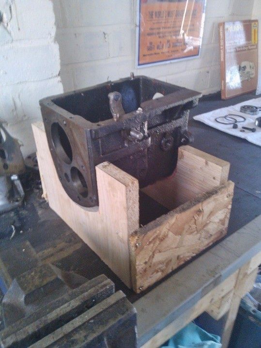

Made a trip up to see Viatron on Saturday to collect a gearbox that he kindly offered me. Top chap and had a good chin wag about all things Ribble. I now know all about the 'cut' that my cordite might need too.
The gearbox was only really needed for the casing as mine was cracked. I was daunted by the prospect of rebuilding the box but after I'd built a quick casing jig and an hour or so of disassembly, it's in pieces and ready to swap!
I found the reverse idler was chipped and the main shaft has a bit of play but that doesn't matter as I'm going to use the GT6 internals which I think are in good shape.
So I guess it's as simple as assembly is the reverse of disassembly....!?
One replacement case to be cleaned up and ready to be reborn with an overdrive bolted to the back...

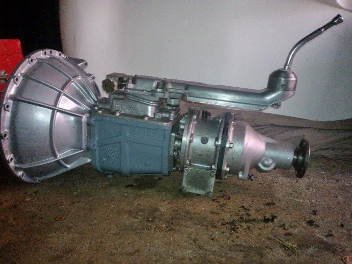

Making sh!t and preparing sh!t for our wedding is taking over nearly all of my time but just before it got busy, I managed a day in the garage. Engine on stand, head off, sump off, fluids drained and all seems to look serviceable. Sat looking sorry for itself but it will soon look good after a good scrub and a few new parts. Photos soon.
The gearbox rebuild was a little less straight forward. I replaced a few parts with new, especially the main shaft tip bearing as that was packed with swarf and had started to collapse. Looked like a poor quality replacement. The cranleys replacement that I fitted was much better. Rebuilding was painful and involved a few hours of assembly and dis-assembly. The Haynes manual just isn't right for the gear clusters that are fitted in my gearbox.
Regardless, it went back together in the end and all seems fine! 4 forward, 1 reverse. 4th a bit clunky but I think that's just to do with the synchro hub springs being a bit stiff. Has more of a race feel getting into 4th. All bolted back together ready for some oil and probably a rebuild as soon as it sees and load!
