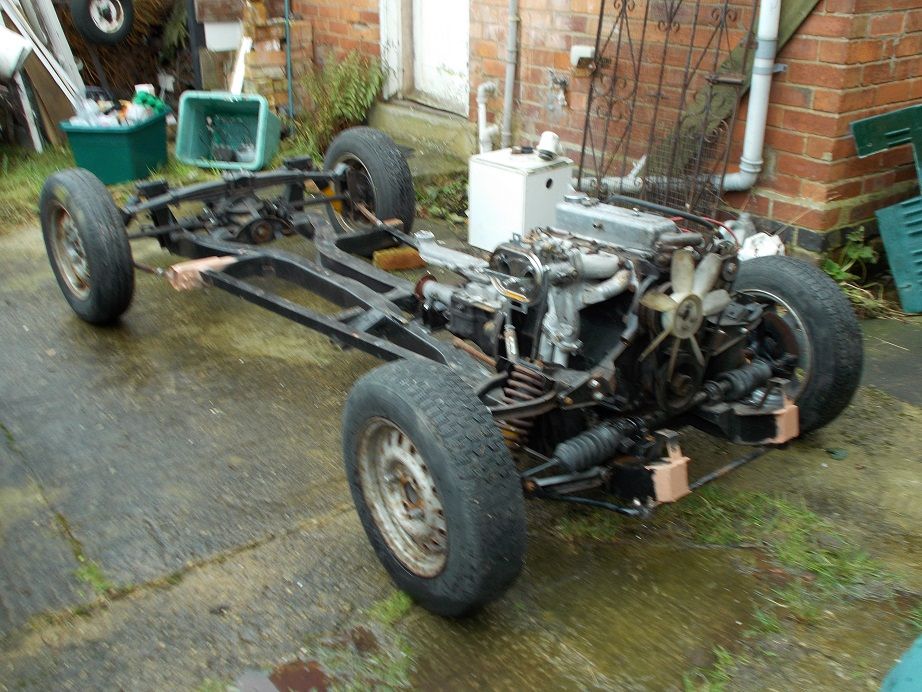

When this was launched in 1984 I was just starting building my first kit, a Dutton Phaeton II, bought new for £752. The Monaco, at £499 immediately appealed to me with its Triumph underpinnings so I sent off for the brochure and had a quiet daydream.
33 years and 15 or so kit cars came and went.
I'm on the Moss page on Facebook and on Boxing morning a post and picture appeared which I 'liked' and commented on to the effect that it was my dream car. A private message appeared on FB a few days later asking if I was interested in an abandoned project. It turned out that the owner didn't think he'd ever be able to finish it, and, as it had been given to him in similar circumstances, I could have it FOC on the condition that I completed it!
I went and had a look yesterday, it's eminently do-able and I'm collecting it on Monday on a low loader. As soon as my Tribute A352 passes its second MOT (imminent) I'll set to.

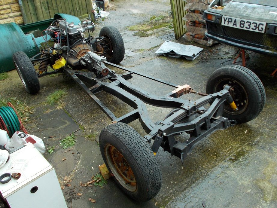

Talking The Monaco Has Landed

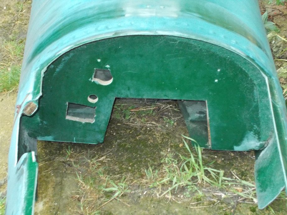

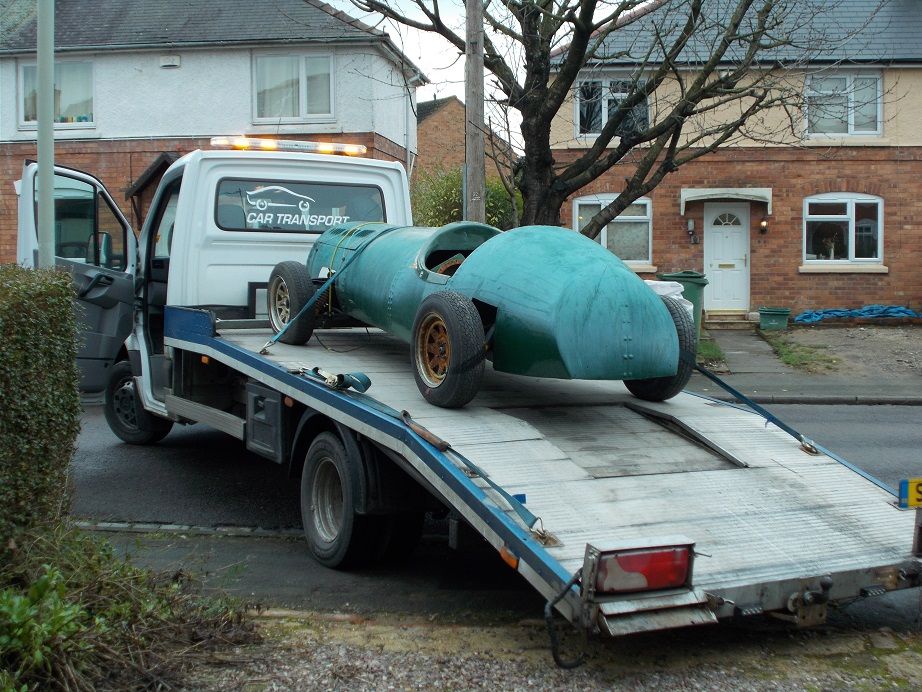

Collected the new project yesterday with a thoroughly professional and competitive local one-man-band. Less than three hours for a 100 mile round trip!

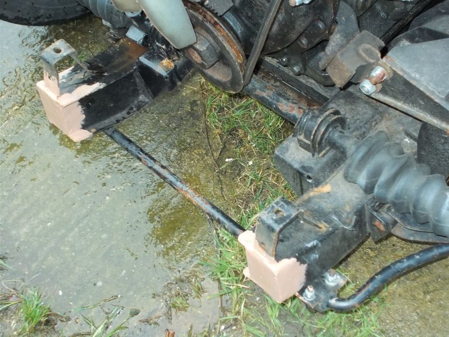

I removed the body to reveal the Spitfire underpinnings. The existing chassis frame has been modified in an unacceptable fashion so I'm now in the market for a tax-exempt Spitfire, hopefully with sound underpinnings but rubbish bodywork.
The wings, their stays, the air scoop, the gearbox/transmission covers, the headlamp pods (which I'm advised are fashioned from 'unobtanium'), the prop-shaft, steering column/wheel and a spare gearbox I've stashed in my shed. I'll spread them on the lawn for a picture when the weather permits.
The engine turns freely. I'll Redex the bores, spin it without plugs until I get oil pressure, then run it for assessment, again when weather permits as the A352 is in my man cave awaiting the delivery of MOT related purchases.
That last one isn't very special!
Regards, Mick

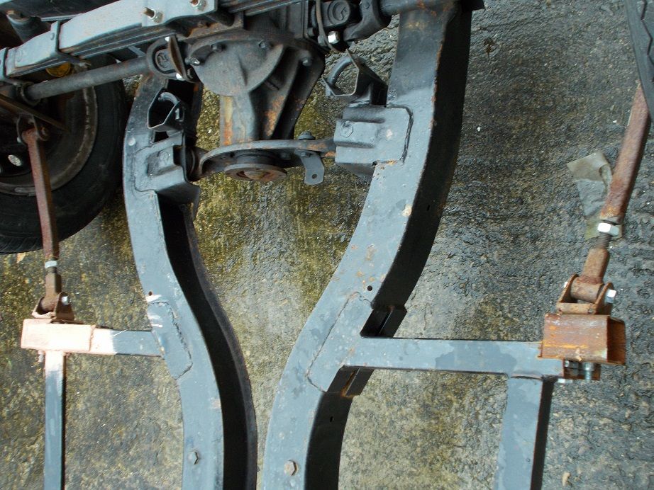

Holy cr*p, those rear suspension fixings look terrifying.

Rear wheel steering?
Can't the chassis be saved Mick?
Only if I want the completed car to need an IVA. I think the likelihood of its passing one would be remote. Those modifications are certainly without the DVLA's parameters for a simple re-body.

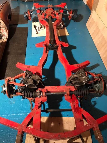

Talking Facebook to the rescue. Again!
I've been tracking Spitfires on Ebay thinking that I'd be spending a small fortune buying a complete car, then having all the time and trouble of breaking it and selling the unwanted bits.
This morning I thought I'd have a look in the 'Small Chassis Triumphs' FB group (without much hope) just in case there was one advertised. What popped up was a comprehensively refurbished chassis with a V5 but minus wheels and engine that the owner had decided to break as he hadn't been able to sell as a unit.
A contact message from me elicited a prompt 'phone reply and after verifying exactly what was for sale we agreed £700 including delivery tomorrow!
Serendipity indeed!
Regards, Mick
