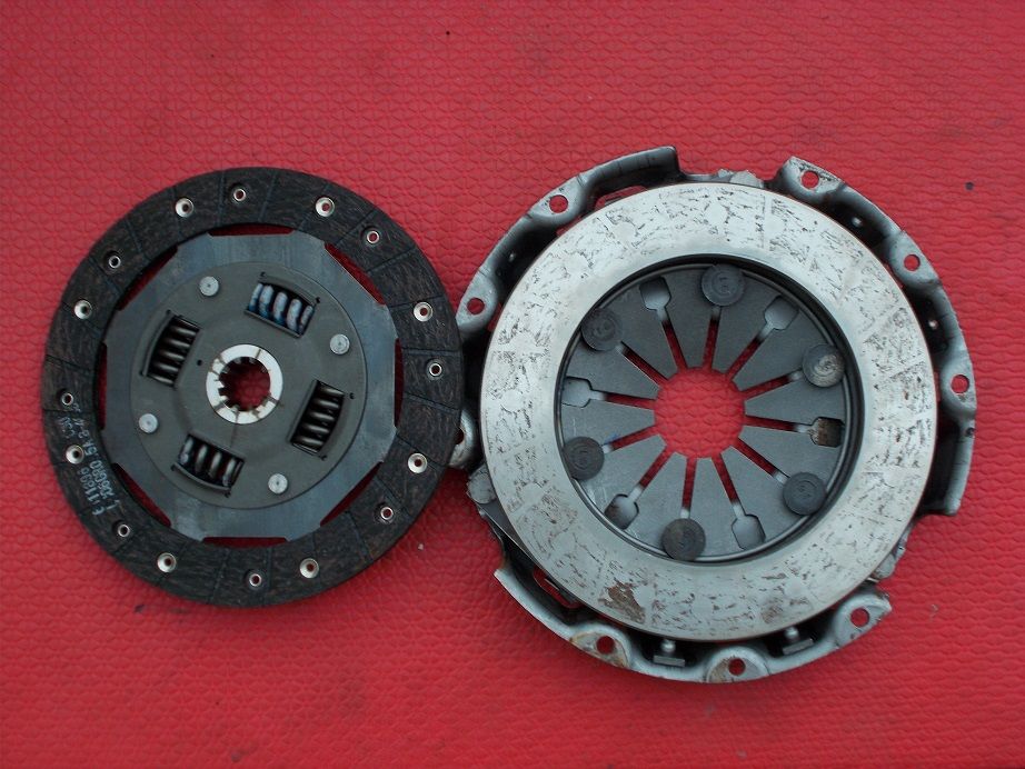

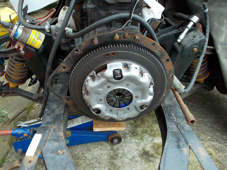

My neighbour was yet to dig out my crane so I set-to and began removing the starter motor, gearbox rubbers and bell-housing bolts as I always like to ensure a clutch is free whilst it's nice and accessible. Nothing put up much resistance, especially the gearbox cross-member which wasn't attached at all, apart from a couple of loose bolts dropped through. I jacked the engine up a little with a small plank under the sump, pulled off the gearbox and stowed it in my shed.
I was delighted to see a pristine pressure plate which, when removed, revealed an equally pristine driven plate which wasn't stuck to the flywheel - excellent news. These were also stowed safely away in the dry just as it began to rain, so the covers had to go on again.

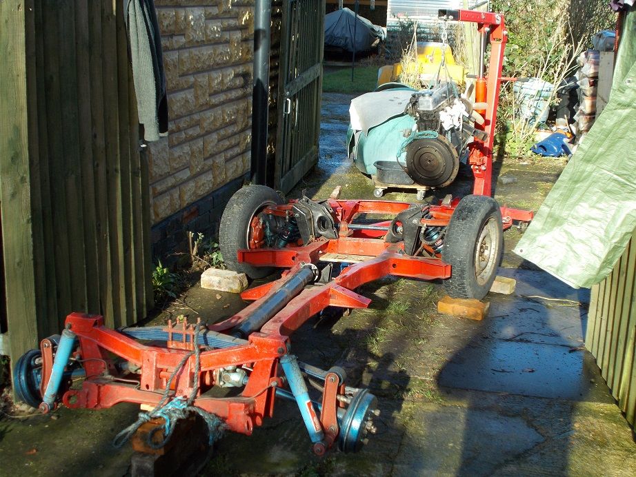

Double boiler suits again. Out at 0900. After lifting the engine just clear of the chassis which came with the body, I had to manoeuvre the new chassis on its two wheels backwards to enable the crane plus engine to fit in front of it. More hernia special!
Once this was achieved it was easy peasy to drop the engine in, remembering to have the exhaust manifold and down pipe loosely between the chassis rail and sump as it can't be inserted later - too big!
As the original chassis will now be stripped before disposal I tranferred the wheels from it to the new one. Much easier to move now, even with no steering column . All done before noon.
Next job is to swap the swing spring with leaves removed onto the red chassis, which has a standard six bolt spring.
Regards, Mick

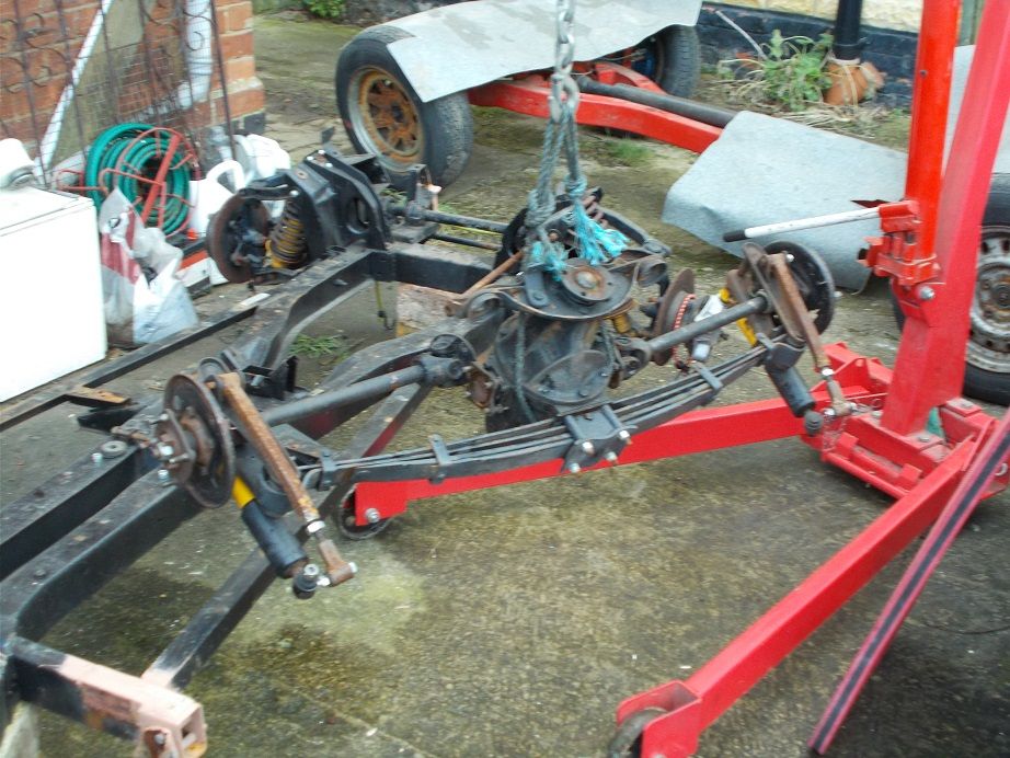

After a very late breakfast I dived back out and set to removing the complete swing spring rear suspension. The diff. drive flanges are bigger, the drive shafts are longer and the final drive ratio is lower, so it makes sense to swap the lot.
I disconnected the top shock absorber eyes, the front tie bar mountings, and the two nuts and the long bolt that locate the diff, having first supported it loosely with the crane. It wouldn't quite come out as the inner drive shaft flanges fouled on the handbrake cable guides. I separated the flanges and it was then possible to rotate the whole thing and manoeuvre it clear.
There was just time to cover everything over before the heavens opened so I think that'll have to be it for today.

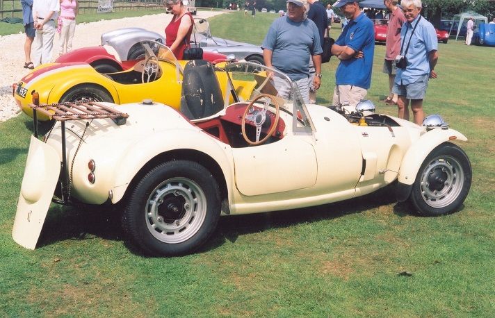

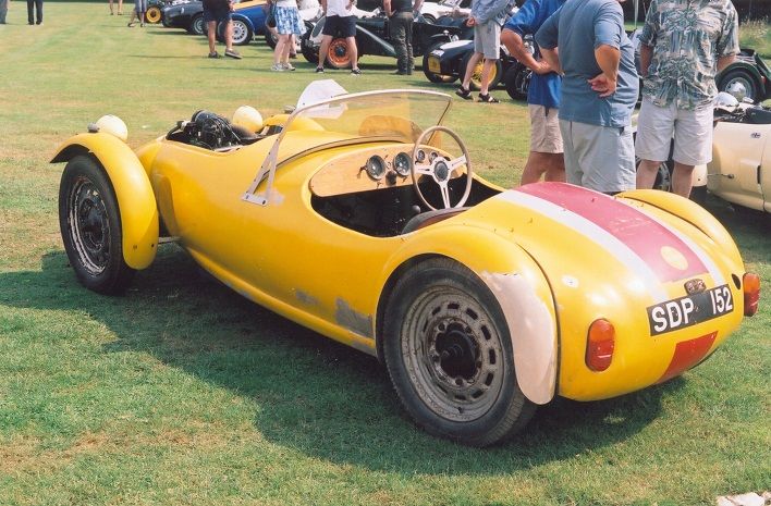

My future brother-in-law had one in the 60s when he was courting my sister, it prompted me to buy a Lotus VI, also 1172 side-valve powered. I don't have a picture of that Super Two to hand, although I know there's a monochrome Kodak Brownie 127 snap taken by my late mother somewhere.

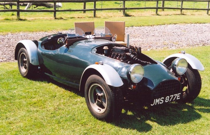

However, I do have these taken at The Specials Day (not a punk re-union) which is held on the second Sunday of August each year at The Cotswold Wildlife Park in Burford, Oxfordshire. The green one turned up at The Kit Car Show a few years ago on Spitfire underpinnings and on 15" MGF 'Minilites' which, coincidentally, I bought yesterday for the Monaco!

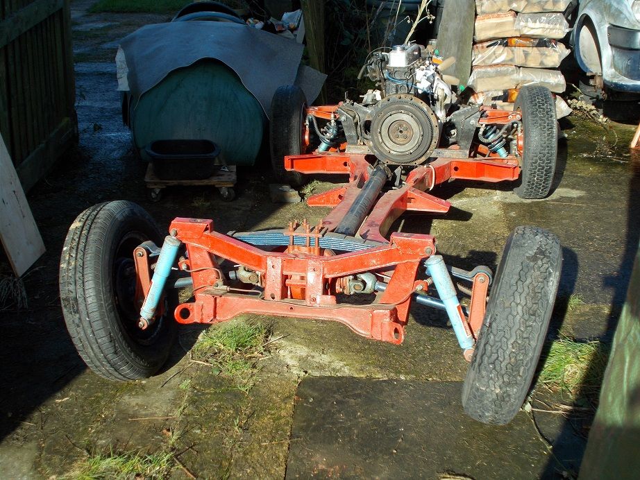

I took the rear drive and suspension off the 'new' chassis yesterday but the rain started again at a natural break in proceedings so this is where I've got to.
