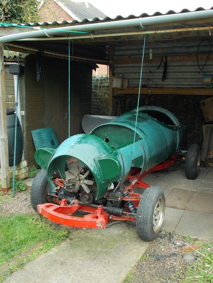

Yesterday I decided to address the problem of having to wait for help each time I needed to remove the body. Now that the Monaco was in the cave I resorted to the method I used when the same difficulty arose building the A352.
I'd screwed stout hooks from Wilko's gardening aisle into the cave's 4" x 2" roof timbers. I'd cut suitable lengths of nylon rope with looped ends to support it and hung it high enough to roll out the underpinnings. This was easy with the A352 as the front end was separate and I could stand inside the tub, not an option with the Monaco.
Anyway, I propped up the front end, made the bespoke rope support, looped it over the hooks, propped the rear and rolled out the chassis. It only just scraped by so a little shortening will be needed, but at least it worked .
I decided to drill the holes for the centre outrigger attachment bolts while I had access. I'd already carefully marked their positions on pieces of white self-adhesive label stuck under the floor so, after putting a safety plank supported by two garden chairs underneath I drilled 5mm pilot holes then opened them out to 11mm from both sides to prevent splintering. On replacing the body I trial fitted the M10 bolts which aligned perfectly. Result! Previous owners have drilled a variety of other holes in the floor to the extent that I may name her 'Emmental'. The wood sandwiched in the floor is quite wet so a summer in the south facing cave won't do any harm!

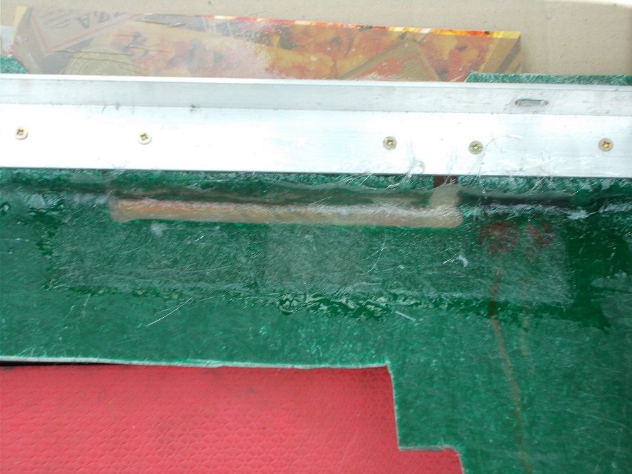

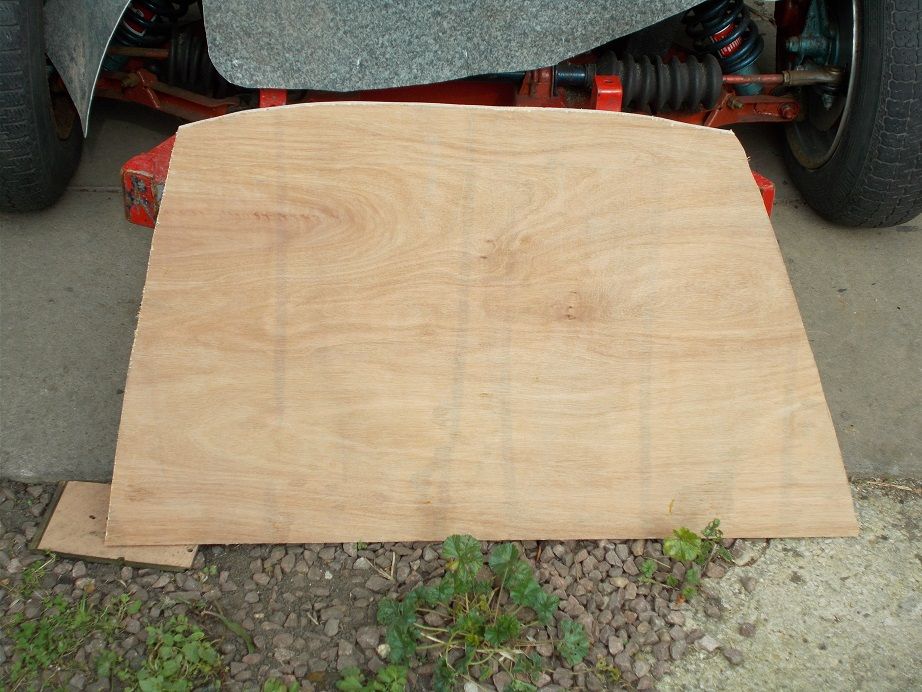

Today I was determined to go for a spin in the A352 as the weather forecast was so good and the poor old girl's been sat there for ten days since her MOT. As I was taking the top cover and tonneau covers off I remembered I was supposed to be taking up a carpet for my daughter. I pitched into that and an hour had gone. I thought, I'll wait until it's a bit warmer as the wind was quite bitter, and I'll do some Monaco in the meantime.
My son's away for the weekend so I had to resort to my rope trick to remove the body. By the time I'd managed this, wheeled the chassis out of the way, dropped the back end of the body onto my Machine Mart trolley, pulled it onto the grass (which I'd interrupted proceedings to cut) and pushed the chassis back into the cave, another hour had gone.

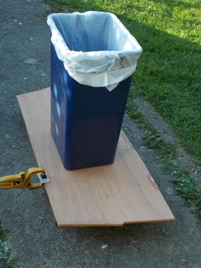

I then remembered that the 'lift the dot' studs made it very difficult to single handedly manoeuvre the body inverted, as they turn it into a harrow, so I removed the front fibreglass coaming and the top five rear studs and rolled the body over. Yet more time gone.

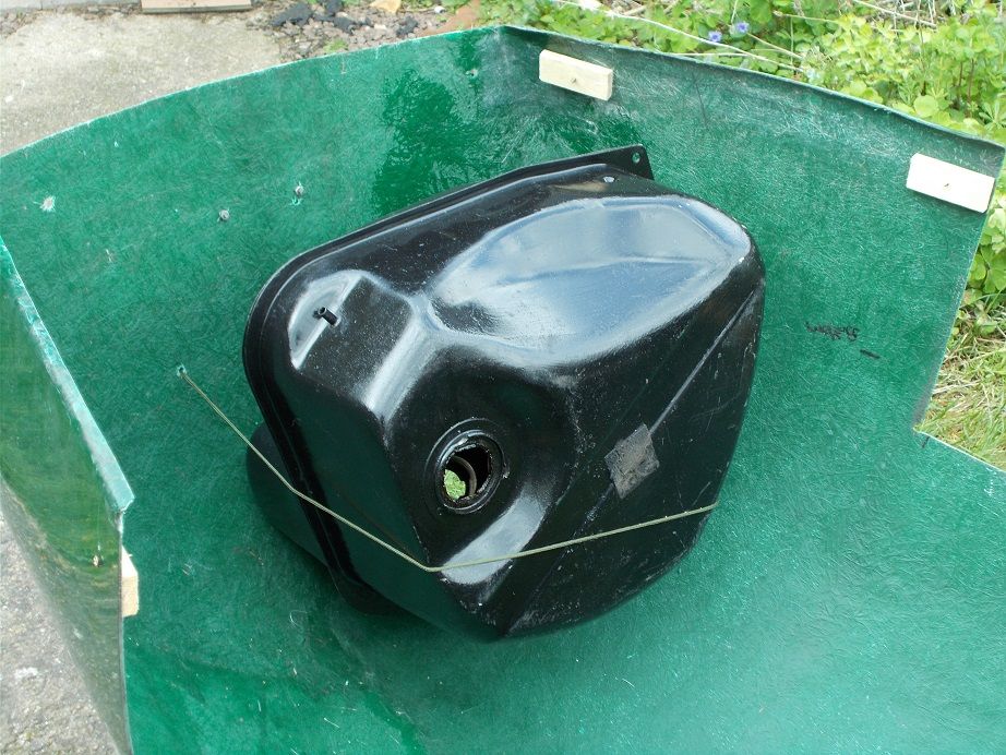

I'd decided to use a classic Mini petrol tank in the tail and had bought a refurbished one a couple of weeks ago. I offered it up and cut a hole for the filler neck which protrudes at a weird angle, although the tank itself sits quite nicely in the space. I'll have to cut and shut the neck.

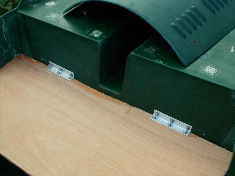

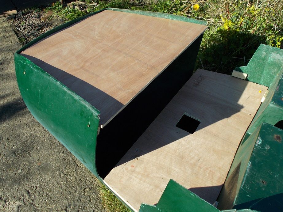

I refitted the first bit of boot floor, after carefully drilling the holes for attachment to the rear suspension turrets - I'd drawn around the latter from underneath during the last trial assembly. I then measured where the bottom of the tank would sit and prepared a cardboard template to fit parallel to the plane of the other bits of floor.

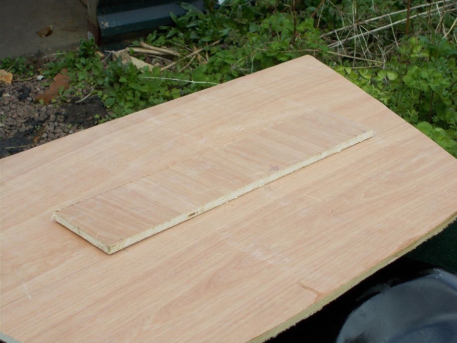

Out came the ply, the jigsaw and the support blocks, I drew around my template and cut the new bit of floor which only needed very slight trimming to fit snugly. I cut four doorstop temporary supports, screwed them to the body and rested it in place. I'm quite happy with it although I think it's possible the two big eyes on the very back of the chassis frame might foul it. Time will tell and, if so, something will have to give.
By this time my concentration was waning so, rather than press on, I tidied everything away. As the body will live upside down on the grass whilst the dry weather continues, I taped over the tops of the multitude of holes so that drying of the sandwiched wood isn't compromised. Some of the mounting holes had definitely been drilled on a 'hit and hope' basis. Mine is the one with the white tape - apologies for the rubbish picture!

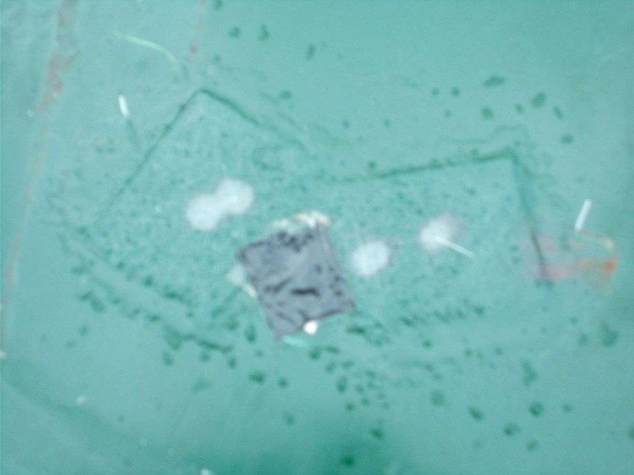

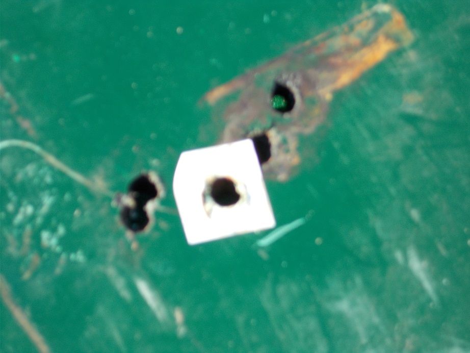

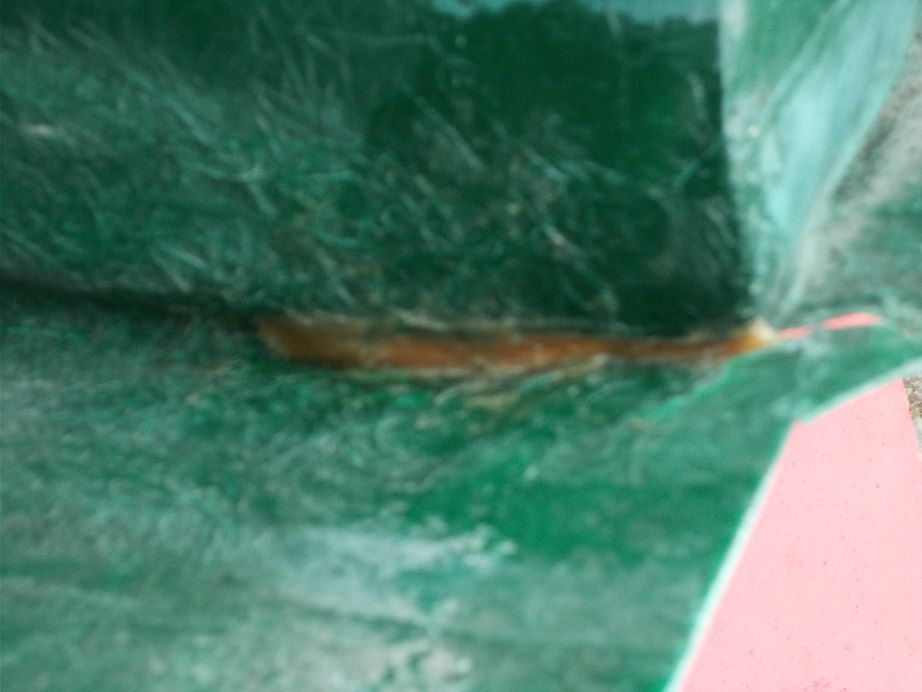

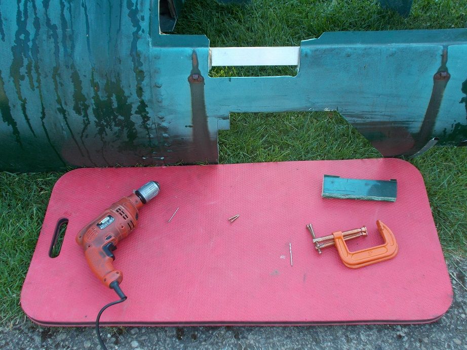

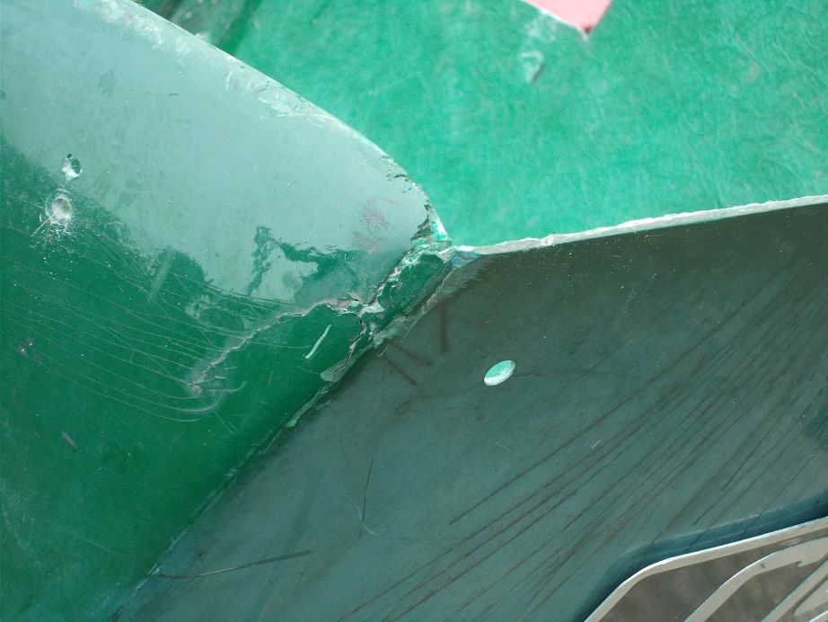

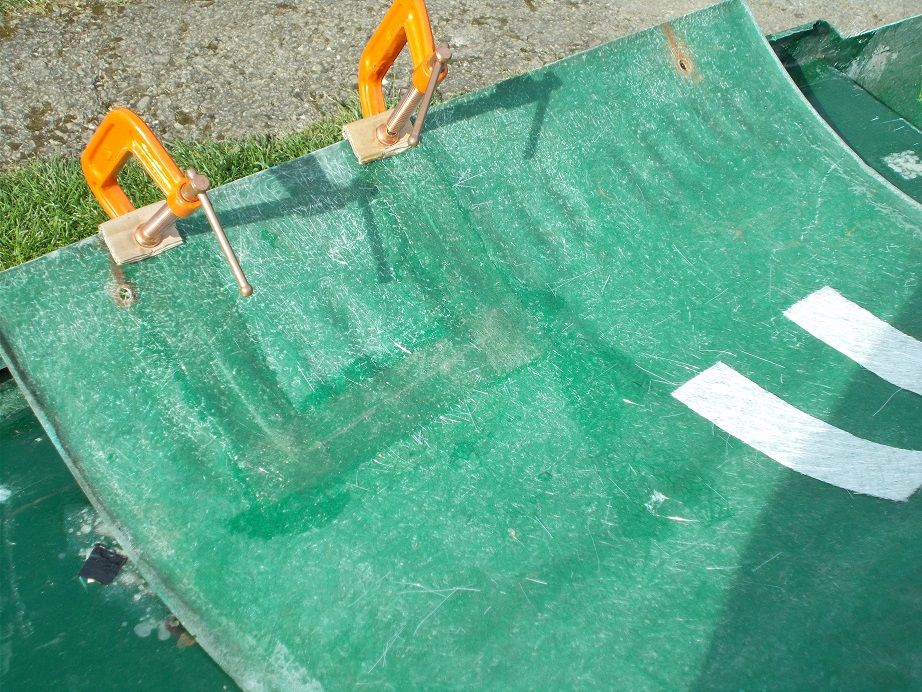

Today, as the morning weather forecast was good, I decided to do some work on the rear body, where the petrol tank will eventually sit. I temporarily re-fitted the second piece of floor to the inverted body, and attempted to manoeuvre the petrol tank through the hole I had cut in the seat back area, This was to help me decide whether to make the floor permanent or removable in the event of tank maintenance or replacement at some future date. It almost not quite fitted through the aperture so I decided on permanent, as only an additional thin sliver would need to be removed. I took the floor back out and, as you can see, the rear body is far from symmetrical.
I then cleaned the areas that I was going to repair, first with production paper, then acetone to ensure surgical cleanliness. Where the bottom of the skin in front of the wheel arch meets the seat back there was a nasty crack and split, and another split at the bottom of the opposite corner. I filled the former with a wedge of U-Pol. When this had cured I bridged both cracks with two layers of mat and resin. I'll add another two when weather permits.
While the GRP kit was out I decided to cover the bottoms of the redundant mounting holes with more mat and resin, following the same cleaning regime. I now only have to tape over my two holes of a night whilst it's inverted on the grass. I'll wait until I'm good and sure that the wood sandwiched in the floor is dry before sealing the other side.

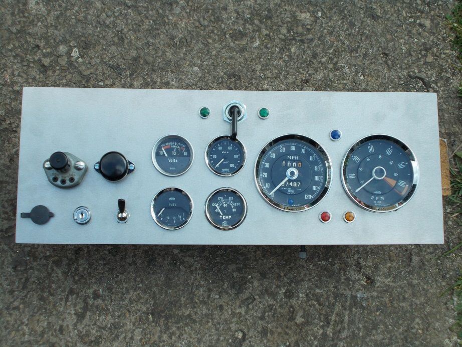

The nice man had delivered my dashboard blank yesterday. The same friend who turned my A352 wheel spigots and steering wheel boss laser cut it for me. Top bloke! I decided I'd trial fit the clocks, switches and lights to boost enthusiasm and was very pleased with the look of it. I won't cut the top profile until I've fitted the upper steering column mounting as it may slightly affect positioning. The top two on the left are dip switch and horn; the outer two beneath, accessory socket and lights. The indicator switch looks as though it fouls the oil pressure gauge, but it's well clear.
By this time black clouds were piling up and another nice man had just delivered the plywood I'm boarding my daughter's loft with tomorrow. The 8'x4' sheets have to be jig-sawn down to 4'x2' to fit through the hatch. This was my last job of the day.
Regards, Mick

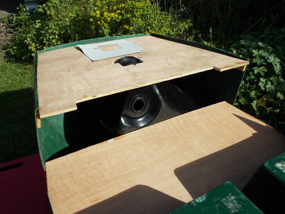

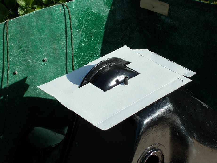

Yesterday, after a wet morning, I decided to press on with the Mini fuel tank. First job was to find a way to sit it upright in the inverted body. I considered wedging it with wood off-cuts but, as both surfaces are curved, I discarded that idea. I took off the number plate and threaded a loop of para cord through the holes. With the filler neck in its hole I then knotted and re-knotted the ends until the tank sat nicely.
I laid a straight edge along the bottom flange and marked the inside edges of the body. I put the floor back in place and transferred the marks to its edges, then cut an oblong of ply against which the rear face of the flange will locate. I stuck it to the floor temporarily with four small blobs from my Machine Mart hot glue gun and offered it up. I could see that my idea would work. As the base of the tank is curved, further ply will have to be fixed to support it across its width. I'll probably use Sikaflex and short countersunk wood screws for final assembly.
A matching but removable ply locating plate will sandwich the front of the flange. I'm unsure how I'll locate the top of the tank but there's a handy mounting hole and I can fabricate a removable neck escutcheon, once the odd angle at which it protrudes has been sorted by cutting a V and welding.

When I'd offered up both levels of my boot floor I realised that the front one, which will bolt to the suspension towers, wasn't long enough to enable the ply joining the two to be vertical. Fortunately, one of the jobs which sidelined me was fabricating new gates between the houses from 13mm ply (the old ones were modified fence panels and hadn't stood the test of time), so there was enough spare to make a new extended floor using the old one as a template.
When cut out I noticed that the ply was de-laminated quite badly so I made up some resin, brushed it liberally into the gap and weighed it down flat (there's a car battery in my bin) whilst the resin cured. This worked, but I haven't offered it up yet.

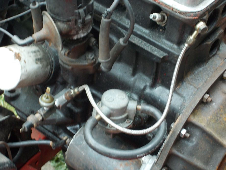

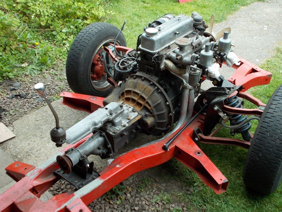

I'd found a pair of 1¼" SUs on a four inlet port Spitfire manifold when I cleaned out my shed. I think it came as a spare when I bought my Marlin Roadster about ten years ago. Maybe. I'd bought an overhaul kit so I set to, firstly with a bannister brush, then dismantling fluid (I find this an excellent cleaner). It took a good morning to fit the kit and give the dashpots a quick once-over with Autosol.
Next job was to bolt the manifolds to the head which revealed that the two tapped extensions which are meant to be bolted to the exhaust manifold were too long. I cut ever smaller slices (three) off them until I obtained a good fit and tightened everything up. The carbs sit nicely now, albeit without cable operated pivots for either the throttle or choke, or return springs. Beaulieu Spring Autojumble awaits!
Yesterday morning, again not wanting to do bodywork, I decided to re-fit the clutch and gearbox. The days when I could fit a gearbox with a loop of old seat belt around the back of my neck have gone, so my trusty Machine Mart engine crane was pressed into service. While this was handy I renewed the engine mountings as well as the gearbox ones, the former looking like 60s originals. I thought I'd check the gearbox oil level whilst I was down there and found it was empty, 1½ pints of hypoy later all was well . I also fitted the oil feed pipe to the rockers. The Christmas tree arrangement necessary for this, an oil pressure gauge and switch can be seen in the picture. The end switch is to blank the hole until it's time to fit the dash (crap photo' alert).

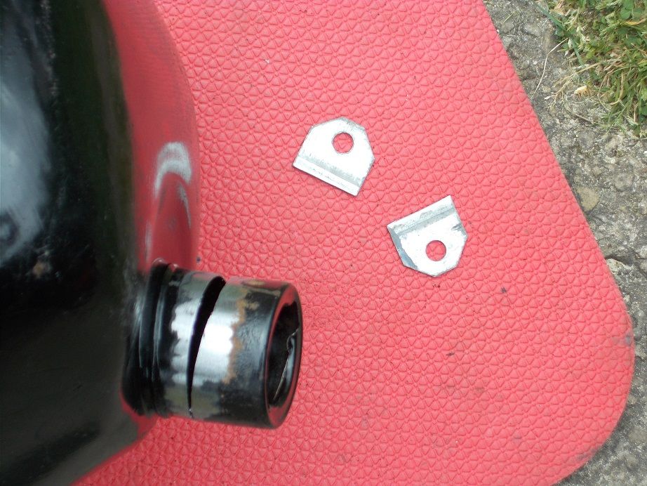

This morning I decided to tackle the mini tank problems. From Ebay I ordered a neck grommet, locking petrol cap and sender unit, the tank having come bare. I offered it up in the boot area and decided that the two original holes in the flange were insufficient for secure mounting and cut two fishplates (there'll be two mountings top and bottom) from an old joist hanger which will be welded to the flange by my demon welding contact. I also marked out and made the V cut in the filler neck to correct its odd angle with the body. He'll TIG this for me as well. I toyed with the idea of whizzing over to his workshop with it in the A352 but decided that Maundy Thursday afternoon wasn't the best time to be distracting him from his real customers' jobs. Tuesday will have to do.

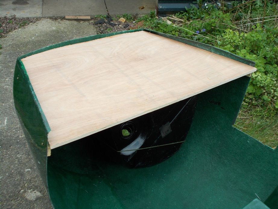

Yesterday I set to and offered up the tank and boot floor to the inverted body. I decided that, on my previous attempt, I hadn't optimised the tank's orientation in regard to the outlet, which wasn't quite as low as it should have been. This slight angle would also have compromised correct operation of the fuel gauge sender.
After a bit of jiggling I realised a new neck hole would be needed in the body. Its new location would be almost perfectly central, so I marked the new position, drilled a pilot hole and used my hole saw from both sides to ensure a clean cut. This I hadn't achieved the first time as I'd used the 'ring of small holes' method, which was ugly, to say the least! This will obviously need to be glassed over!
The very bottom of the tank and the middle of the plywood floor now occupied the same space so, using Cardboard Assisted Design, I made a template, transferred the outline to the floor, and cut the hole. It needed a bit of tweaking with my jigsaw's angled cutting facility coming in very useful. After three or four attempts the floor and tank mated perfectly.
The nice man had delivered the large headed rivets I intend using for my demon rear floor section supports, but not the aluminium strips that they'll fix to the body. Last job of the day was to cut and drill the short lengths of aluminium angle which will support the front edge of the forward boot floor section and temporarily bolt them in position. Regular readers will notice that the access hole for the spring mounting has miraculously healed itself. My first attempt wasn't measured accurately enough but luckily I had more than enough spare ply from my gate building to make another which is just a little longer

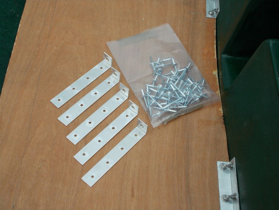

Today I fabricated the rear boot floor section supports from 3mm x 25mm aluminium flat. There are five of them: two for each side and one for the back. They'll be attached with 4.8mm large headed rivets through from the outside of the body; the floor will be M8 bolted to them with penny washers each side. Having seen the structural engineer's calculation for the box beams in my cottage using wire ovals through ply (it was many tons shear force per nail), I'm confident that the 20 rivets will be more than secure.
That was it for today, apart from 'phoning my Spitfire breaker contact and ordering a large flanged propshaft and a fuel pipe, the hard plastic type. He's frequently up and down the M5 from Devon so they'll arrive in a week or two.

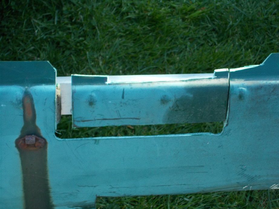

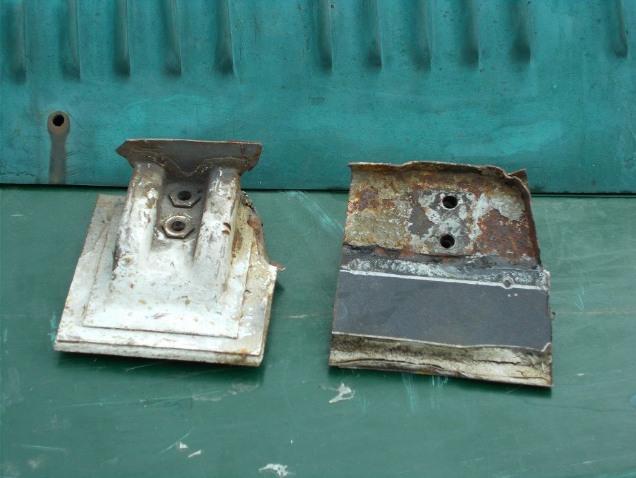

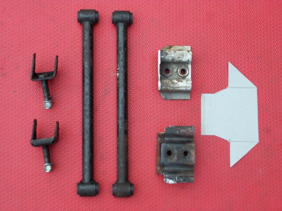

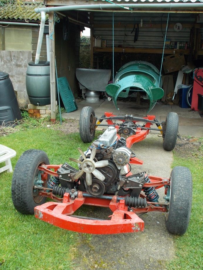

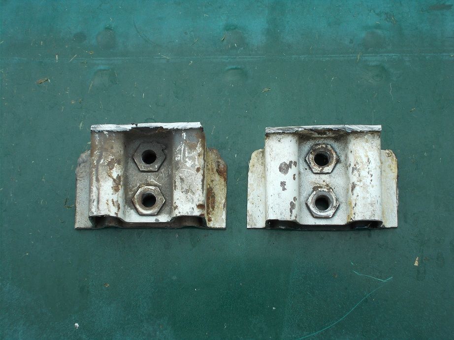

Monday and yesterday I tackled how I'm going to locate the forward ends of the radius arms. I originally intended to extend them forward to the centre outriggers as Micky1Mo did. However, these items popped up on Ebay so I bought them to see if they could be somehow adapted.
After a bit of head scratching I decided that adaption was possible and cut them down ready for base plates to be welded on. These will be bolted through the wood and GRP floor with a steel sandwich plate inside to minimise the possibility of their working the holes.

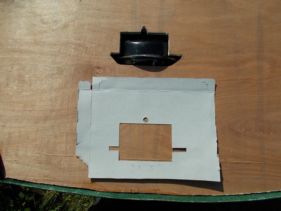

I made a cardboard template of the mounting plate - the triangular ears will be folded up before welding to provide resistance to the twisting moment. I might supplement this with a metal strap leading forward - belt and braces!
I dug out the radius arms and set to with replacing what looked like the original bushes. The bolts through the mounting brackets had to be cut out as they were rusted solid into the bush sleeves. I drove the old bushes out and the new ones in using the vice, bolt and socket method, after cleaning their housings with emery cloth and using plenty of dismantling fluid before assembly.
That was it for Tuesday. Once my demon welder 'phones to let me know my tank's ready I can whiz over and raid his skip for suitable bits of scrap for the above. Happy Days!
