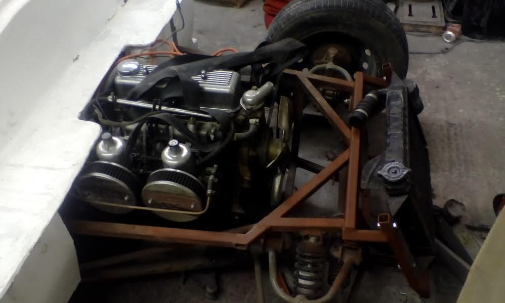

I have started to build a Sammio using a rolling Locost chassis . They have a slightly wider track than a Herald and a bit longer at 93'' wheelbase .
I need to modify a body to suit , hence , maybe starting with a Sammio Spyder body or a partial Cordite ...not sure yet ..
Front suspension is tubular A arm using Escort Spindles and hubs , rear axle is Escort with coilovers and four bar link setup ..
When I fit the wire wheel adaptors and 15'' MG WIRES , I will be in a better position to widen the body.
Bonnet needs to be lengthened and widened and will under go a make over to compensate for the larger scale ...
The framework needs to be added to and widened in the bodytub area ...imagine a Sammio frame joined to a Locost and you are on the right lines ...more of this to come when final body tweaks decided upon.
I have modified the front framework to accept the 1500 engine that was removed from the A352 project I am doing at present , this has gone in using homemade engine and gearbox mounts using Cortina rubber mounts up front and the Spitfire ones in the rear ...
Radiator is the stock Spitfire one mounted on new framework too ...

The cockpit framework will be Sammio spec , giving full width seating and centred steering , pedals etc ...steel bulkhead framework incorporated also and strengthening bars from existing engine bay tying it to the rear of the dash / internal frame area ....like a square box space frame setup ideally ...
Build will be fairly slow as time and funds allow ...I'm collecting lots of bits to incorporate some different features to the standardized Sammio formula we all currently follow ...
