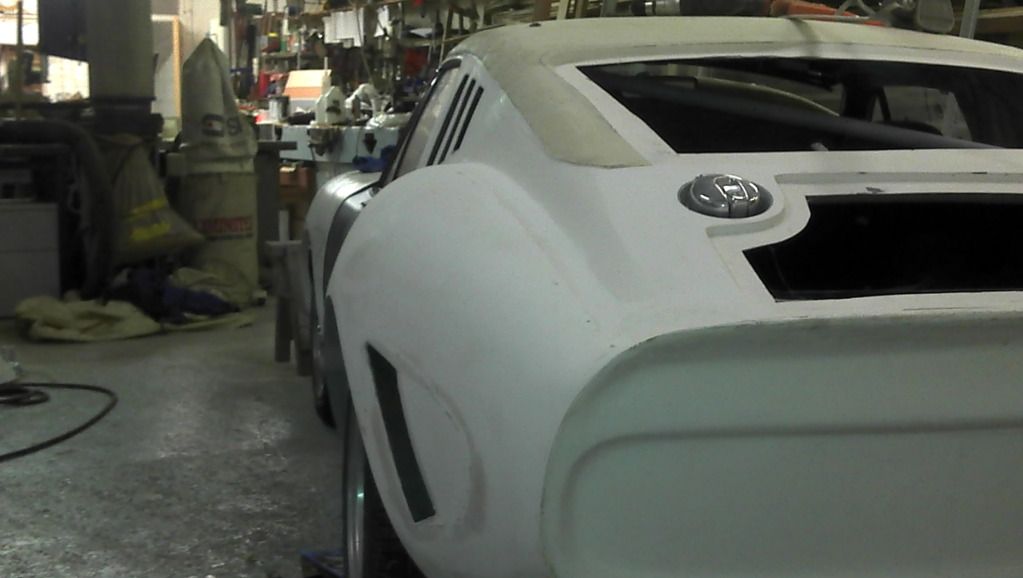

Hi Peep s, yup nice cap, with a key, 20 squids. I am not sure if I will need the rubber gaskeprobably make another, as my drain is now central, not on the side.

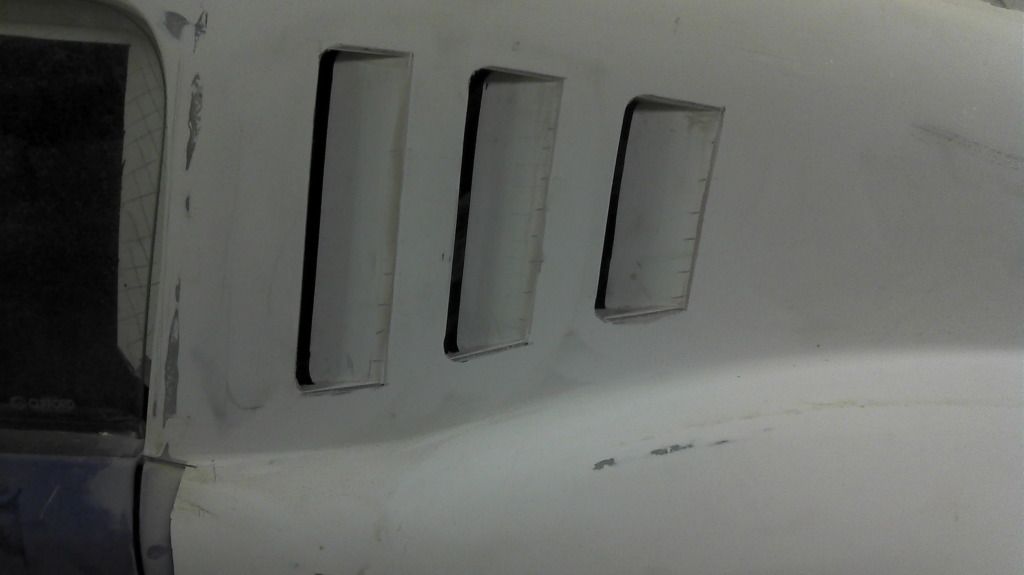

Not much time this eve, but took the plunge and made my take on the rear vents.....
will glass later and fill in from behind. I will connect them so they pull some air from the inner wheel arch.
Wadda you think? ?? (apart from mocha, whose opinion I am not interested in)

Great looking filler....but I am biased as I have a coupe! Is yours restored? Doesn't look like it has any of the normal white oxidisation marks. £20 is a cracking price for a restored one too.
Good looking vents too mate.

Nick, you are doing a cracking job! Love the vent and love the speed of your progress!

The fillers are ex Fiat Coupe , a car I had not really looked at before, but its worth a look on Wiki. So its '92, and unrestore
Glad you like the vent, subject of a lot of umming and arring. I was going no-vent, but that rear quarter needs breaking up as its a big area, I think. However I found the existing vents too large, so heres my inbetweeny.
Re progress, thanks Chris, its just an hour after work, or two hours after eight when the kids are in bed

I like the look, very slick. With the vent angled in like that its going to suck like a Dyson or maybe play tune like a Violin

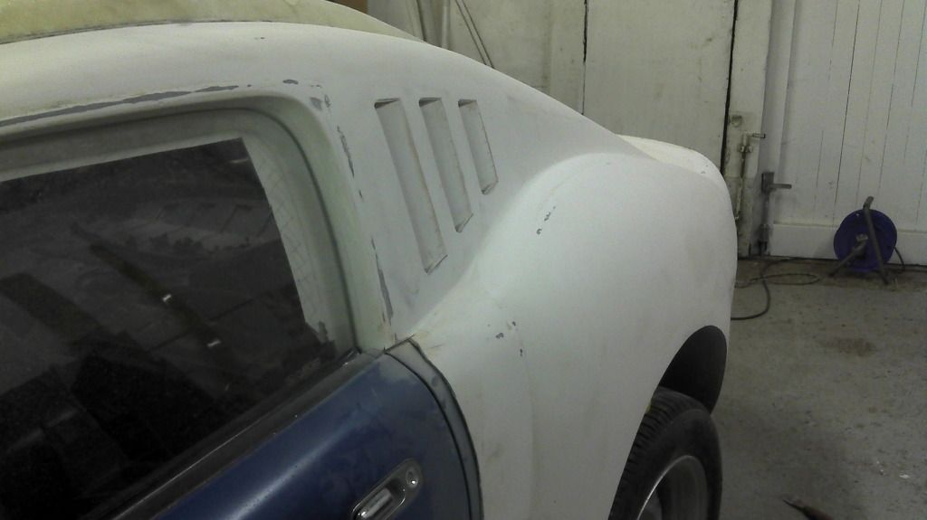

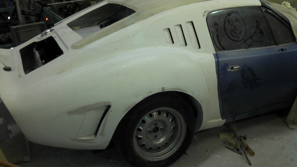

Heres this eves result. Inspired by the 275, and imho a need to break up the rear quarter view. For a couple of hrs marking, snipping and pugging I am pleased. Still needs a bit of fettling.

Top, dallah! Love the look.

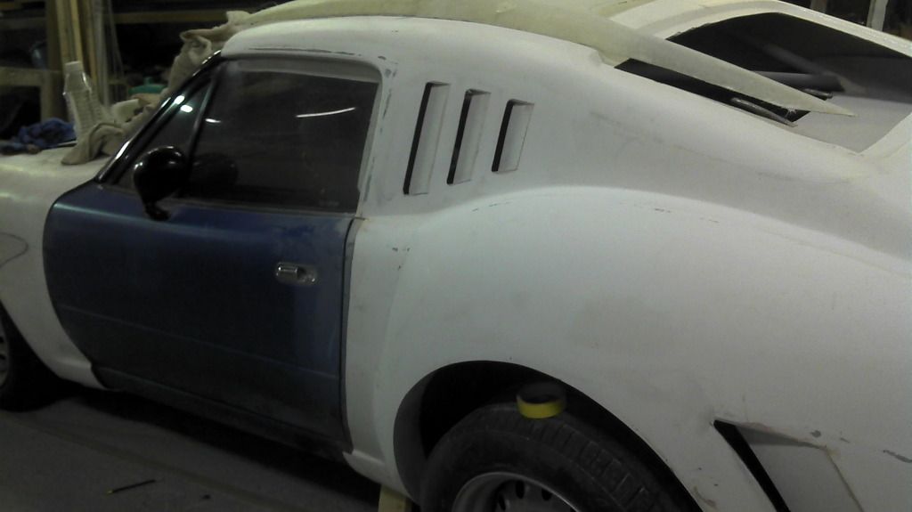

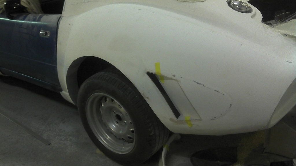

Done the vents in the other side. They are quite similar to the other side, so I am happy!
And the view from the rear...

Some really nice mods going on there. Great work

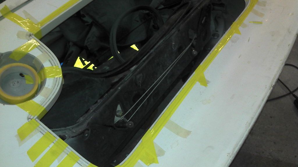

I've done a bit more this eve, hopefully making the former to mould the boot gutter around, so I can use the MX boot seal.
Pics coming via phone.......

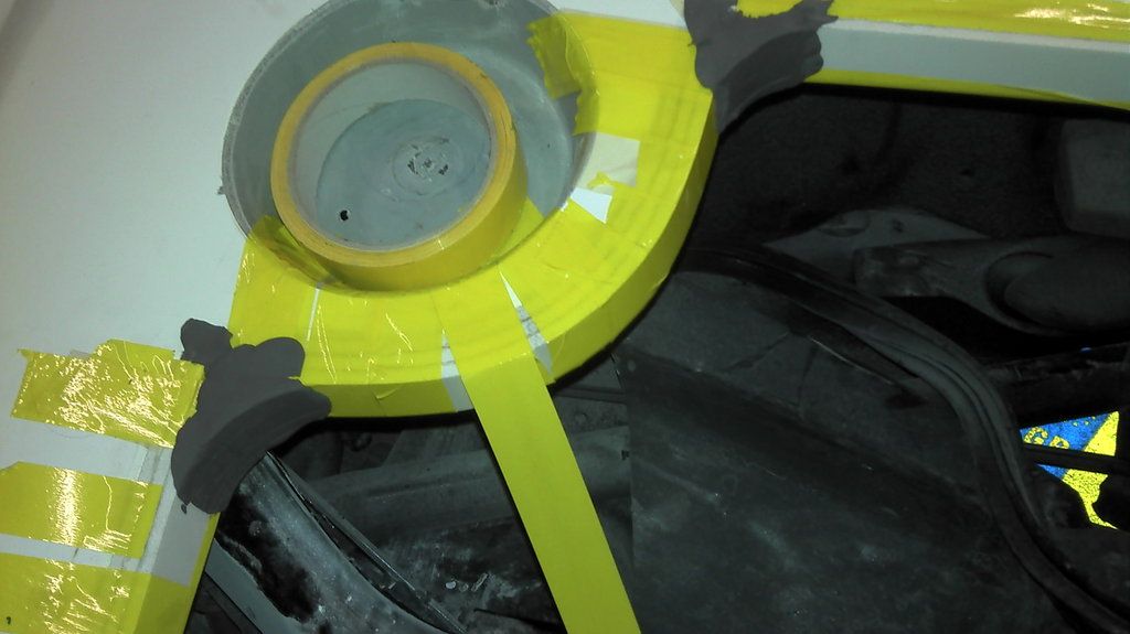

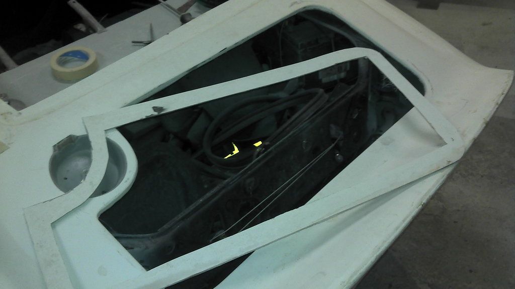

Chopped out the boot return...[IMG][/IMG]
Built up layers of plastic stuff to make a former for the grp.
Used smooth shiny tape to hold it there, and plastercine in the corners to provide a radius.
I'll put a layer of gell coat on now, but will have to take the body off to glass under it properly tomorrow.

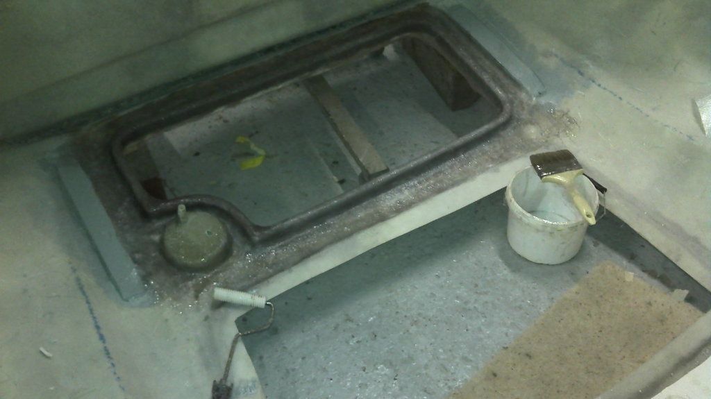

Default Boot gutter/seal mount

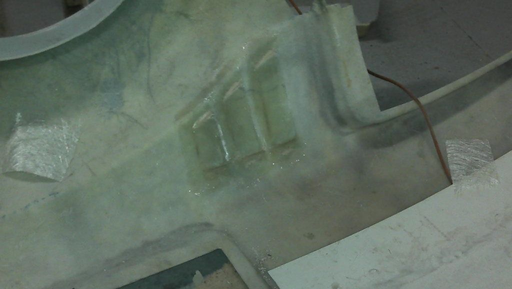

Put a coat of gell on this morning, and another at lunch today. Glassed over the lot this eve. Only had time for two layers. Hope to put a couple more on tomorrow. Also glassed over the inside of the vents after a clean up.

Oh xxxxxxxxx and xxxxx it!
The grp I did on fri eve still hasn't gone off. Silly me, I used a mixing pot and brush left overfrom epoxying a deck on a boat. Although I rinsed it well in acetone it has upset the polyester and its all still soft. I will havevto pull it off, clean it and start again!

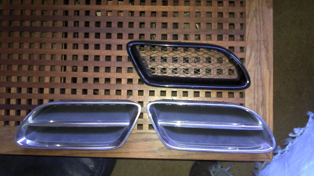

On a brighter note an afternoon trip to the local scrappy yielded a new 'baby', spotted by my 3 year old daughter, and two vents from a Nissan primera, plus one from another nussan. Which was just too good to leave. Both went home muddy, but happy.
