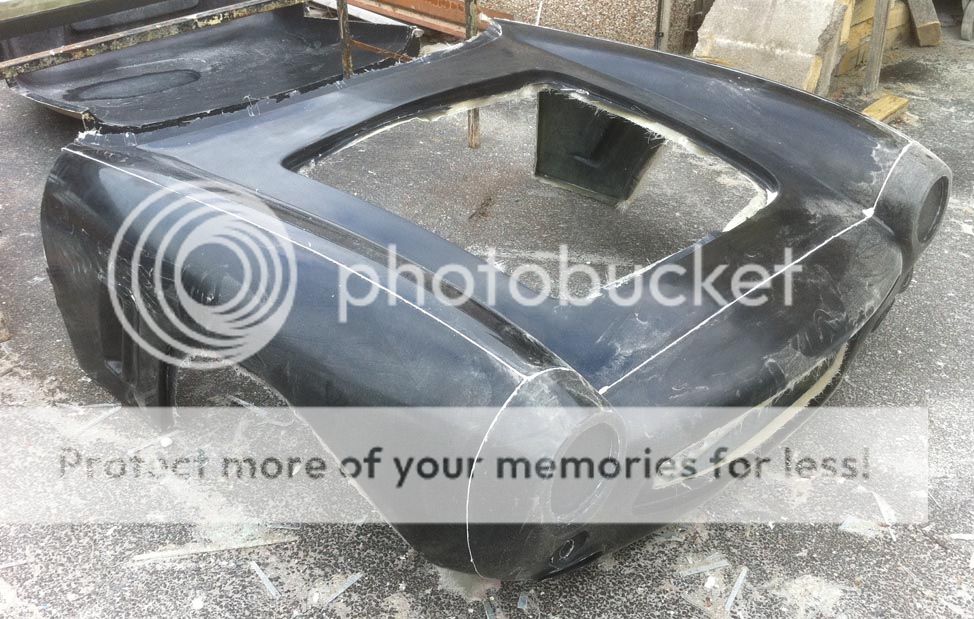

The bonnet looks high quality and I love the black gel coat. Can't wait to see the rest

The reflections on the bootlid show the quality of the moulding. Hope the front end looks as good once it's cleaned up.

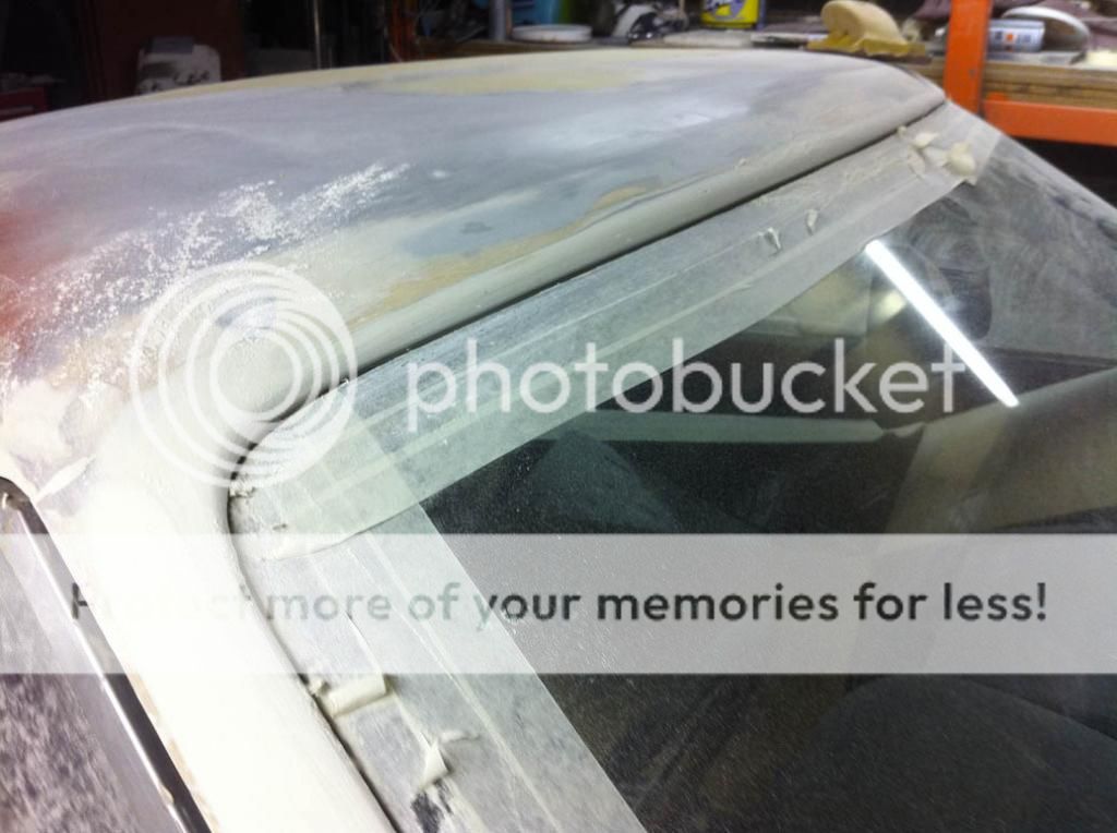

Rear vents now done:
And the roof vent:
We have filled in the channel that takes the Z3 windscreen rubber for two reasons, one to enable the new GRP roof/windscreen pillar covers to have hidden edges when fitted (no external metal to GRP joins as on the MX250) and secondly to visually reduce the size of the Z3 windscreen slightly. With the addition of a false period screen rubber/chrome insert bonded onto the existing glass helping to reduce the glass area even further:
In case the windscreen has to come out,how can you fit a new screen without damaging the roof/pillars?
Does the z3 rubber stays in place or?????
Sorry but i don't understand how the windscreen has to be fitted if the pillar covers and the roof are bonded and painted...............
I am very intersted in this kit but before buying one i like to see some kind of build manual or instructions,for the more expirienced builder it is probably as clear as glass but for a novice kitbuilder as me it is not.
Oh........let me introduce myself,René,57 years young,hotrodder,classis car nut and perhaps a kitcar builder.......
I live in Holland near Amsterdam,work as a pro tig/mig welder but grp/polyester is almost new to me.
Greetz René

20th February 2015, 07:24
Join Date: Nov 2014
Posts: 125
Windscreen cover
Hi Rene;
I have sent you a PM to clarify, but might as well state it here as well;
The windscreen is not covered by the GRP, just the gap that would
normally take the Z3 rubber trim, it will become clearer on Monday when
Chris installs the rear/roof section to Geoff's car. I'm sure Chris will post pics on the forum to explain to everyone.
We are the Benelux supplier of Tributes kits
Rob
