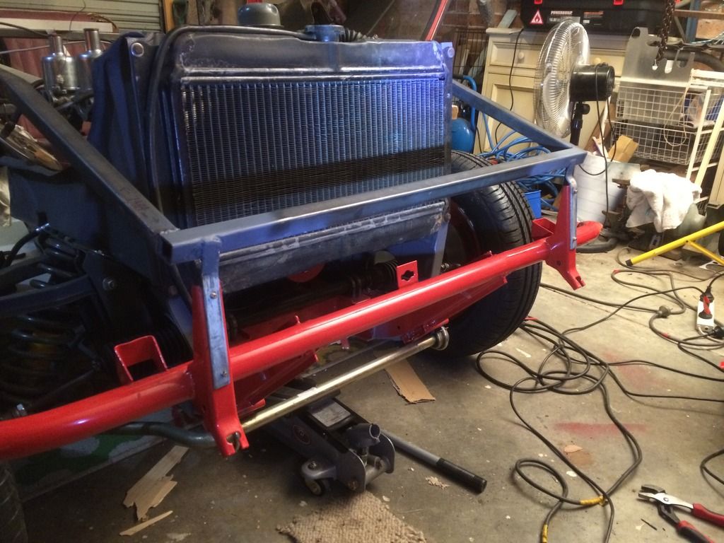

Hi all, bank holiday meant I'm off but steel suppliers are not!
I went to the supplier to buy stuff for the floors. I'd already taken a full size Indiana jones style crayon rubbing of the chassis and drawn out the door and cuts so I knew how much to buy.
Then I got to the steel place to be told minimum order $300. (Aud) not fazed at this point I asked if cutting could be included. Yes. So I asked if they could lazer cut and again yes. So I'm getting floors lazer cut to size for no more than the cost is otherwise be charged for the steel !
Lesson in not stopping the negotiation even when minimum agreements are achieved!
I also tried my hand to welding new front supports on. I used 3mm steel and drilled and tapped holes for the hinge mount points as you can see.
Not bad for a first job but did use 3 rods doing it!

Very tidy, Tim. So the brackets at the front are to put some hinges onto? Are you making them as well.

Thanks Gary no they are just to locate the front of the frame, as my early chassis did not have the mount points the frame was designed for.

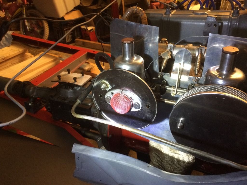

Hi, been a while, still trying to sort out the floors.
So I've been doing more tuning and still misfiring (on new plugs) so a mixture thing. Spoke to a triumph racer last weekend and I'll try no springs in the su2's and no dashpot oil. The mesh is to actually restrict the airflow as with the spit mk 2 induction I'm getting too much air for the little 948.
Then I'll work back up the three steps of increasingly richer needles as I go.
