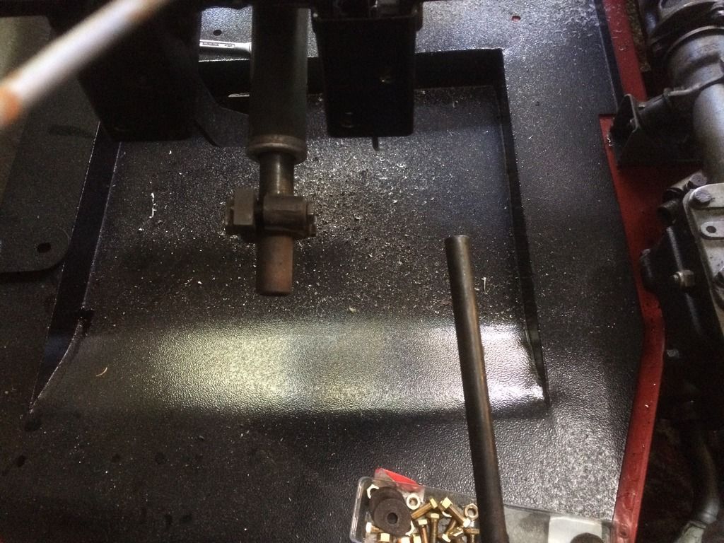

Been a while.
Here's floor done (drivers side) will kick on from here

It looks like you have made a nice job of that floor.
Good luck with the rest of it, Paul.

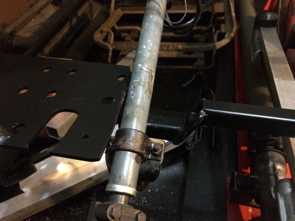

Heard tribute bought miglia - and are working on the frame... Maybe make yours from scratch, guys. Here's my mod to get the steering in an acceptable position.
http://s1332.photobucket.com/user/1i...clolo.jpg.html
I'll need to slim the driver seat a tad too.

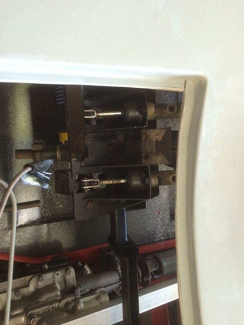

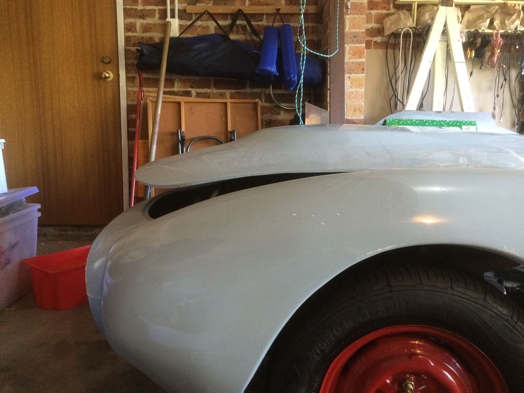

Not really ready for the body but wanted to see it on. Also helps get the wheel position right.
There are a couple of "areas of opportunity" (ie problems)
1. The master cylinders
2. The steering shaft
3. The radiator
[URL=http://s1332.photobucket.com/user/1iTim/media/Mobile%20Uploads/image_zps3n0sq2jj.jpeg.html][/

Tim ...My experiences are purely Sammio , so can advise to a certain extent but not totally ...
The radiator on all Sammio Spyders is moved forward and down , it is lent backwards , two Herald top hoses are joined using a steel tube sleeve to create a longer top hose and , traditionally , I used an after market universal bendy hose from our local accessory store for the borttom one ...fan is removed from the engine and a flat electric fan like these below is fitted to the radiator.
http://www.ebay.co.uk/itm/2722126771...%3AMEBIDX%3AIT
The lower level of radiator means you need to fit an expansion bottle up on your bulkhead with the outlet higher than your thermostat housing ideally ..
Steering and master cylinders on a Sammio were not really tampered with other than relieving an area below the column as it exits the bulkhead to allow the column to drop slightly ...I deliberately kept it stockish and simple on the Sammio's using the bulkhead and all parts there of as much as possible ..
The Miglia rear cockpit and stretched nose styling is more challenging ..
I know that the frame building was never done by Mike himself , hes not really a welder / fabricator ..his area of expertise is body repairs and paint ...he's not really a car builder as such ..he was having the frames made by his transport guy who is a banger racing car builder ...The last few frames I saw were shocking ..I asked Chris for the pedal plate from his Miglia frame he had and one , just one , tap with the hammer and it flew off catching me by surprise !!
The master cylinder issue is probably as simple as move them forward ..but check your legroom and pedal position before you make that permanent ...obvious I know but needed mentioning ...if not , maybe some surgery to the rear of the engine bay with a little hatch to access them ?

Steering ...not sure whats going on but a combination of moving it a bit and some universal u/j's should sort that out ...

Thanks Paul, Lancelot. I added welds to the plate anyway(and an extra triangulation strut). While I'm loathe to move it, shifting it forward (towards the front) would be a good thing for pedal placement but may give even more awkward placement of the cyl caps - right on the bonnet shut line. The steering is the most challenging in terms of supporting all the new uni joined shafts. Radiator can drop a notch on the existing shroud, that should do it with one or two of those fans.

Thumbs up on the triangulation ...Mikes understanding of frame construction didn't involve triangulating or bracing ..there was one sat outside his unit a year or so ago and it was swaying in the wind !!
....what about converting the cylinders to remote reservoirs like the early Beetles and then you can put them anywhere ?
