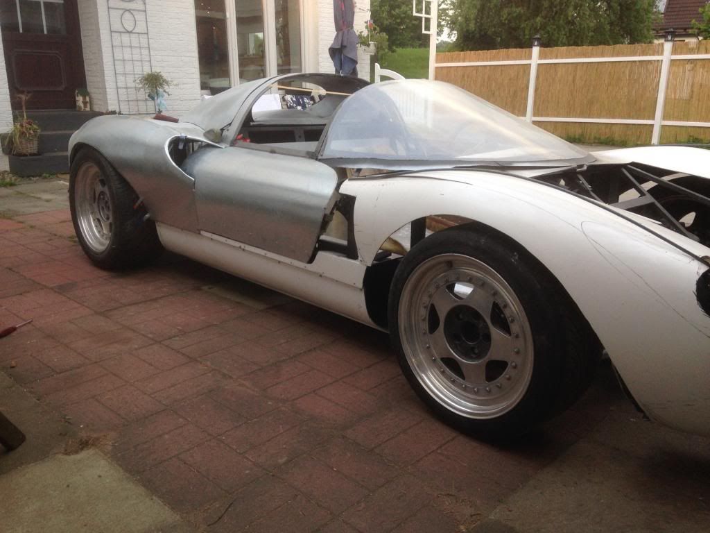

Hi Gary, thanks for asking, my time is more for gardenwork now and my 8 months old son of course, such a cute little boy who makes me happy every day.
But I have some updates:
I managed to do the rear fenders and I was playing around with the airintakes, and I am still not happy with their shape, but I am getting to it.
Here are some pics:
I still have a little bump in the red circle, it needs some shrinking in that area to fix it, and then I need to transfer it to the left side. The intake was to big at my first attempt, and it did touch the cutline of the door, I made it smaller now and its getting better, but judge yourself!

Great work Axel, when your shaping those rear wings do you change the size of the anvil or have you just used the same one?
I can see the scoops take a lot of work, what bit are you not happy with/ is the return lip.
  #74
Old 25th July 2014, 10:34
Axel Axel is offline
Location: Hamburg
Posts: 174
Axel is on a distinguished road
Thanks Gary, the wings were done with the english wheel, no hammering at all. I used the anvil with the most curvature at the beginning, and smoothed it out with lower anvils and used the most straight one at the end. I added the most curvature at the cutout for the wheel, the cutout was smaller at the beginning, and I cut it to tire size at the end after the most wheeling was done with the EW. Then I used the shrinker to bend it more in over the wheel, and smoothed it with the EW again. This process I did several times.
The upper flange was done with the shrinker/stretcher, and wheeled afterwards to smooth it.
Yes, the return lip was a pain in the a....still not smooth enough, the double curvature of the panel at all turned out pretty nice in fact...after some panels went in the bin ;-)
