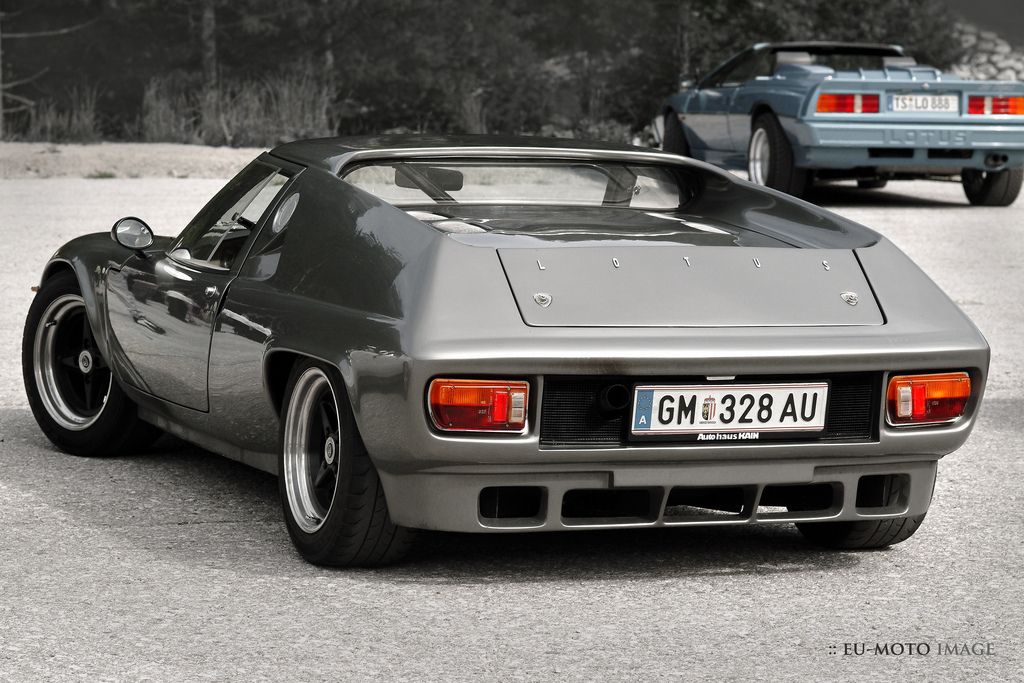

Default Inspiration
A nice inspirational image....
Modified....
