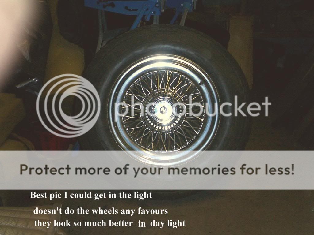

I happen to have some Jaguar chrome wire basket wheels, they are 15 inch bolt on, but have a chrome curly-hub thing that goes on and hides all the bolts, so they look very much like the 72 spoke knock on wires. I had them on my MK!! Jag briefly. They also have four brand new tyres fitted to them.
I will try to get some pictures if you are interested.

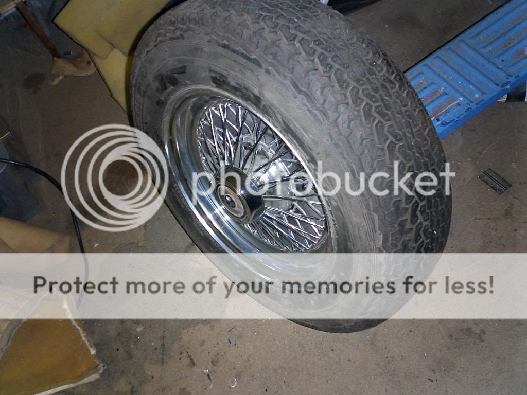

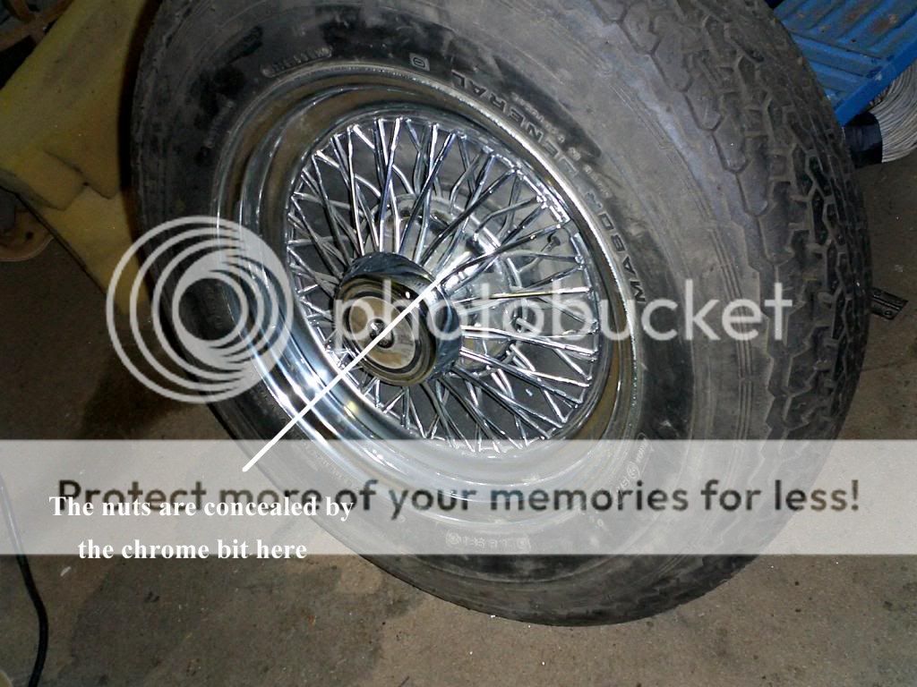

They are steelies with a wire basket, but because of the hidden wheel nuts they look like knock ons, with the curly hub.
The PCD would be the same as MKII Jag, E-Type Jag, Daimler Jag early XJ6, which was (or is) 5 X 4.75inch (120.65mm) with 1/2 inch UNF studs

Default Jaguar wire wheels
[IMG][/IMG]
[IMG][/IMG]
[IMG][/IMG]
[IMG][/IMG]
