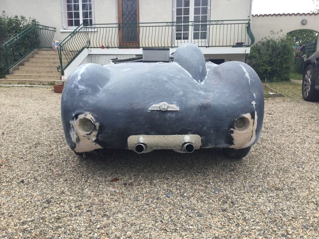

Paul, this is how the exhaust ended up, much happier with this length tail pipe, be aware if you shorten the y piece and pull in the box to reduce length the up turn of the tail pipe increases, this ended up in me rearranging the cut outs in the apron and remodelling the previous work I had done..

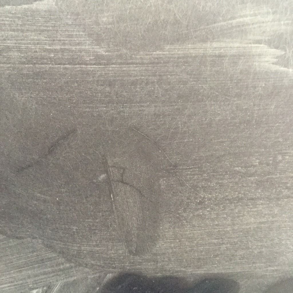

Continued rubbing down today removing brush marks from the gel coat, dissapointingly found stress cracks in the front quarter panel, believe this is where the body wraps tight around the framework, gauged out and filled, unexpected but better to find and fix now than after painting

At last something to update, was not happy with my rear end something was not right so after a long time planning decided to take the plunge and shape the rear apron cutting it back by about 30mm, recut the exhaust again and made up a shield to go around the pipes. Finally decided to move the number plate light previously stuck directly to the body I thought I would try forming a shroud and mount it on this, this altered the angle thinking I will try and find a red lense to fit and make a third brake light in the centre, overall quite happy with the results and feel it's a bit more pleasing to the eye..

Rubbing down all day today paying the price for being over enthusiastic with the orbital sander as the swirl marks are quite deep and a nightmare to remove. Not sure how deep a mark the high build primer will cover but at the moment 600 wet and dry seems to be the answer but weeks of sanding ahead......��
