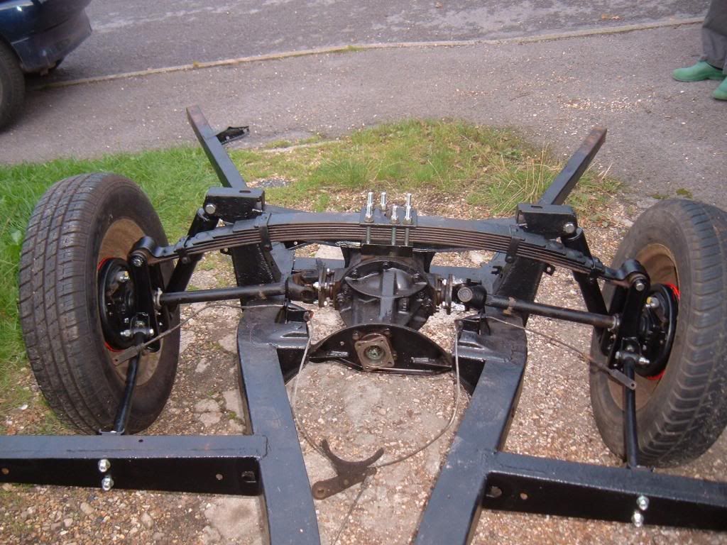

Rear brakes all fitted & back wheels now on again. Turned it round in the carport and ready to attack the front suspension.
Now that I've taken the top four leaves out of the spring the extra long studs seem a bit .... well .... too long. Might clean up the old studs and put them back with new nyloc-nuts.

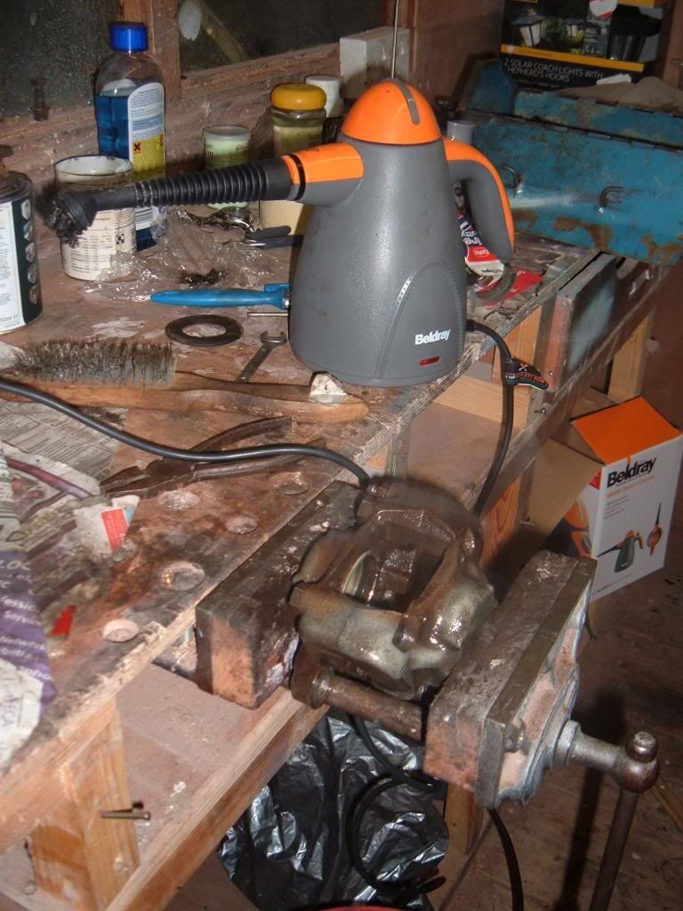

Managed to spend a whole afternoon in the ManCave ... started to strip down the front calipers to put new seals in. Trouble was getting one of the pistons out !! One of them came FAIRLY easily with an airline ... but the other ... well .. it was pretty firm as the saying goes. Trouble was the outer seal was missing and water had got in so it was d*mned near rusted in. With a little persuasion and a fair bit of WD40 I managed to tap it out with a small screwdriver and a little tapping hammer.
I will replace all 4 pistons as one is beyond help whilst the other appears to have a hairline crack ...
Onece the pistons were out I got my fifteen quid steam cleaner out before painting it up with nice red brake caliper paint. Not looking bad if I say so myself.
More pictures to follow soon.
I rolling chassis by spring is still looking possible.
Slarti

Hi Mr T. Thanks for the advice. Another leaf coming out of the transverse spring this week-end as suggested.

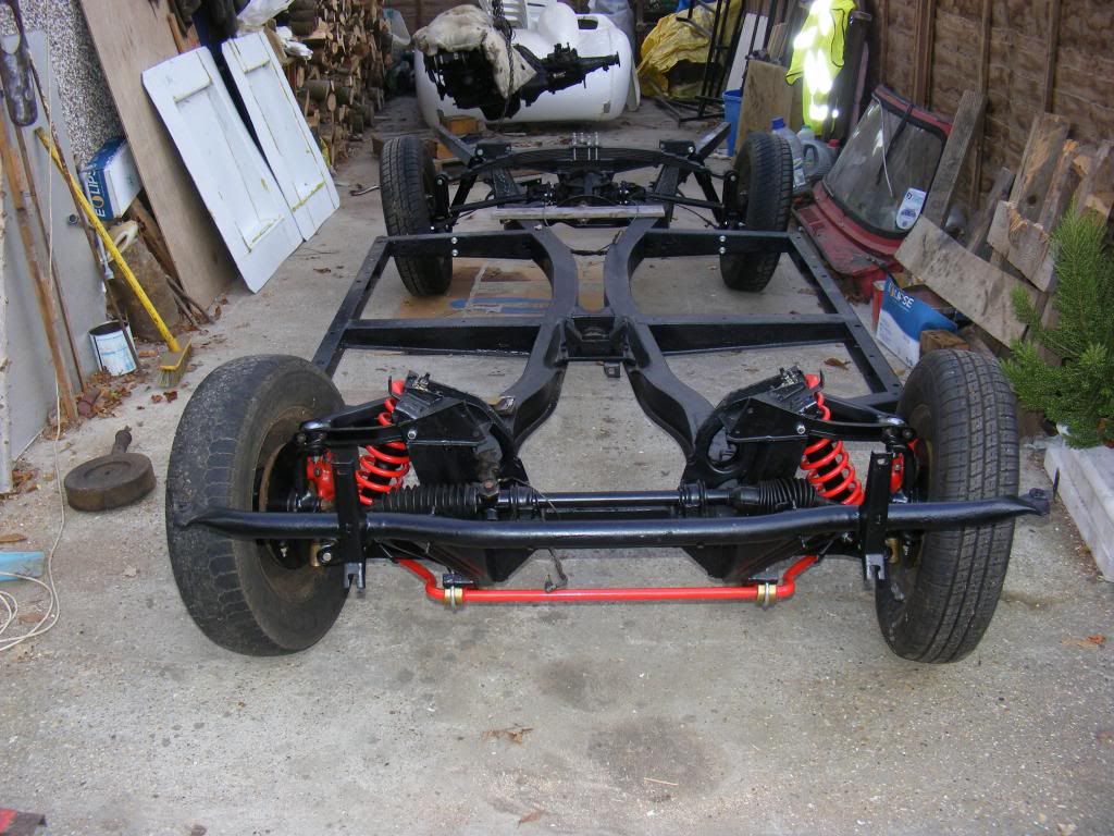

At last ! As far as I'm concerned the chassis is finished New bushes in the axle, new bolts all round; new pistons & seals in the front calipers; new slaves in rear brakes .... etc .etc. A good clear up in Santa's grotto and ready to start on the bulkhead and engine/gearbox. The only thing standing in the way of Sammio progress is my son's Peugeot 206 which need a replacement rear suspension ... Oh well .... onward & upward. Meanwhile a few photos to confirm progress. Happy Christmas to my readers... both of you
ATB
Slarti
  #74
Old 9th December 2013, 05:55
christinedmc christinedmc is offline
Join Date: Mar 2012
Posts: 159
christinedmc is on a distinguished road
Thanks. Happy Christmas to you to!
The chassis looks very nice. I like the red touches. Great platform to work on.
Regards,
  #75
Old 9th December 2013, 08:31
Mister Towed's Avatar
Posts: 5,328
Looking mighty fine Slarti. Keep up the good work.
  #76
Old 9th December 2013, 15:40
Posts: 5,055
+1
Looks like a great platform to build on.
