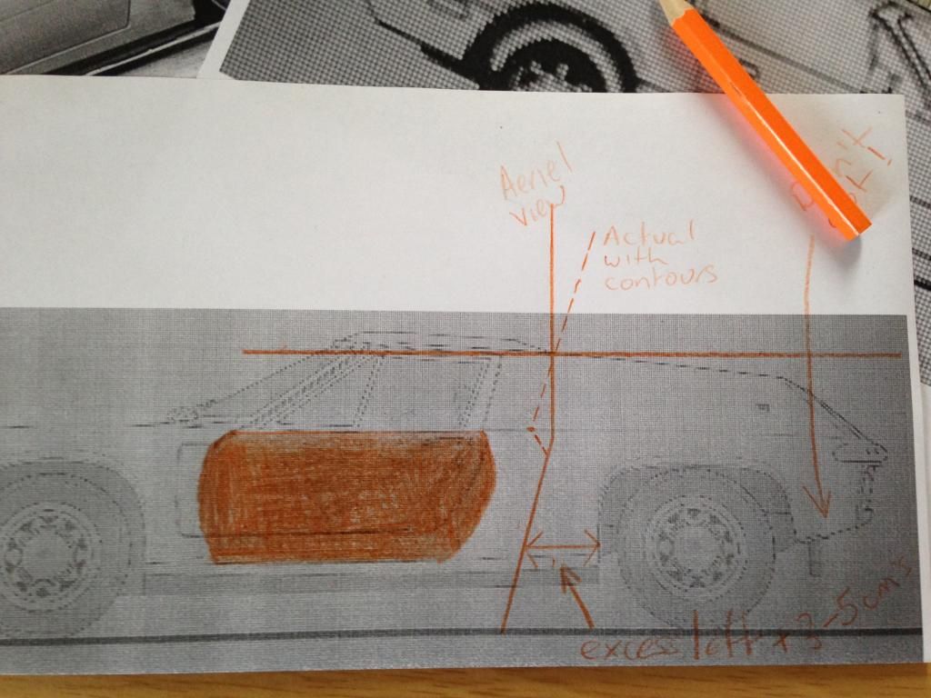

So got some drawings and had a look and naturally with Chris' eye and experience he has a point. I think if I slam the MX it'll get closer...
and if I mix up the 2 PS images it could look pretty cool but by no means a replica. I also think (excuse picture) that its going to very cool but then I would.

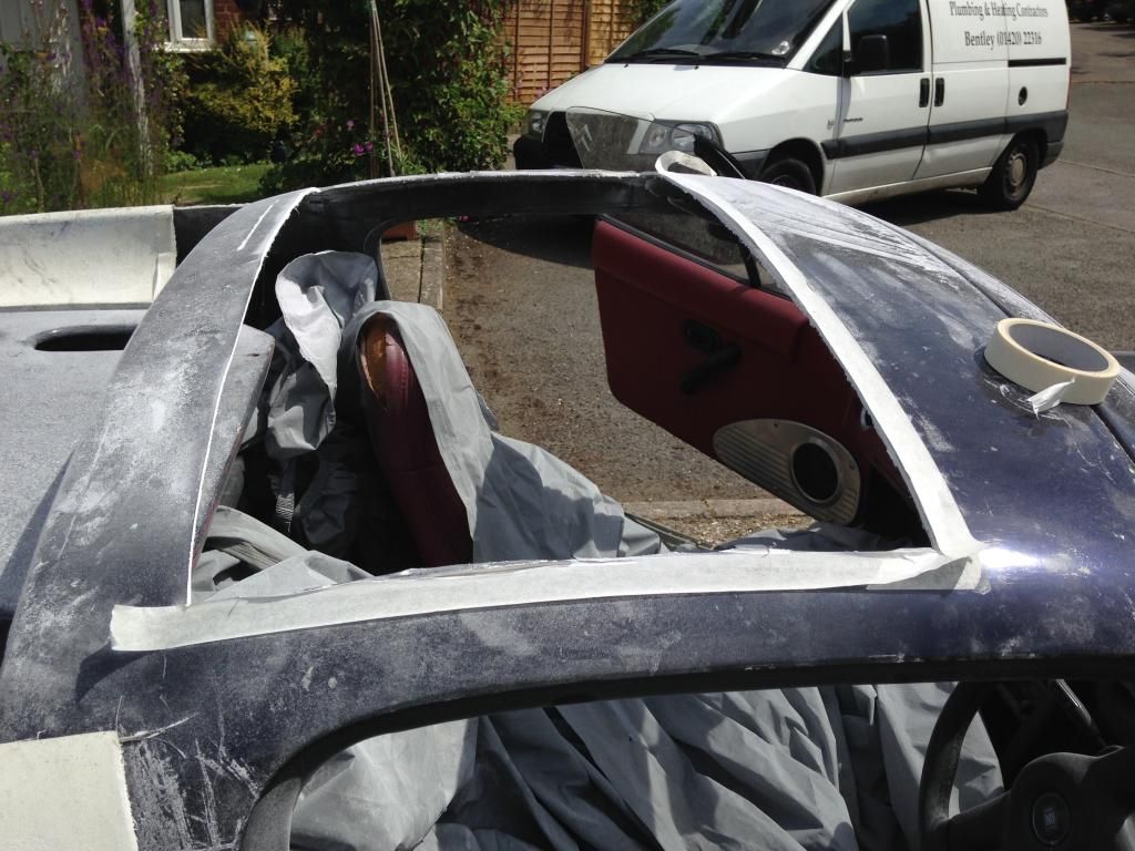

Cut the curved roof so I can graft in the flat lotus profile
