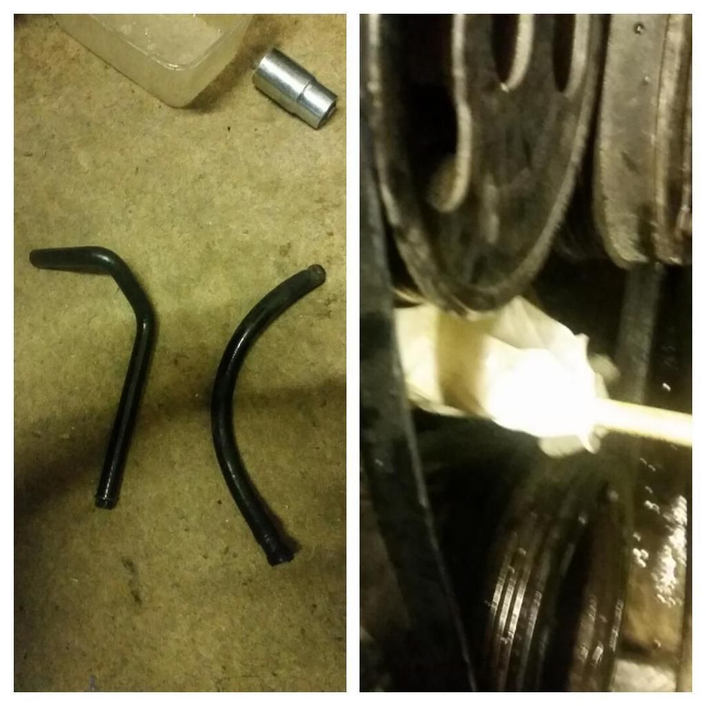

So unfortunately whilst changing the belts there was a hose that didn't look quite right upon further inspection I noticed it also was rubbing against a belt. As I investigated further there was a small 'ting' noise as it popped off and with it the metal pipe it was attached to. Followed by a gushing of fresh coolant across the cramped garage floor! Needless to say some choice language ensued.
Once I had stopped the cars bleeding I was able to look in more detail, some muppet had fudged a repair and rather than replacing the bypass pipe and inlet pipe when it had broken originally they used a thick fuel pipe and forced it onto the remains of the mounting on the unit. It had corroded through. So a week shopping about I have bought the correct new parts and when this unexpected hangover finally subsides I will fix the unit and top again with new coolant. Just annoying that I have to replace the coolant that is only 7 days old! Things brake and on a car that is over 25 years old it's part of the course just wish it had happened when I was replacing the radiator and hoses and thus coolant-less.
No pictures as of yet but if I remember I will take some and retrospectively post some.
Have a good weekend all
Added picture - as you see a bit of difference from the new one on the left and the any bit will do piece on the right. The right picture was my quick bodge of how to plug the leak with anything in arms reach, as you can see a pencil and a latex glove.

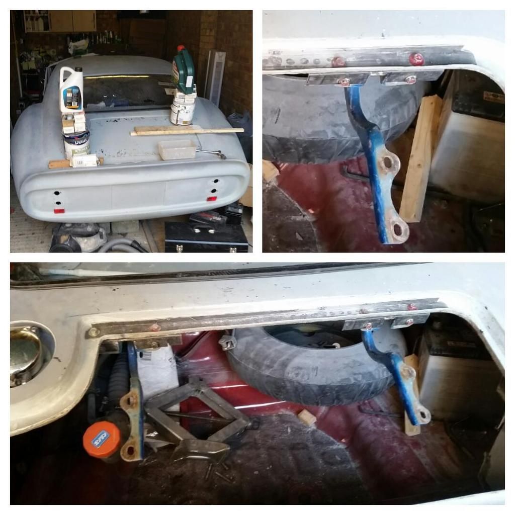

Sooooo firstly ashamedly I have failed yet again to take pictures, my phone and tablet had both died but having spent the morning sorting out the first mow of the lawn this year and servicing the mower I pressed on to the reward... working on the car.
I was determined to get the boot finally sorted and I can say that today I am pleased to say I have completed the task! So very pleased, I have created a KISS solution for the hinges but they are just as a mock up the final ones will be much smarter and welded. I am determined to get this on the road by Stoneleigh and I will tweak everything once it's on the road.
I'll post pictures tomorrow...
Picture added not quite tomorrow as promised but a few weeks later, appears I didn't take many photos. The reason for the ballast is I had bonded the inner skin to the boot lid to give back the subtle curve.
