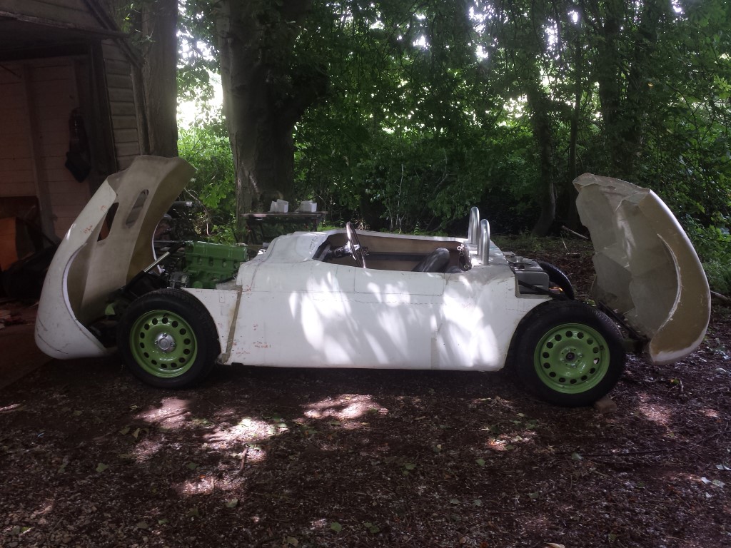

This is Mister Towed's bodywork on the outside:
Underneath he has a cut down Triumph Herald bulkhead, some simple framework and home made floors.
Whereas, Oxford1360 took the same external body work and modified it to do this.

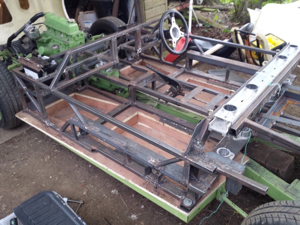

And changed the internal framework completely until it looked like this.

And I have ended up with my own Frankenstein creation of various Triumph Spitfire, Sammio Cordite & home made framework parts underneath.
Hopefully this shows there is no single correct way to approach this, other than make sure it is solid and safe.
Note: In the case of all three cars above, the fibreglass body shell is bonded to the internal framework and not connected to the chassis directly.

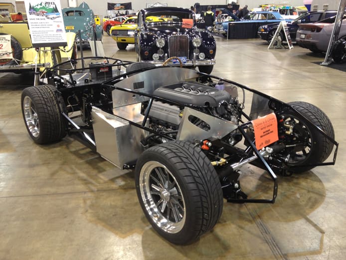

There is an American Cobra replica made by Factory Five Racing that looks like this.
Underneath the fibreglass body work is a purpose made chassis that looks like this.
Although you can get a better idea of what it looks like on this video.
