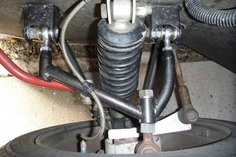

I'd become convinced that the seat-of-your-pants feeling when driving the car was down to the lack of feel in the steering, and that it was just too light. I tried fettling the original top upper wishbones to allow me to set them back a bit and increase castor angle, but because of the design I could only do this by a few mm. Couldn't tell any difference. So after talking to Dave from Track Developments at the Stoneleigh show, I had him make me some new upper arms with track rod ends to allow shimming them further back in the chassis mounts. They included for starters a 10mm set-back in the centre position too. Fitted them centrally at first, and there was definitely some improvement, but then yesterday I shimmed them backwards another 10mm or so before going for a drive. Wow! Massive improvement. The top ball joint position is now about 20mm behind Marlin's original design. I haven't measured the castor yet but by calc I think it should be about 8 degrees. The steering finally has decent weight and self centring. It works as a massive confidence booster as the car just feels much more planted, and is also far less disturbed by uneven road surfaces. On the faster sections of a long drive through the less populated parts of North Wales yesterday I reckon this translated into 15-20mph speed increase for an equivalent "white knuckle factor". Well pleased! And here's a photo of when I reached the seaside.

Sounds a really interesting mod. Any pics of the wishbone in situ?

See below for a photo of the setup. As you can see, it still retains the existing weird-threaded landrover rod end ball joint (Dave had the correct tap thanks to precious Marlin work!) so didn't need to disturb that. Excuse the ghetto shimming with nuts and washers...might fit some better spacers now I'm happy with the position. Or not
I can't find where I wrote down my last settings. I think camber is about 2 deg neg at the front, 0.5 deg rear. 0.5mm total toe in at the front (I ran more before adding the castor, to try and improve stability), maybe 1.5mm rear? I toe in the rears to counteract toe-out under braking. I'd like to add more rear camber but one of drive shafts is slightly too long and I know if I tilt the upright in any more then I risk bottoming out the inner CV joint. Which would be bad. A future project is to mod the rear lower arms to move the bottom ball joint out a few mm.
As for your budget rule.... hmmm. If you include all the rod ends, spacers, lock nuts plus the arms and the castor adjustment assembly it came to about three times that, which I thought was pretty reasonable given they were custom jigged up etc. Dave sourced the rod ends etc basically at cost (McGill's finest - I'll see how they hold up but I didn't want to shell out on Aurora until I saw how they went).

...and sensible fully variable camber adjustment mechanism with provision for wirelocking....all without having to dismantle your front suspension every time you want to adjust!
Impressive.
