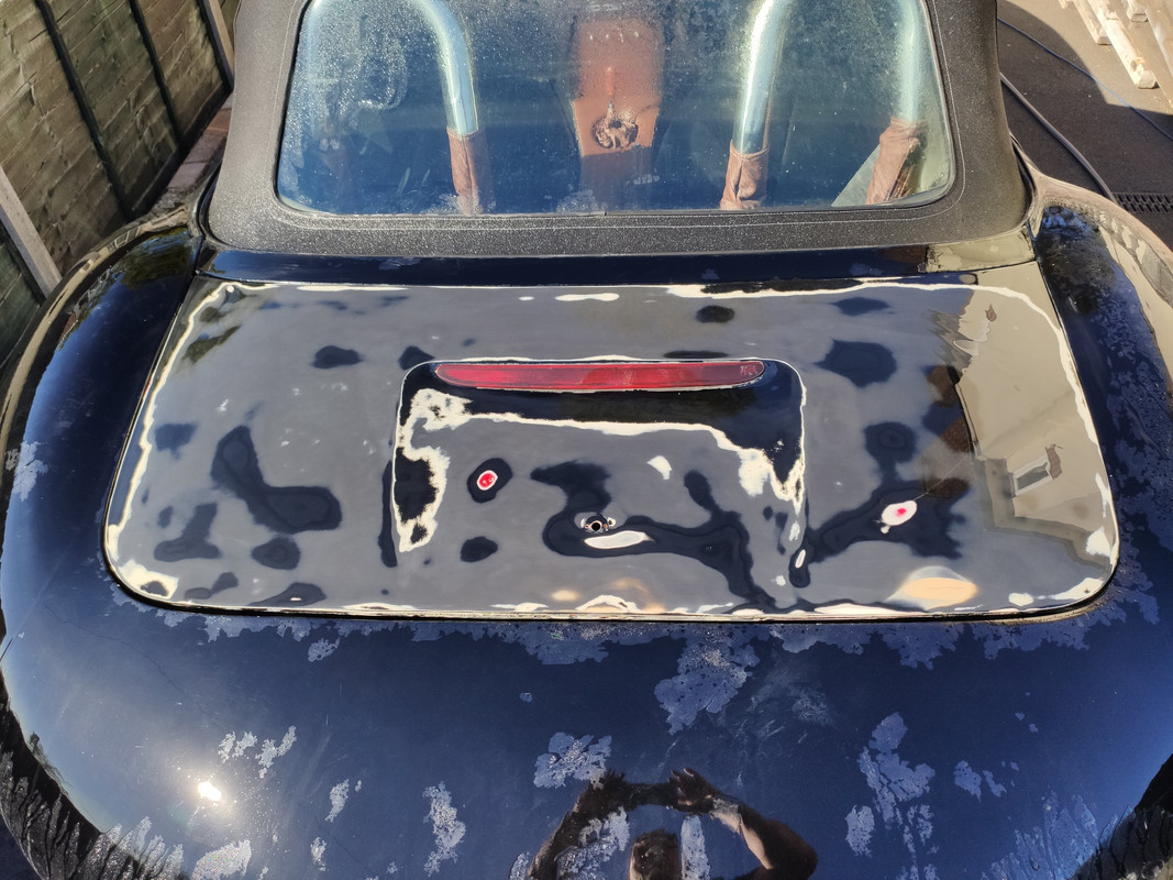

About a year or so ago I noticed that there were pimples developing around the back end of the car. This was happening both on the glass fibre rear panel and the metal boot. It almost looks like a paint reaction but waiting five years to react seems a little slow.
I thought it might be some kind of environmental build up mixed in with the car wax or similar so used the excuse of lock down to really blast the boot lid with the power washer as clay bar didn’t touch the bubbles. Let’s say it didn’t quite go to plan.
This was the metal boot panel but the pimples are on the glass fibre rear wings too. The car lives outside and is used in all conditions. Any ideas what has caused them and how I can prevent them returning?
As a bonus I might post pictures of me trying to respray it with rattle cans out on the driveway if I can find some black paint.

Most annoying to say the least. I have seen this happen before when a car is kept outside under a dust cover usually with glass fibre panels. In hot sunlight it cooks the paint and up pop the bubbles. Some people have made a simple wooden “box” cover on wheels, to roll over their car. That allows air to circulate around whilst still keeping the elements at bay. Peter.

Micro blisters in the primer is the expert opinion
Lucky - just beginning to wish I had listened to you

I had a good look around the car and the only places the micro-bubbles really show are across the boot lid which I have sanded back and on the top of the rear wings as shown in the red oval areas
I gave one patch a quick rub with some 1000 grit to see what would happen and it appears that I could sand it flat without cutting right through the paint which would save time and sanding.
If I did this:
A) Would the micro-blisters reappear as soon as the sunshine heats them up gain
B) Would I need to use primer or could I go straight to black paint?
Please remember that this is just an every day driver, not a show car, although I do like showing it off. Also, I will be painting this with Halfords rattle can paint on my driveway outside to set the expectations in case this affects your answers
